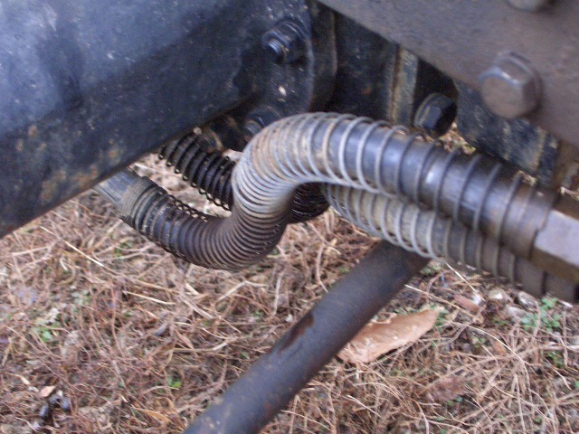

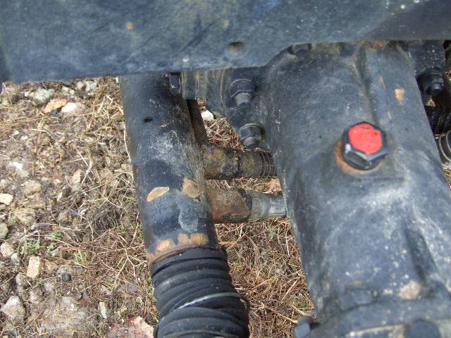

Can anyone tell me what size the power steering hoses are? The threaded fitting, I need to get 2x 45 degree fittings to reroute the hoses to go over the front axle, instead of under. Since going under allows them to be pinched by the steering linkage. I'm not positive this can be done but am willing to give it a try. Has anyone else had a similar problem?. Or any suggustions on fixing this situation..

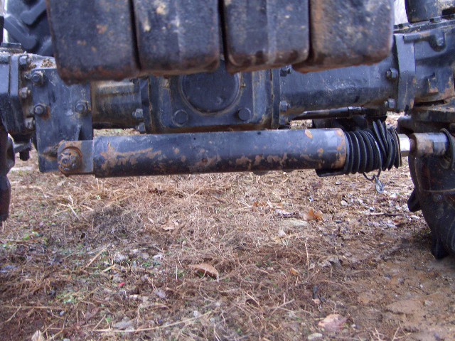

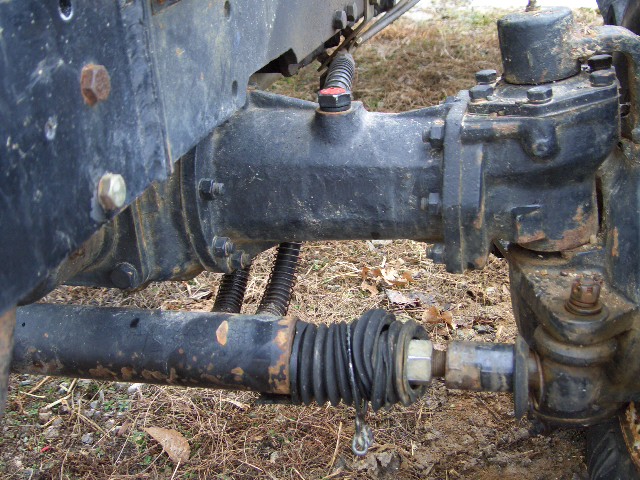

OK gonna try to load some photos.. And yes I have a new boot for the steering cylinder ( a pretty BLUE one). I know I'll have to get new hoses (longer). So I guess it'll be best to just remove 1 and see if the local hose makers can fix me up, maybe they can put the angled fitting on the new hose. Will post an update when I get the chance to get new hoses made..

As Greg stated your cylinder is in wrong. Loosen the cylinder and rotate it so the fitting are upright. Contact Ronald at Ranch Hand Supply to get the new hoses. Trying to run all over town is a loosing battle for metric stuff. Ronald can custom make hoses now to any length I think. He will have them in your hands by the weekend if you call him today.

By the way it looks as if your jamb nut is loose on the wheel side of the steering cylinder. Looks like its time to give that hard working girls some TLC!
Also relocate them hard lines going to the steering hoses. They need to come up so they do not get damaged from hanging low. It may take some slight bending so be careful.

Here are pictures of my 284.
My suggestions:
1. Turn the cylinder as suggested. This will put the fittings facing the front of the tractor rather than the rear. It doesn稚 look like there is enough clearance if you leave them facing the way they are.
2. Install 90 degree fittings.
3. It appears that you will need to then install longer hoses over the axle cause there doesn稚 look to be enough slack in the existing ones to reach.
4. Move the axle fill dipstick to the right side so that you won稚 have to fight the hoses when you want to check the oil level.

If you owned one of these yourself, you'd probably have a better feel for what's going on here. The steering cylinder is anchored on a post type bracket. It can only be mounted two ways. Depending upon where the holes are tapped into the cylinder, that's either (a) facing front or rear, or (b) up or down. The OP photos show his currently facing rearward. Rotating the cylinder on it's anchor would obviously then place those hole facing forward. 90 degree elbow fittings (or 2x45) would then facilitate running the hoses up and over the front axle housing.
