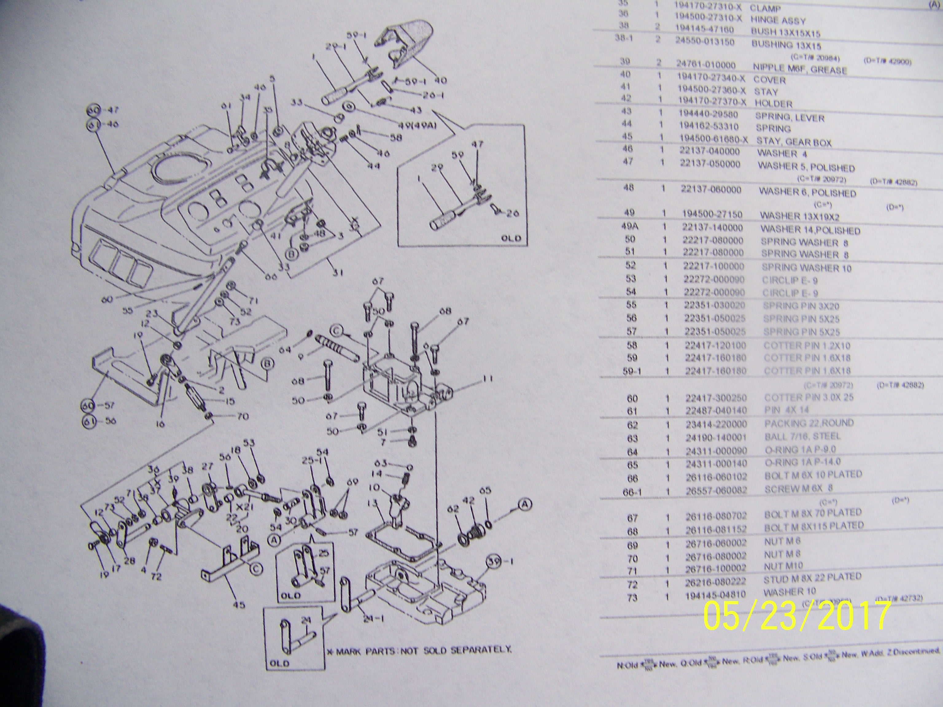

The 186 came with a column shift and floor shift, which do you have?
   / Power shift stuck in 2 #4
Not sure what you can see with the top cover removed. Can you see the shift fork to tell if it is ok and able to slide?
   / Power shift stuck in 2 #5
Is there even a shift fork in PS? I assumed it was like an A/T where the shift lever moves pistons to open/close various paths for hydraulic fluid. To engage/disengage clutch packs.
So repairing the linkage somewhere before those pistons seems to be the next step.
Has anybody torn into a PowerShift?
And I assume the problem here is in the PowerShift portion of the transmission. The range selector part would be a normal geared transmission with forks etc.
   / Power shift stuck in 2 #6
A picture of it.

   / Power shift stuck in 2 #7
Kinda tough following the diagram. Lot of linkage going on there. Hope it's in linkage for you. Easyier and cheaper.
