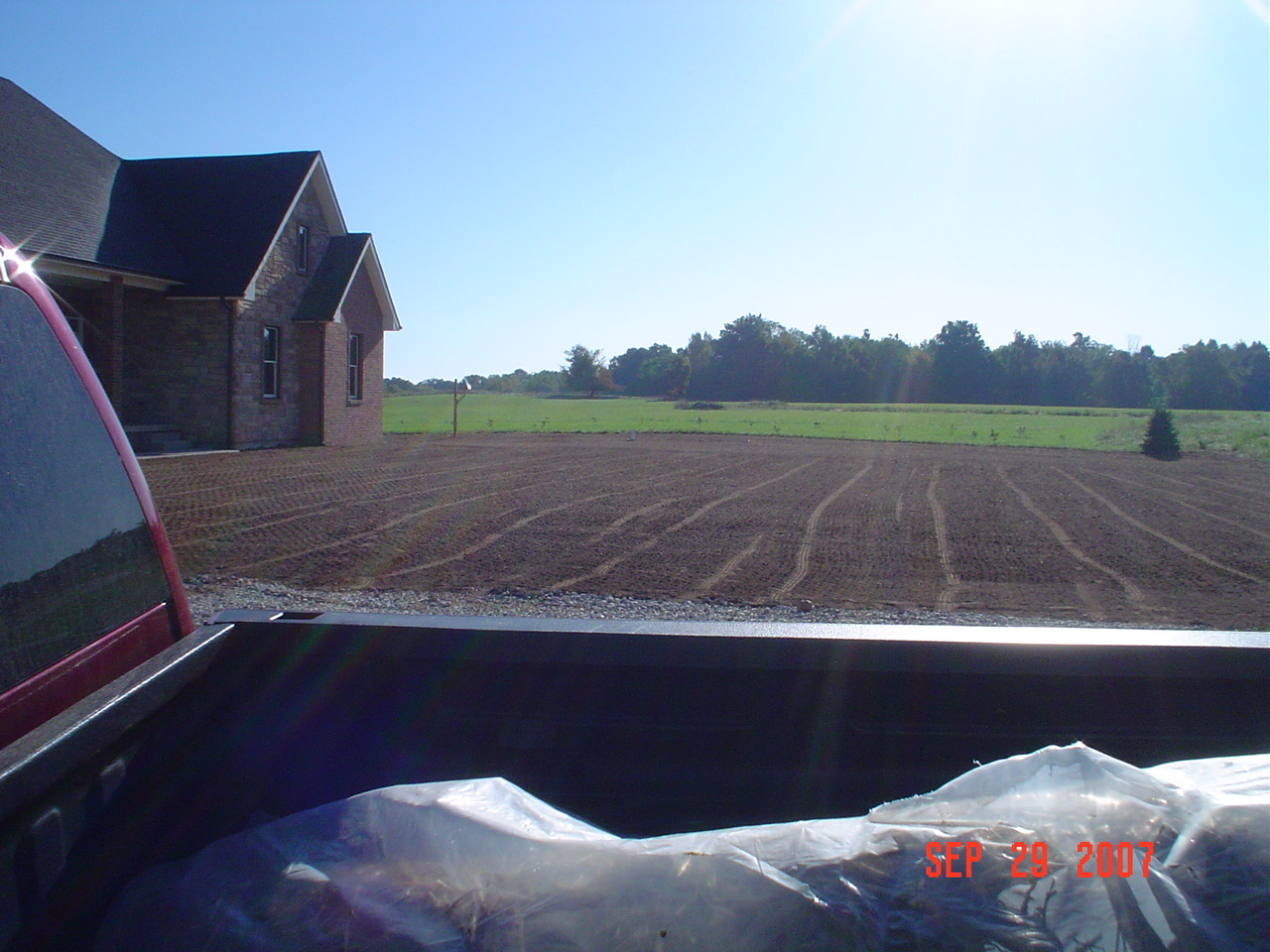

A power rake will do an awesome job...make the area perfectly level, windrow any rocks, and leave the perfect seed bed fast. Is this the only tool....no. It is used by professional landscapers that need to get in and get out. if you use a york rake be sure it has gauge wheels. This will help fill the low spots and level out the area. Try not to go over the new soil too much, otherwise the soil will compact and it will become more difficult to spread. I've never used the gill pulverizer, but I think that would work good as well. For your interest here is a pic after I used a power rake...wish I would have gotten a before pic...

Pic looks nice, how was it before?
