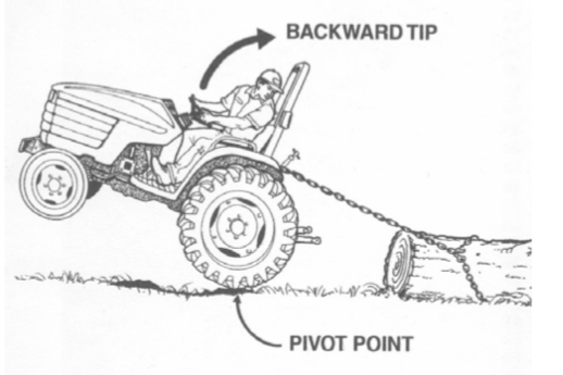

I would guess you could get away with the rake. Just use some caution and buckle up.
An alternate could be a chain harrow. Mine collects all kinds of stuff but you have to get off and empty it if not mounted to a 3-point rack. They aren't that expensive and could be pulled from the drawbar to avoid any chance of tipping as they should be less inclined to catch something and not let go.
