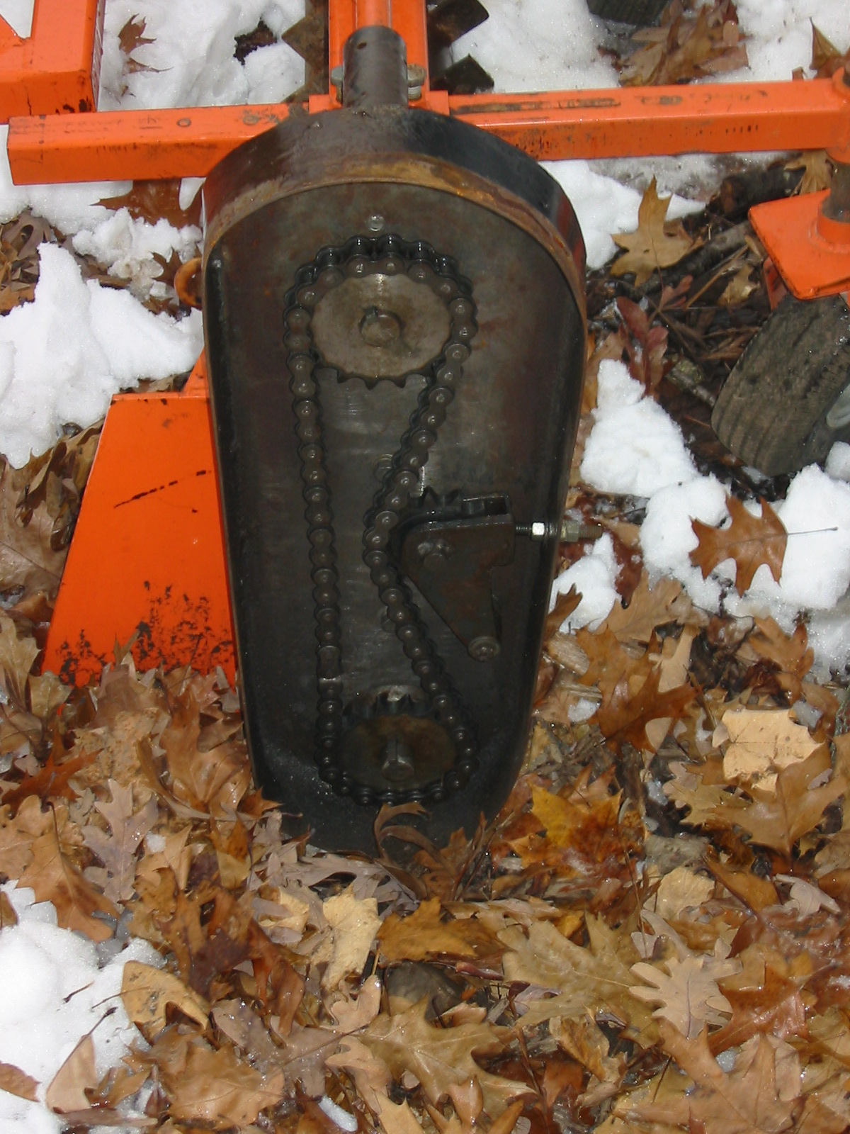

Can you post a picture of the chain assembly? Why did you switch to flatbars on the roller from the roundbars? Thank you.

Here's a picture of the chain assembly. I used #60 chain, i also made a idler sprocket to keep tension on the chain. The gear box is 1:1 ratio and is from surpluscenter.
Joe

Thanks Joe:
I saw most of the pieces I need there. I will try and make a tensioner also. Cheers
