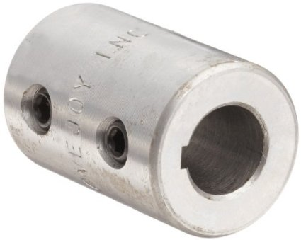

If you have the room, I'd use shaft collars instead of spacers to stabilize the shaft. Easy to install and not very expensive.
I think I looked into those and for the size I needed they were getting expensive. I needed something like an 1" thick on one side and about 1.5" on the other.
I ended up buying this 4" sleeve and chopped it up in the bandsaw. Worked pretty well and was cheap too ($12).
EDIT: Whoa, I guess I got a steal on this boy. It now lists for $54 :eek:
Lovejoy SC1250 Rigid Sleeve Coupling Coupling, 1 1/4" Bore, 1/4" x 1/8" Keyway with Setscrew, 2.25" Outer Diameter, 4.00 Overall Length: Amazon.com: Industrial & Scientific
