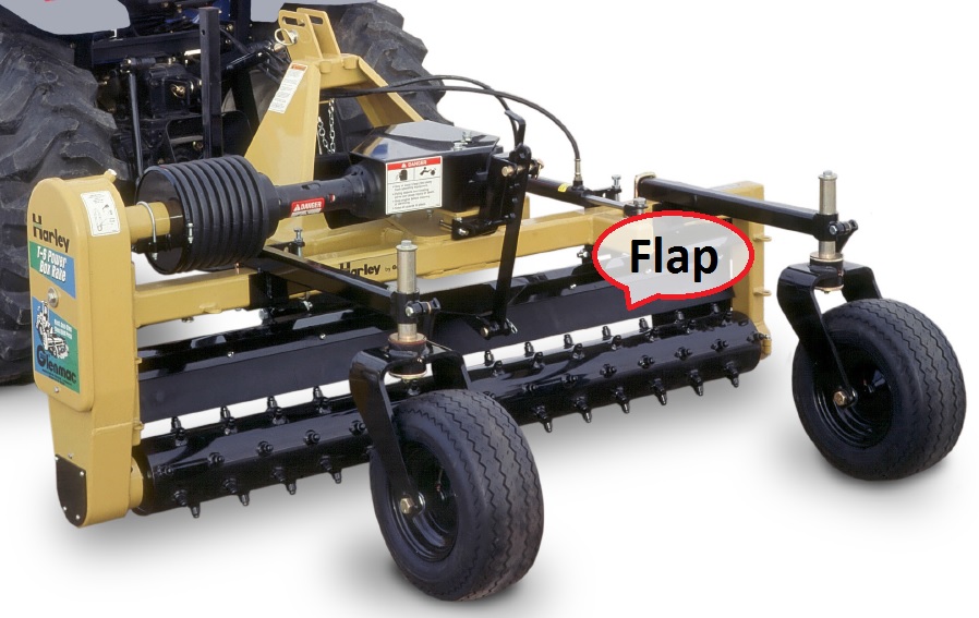

Nice looking rake!
In addition to side plates, you also need a rubber flap at the top of the roller. This keeps clumps of grass, clay and rocks from just getting thrown over the top. Keeping the clumps in front of the rake helps break them up and the rocks get collected. I swiped a picture from the front of the manual so I did not have to crawl around the barn to take pictures. The height of the flap is quick-adjustable using lever on the back of the rake but I mostly keep mine all the way down (just clearing the teeth). I raise it all the way for spreading and leveling wood chips.
For finish leveling, float in the top link helps immensely. Note the slotted hole for the top link. There is a fixed hole as well. Use the fixed hole for initial grading and pulverizing. For finishing grading, if you adjust your top link so that it is centered in the slot when the rake is at the grading height you want (typically with the teeth just engaging the soil), the gauge wheels follow the finish grade and adjust the rake independent of the tractor.

Thanks Stone,
The flap was part of the original design but never got around to it.
Thanks for the info on the top link slot. I wasn't really sure if I needed it but left a spot to add it later.
More things to do I guess. :yes:

I didn't even notice the missing flap on top. That and the sides are necessary for processing material... I run my flap almost all the way down all the time, never have had to move it. That way only the smallest stuff gets through. :)
Both are easy mods but worth it!
