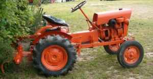

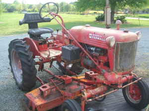

Thanks for the welcome and reply Wayne. Here are pictures of both. Again, they are around the same price and both owners report no major issues, no smoke...

One of the tractors I currently own is a Power King economy but looks like mine is a bit newer. The serial number will tell you the year (internet search) and parts are still available although you'll have to do some searching. Mine has the double transmission (tandem). As long as it starts reasonably well and doesn't smoke for more than a minute or two you'll be fine. I've used mine to mow 25ac (took about a week at about 4 hours/day). One thing about the PK's is all parts are generic so you won't have to look for brand specific. I've only had two problems with mine. I had a front spindle break (I've got a FEL) and currently I need to diagnose a differencial problem. I've also abused mine considerably by asking it to do more than what's it's rated (by adding about 2 to 3 hundred pounds of rear ballast so I can pick up heavier items with FEL). Still all in all a good little machine.

the cub would be a better tractor for gardening just because it a offset and has higher ground clearance
the pk is harder to get hard parts for such as drive train but u can get engine parts for it at any lawn mower shop cause they had kolher 12, 14, and 16 hp motors on them
and u still can get everypart for the cub from a local case dealer and there is many after market parts for it also

I tend to think of the PK as an antique lawnmower.. the cub is what I'd consider an antique scut. IE.. 10hp job or so.. larger rear tires may give it a bit more traction.. etc.

The cub does not have hydraulics. The cub and two pks have mowers and attachments.

I second this. The Cub is MUCH closer to a tracter where the PK is more like a lawn mower.

Are you sure the Cub does not have hydraulics? I see the rod to operate the rear rockshaft but no hand lever to operate it. That indicates it does have hydraulics. The front rockshaft would be near the current battery location and would be attached to the lift chains for the mower deck. The operating lever is next to the throttle.

I also think that Cub has hydraulics, another plus for the Cub.
