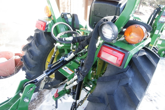

/ Power Beyond Kit for 790? #26
I'm looking to hook a log splitter to my 790. I do not need to be using the loader when I am using the splitter, is there not a way to bypass the control valve for the loader (put a "T" in it with a valve to shut off fluid going to the loader) and have this go directly to my splitter?
If I purchase the auxiliary valve setup, what is the realistic cost of that. I have hoses from my splitter, may need some adapters and such.
Thanks
/ Power Beyond Kit for 790? #27
The simpliest way is the Power Beyond kit. Anything you connect to the loader lines won't have flow unless the loader valve is actuated. I think my 3 spool valve was between $100 and $200.
/ Power Beyond Kit for 790? #28
Thanks
Welcome to TBN:D
If all you want is to run a logsplitter, then you need the PowerBeyond kit for your tractor. It will cost about $250 from JD, and you could install it yourself in a couple hours.
