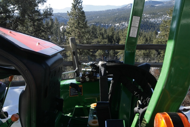

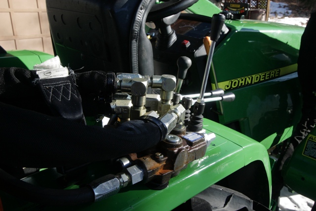

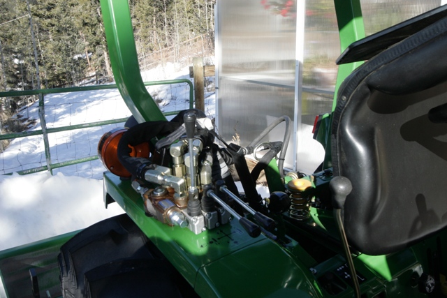

I will try to get some pictures as soon as I can. Meanwhile a few things I learned from this project. I knew nothing about hydraulics before I started this but got a lot of information searching and asking questions on TBN.

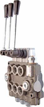

Get a valve that has a capacity that exceeds the GPM that your tractor is rated for. The hydraulics flow in series so anything below your gpm will restrict the total flow. Tractordata has your tractor rated at 12.9 gpm, my 790 is rated at 5.6 gpm (I have some serious hydraulic envy).
The valve of course needs to fit where you want to put it and you want to get enough spools to cover whatever you might want to do in the future. I got the valve, see picture, because it fit and had enough flow to not hinder the 790s already anemic (although always been more than adequate for me) hydraulics. I got it from Hydraulicstore.com, Bucher Manual Monoblock Directional Control Valve. I did not get float on any spool. This might be a bit small for you. They have a 17 GPM model.
I especially like this valve because it is small, relatively inexpensive and because the handles can mount vertical or horizontal so I have my angle mounted vertical and the two TnT handles mounted horizontal so I do not grab the wrong one.
I bought the angle kit for my frontier FEL blade which has two single acting cylinders (I have seen some hydraulic angles with one double acting cylinder) and I then bought the TnT cylinders from CCMachinery.com and lots of fittings and hoses along with field attachable hose ends to build the hoses to the exact lengths I needed.
Materials:
  • Valve
  • Cylinder(s)
  • Hoses and connector ends
  • Fittings to swivel and convert between all the different fittings
  • Tie wraps
  • Washers, nuts, and bolts to mount the valve
  • Quick disconnects (optional) (Since I take my blade on and off and I wanted to allow the option of taking the FEL off, I have Quick Disconnects at the front of the loader and where the FEL hydraulics disconnect)
  • Nylon sleeve material (optional)
  • Materials to build attachments for the quick disconnects (optional)
Connections:
  • Power beyond ports to in and out on valve
  • Blade Angle:
    [*]One side of one spool to one single acting cylinder
    [*]The other side of the same spool to the other single acting cylinder​
  • TnT:
    [*]Each side of one spool to two connectors on the top double acting cylinder
    [*]Each side of the other spool to two connectors on the tilt double acting cylinder
The biggest problems I had where were where to run all the hoses (It is pretty tight on a 790) and getting all of the correct fittings to adapt between the cylinders and valve ports and of course paying for all of this because it is not cheap.

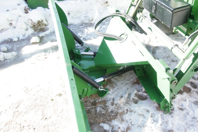

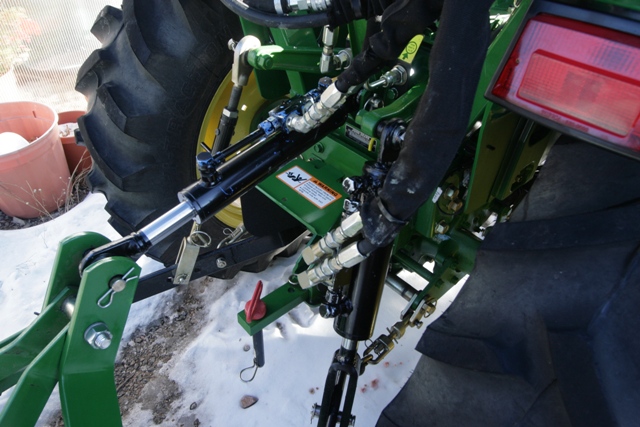

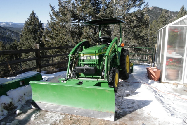

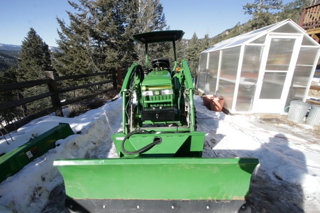

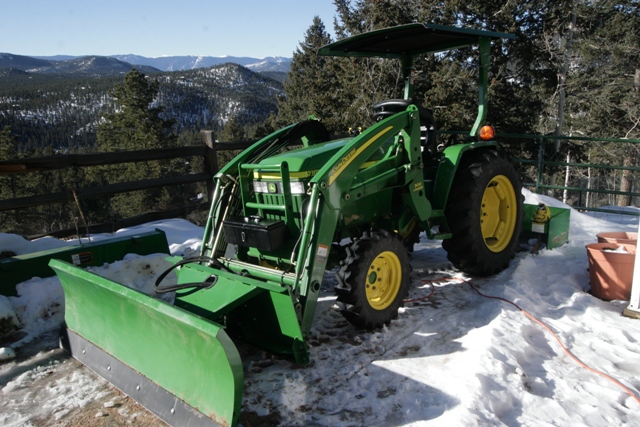

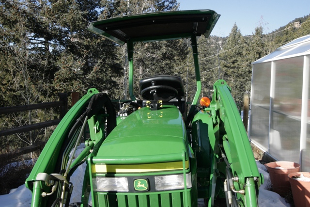

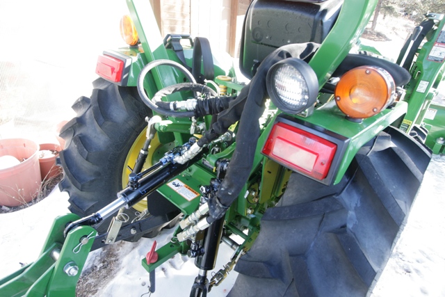

Not sure how much they will help you but I've included a bunch of pictures. My next project is putting lights on the top of the canopy. I'm also planning to shorted the hoses going from the Power Beyone to the valve when I get some time. Don't know what I will do with my weekends when I run out of projects for the tractor.
/ Power Beyond Kit for 790? #9
Well that didn't work. I attached about 15 pictues and none of them made it. I will try a few at a time. These are of the Angle Kit.
/ Power Beyond Kit for 790? #10
These are of the valve.

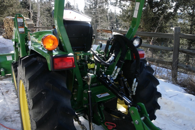

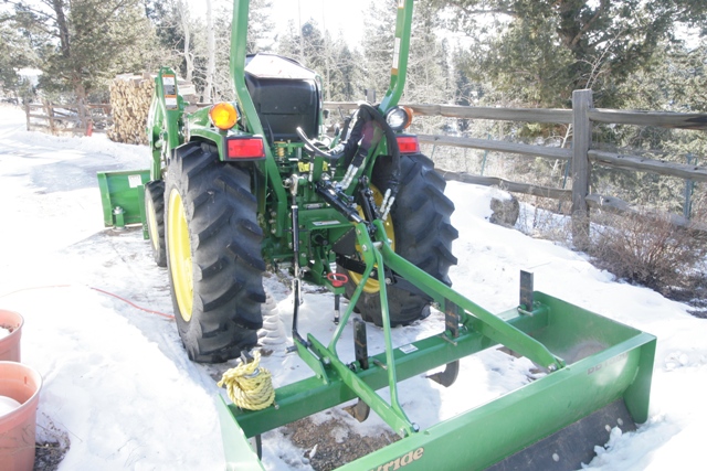

/ Power Beyond Kit for 790? #11
These are of the TnT.
/ Power Beyond Kit for 790? #12
And just a few tractor shots.
