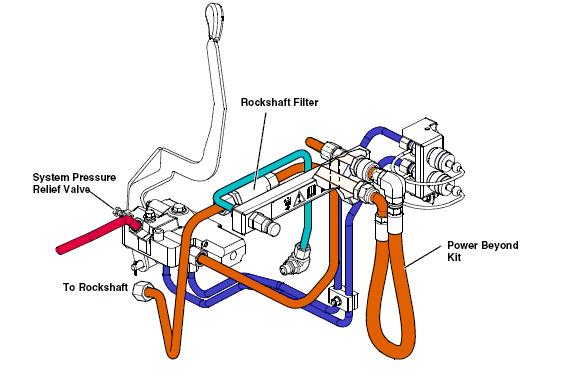

I can say that when I ordered my 3320 with 448 and PB, that the dealer installed the PB. My tractor did not come off the lot, but was ordered from the factory as configured. A couple of the options were dealer installed. I think the PB was always intended to be a dealer installed item, although in my case it was on backorder so I guess I can't say for sure. I got the tractor first and when the PB later came in, they picked up the tractor from me and installed it at the shop. They didn't charge me anything for the install. I have the installation manual for the PB that came with the 448. If you want to see it, let me know. Also, when the dealer finally got the PB, it came with one wrong part (one of the solid hydraulic lines). They'd never seen that happen before, but got the right part quickly and finished the install. I remember them saying it took several hours to install and although they removed the rear tires to swap them for added width, I believe they would have taken them off anyway for access. Mine happens to have loaded tires so I was happy they did the install. Otherwise, I might have enjoyed doing it myself. I also use the PB for a 3PH log splitter. This works very well for me. When an attachment is connected to the PB, the rock shaft arms don't lift. They stay put at the last setting or can be lowered. The FEL is completely unaffected by PB.

Thanks for that helpful post and information. I was reviewing the backhoe manual today. I was wondering if it might have some kind of warning about using the BH without the PB. It didn't. It does, however, include as part of the instructions "install Power Beyond." One warning that it does have is to not leave the hyrdraulics in "relief" position for more than 10 seconds straight. I belief this is what's basically happening when I've got my wing nut holding the valve open but I'm not operating any aspect of the backhoe.
I've made up my mind to get the PB. I just hope I can get the dealer to install it without charging me an arm and a leg.

Below is the response from JD. It's clear that the PB is the only way to go:
>Per the factory, you should have the power beyond kit installed on his
>tractor for proper operation of the backhoe. Unlike the 3rd SCV, the
>power beyond provides a continuous flow of hydraulic oil and a pressure
>free return of the hydraulic oil to the reservoir which creates the
>least amount of heat in the transmission/hydraulic system. Using the
>3rd SCV to power the backhoe can potentially overheat the hydraulic
>system and cause damage to the transmission since they have a common
>reservoir. Please consult with your dealer for resolution.
That's pretty much the same information I got on this list. Good work guys!
