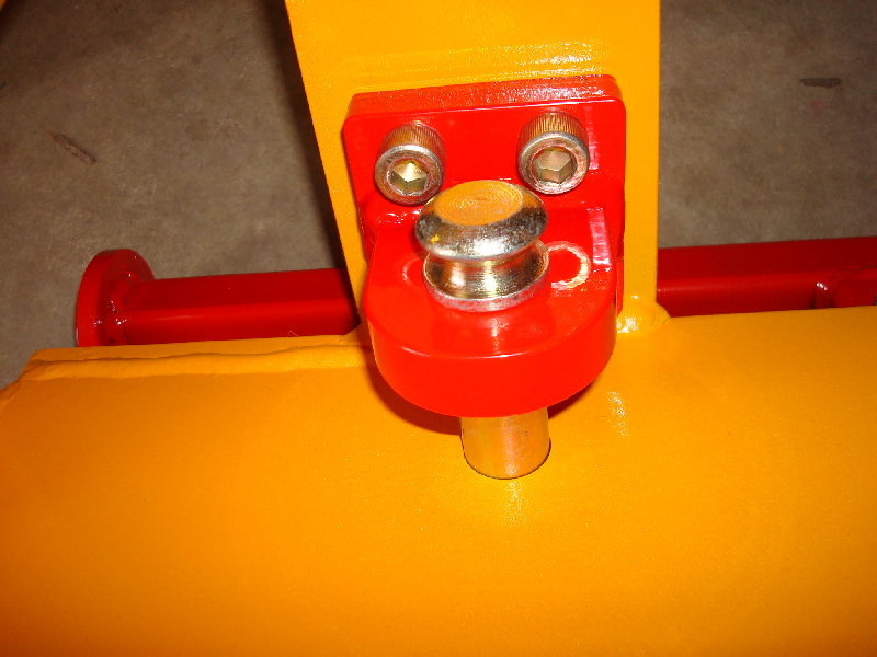

Just for kicks here is my plumbing truck with powdercoated frame. The whole black frame portion including top racks, front baskets, floor, frame and lift gate with hydraulics removed was baked in one piece. Everything that is black in other words and this was done in 2003. Sure has been better than paint with almost zero maintenance. Took a kingsize oven for this project. Worked well inough compared to painting that I then powdercoated my other two red service trucks, while they have signs of wear after 7 years it has been more durable than paint by a large margin.

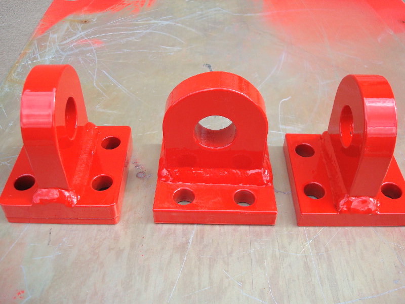

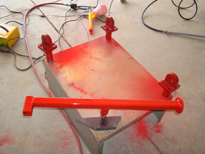

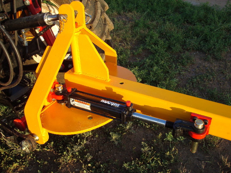

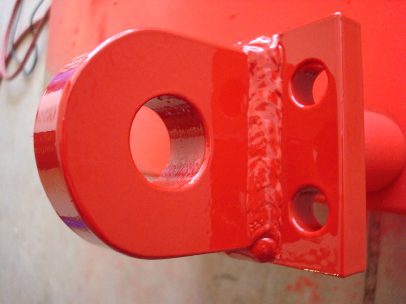

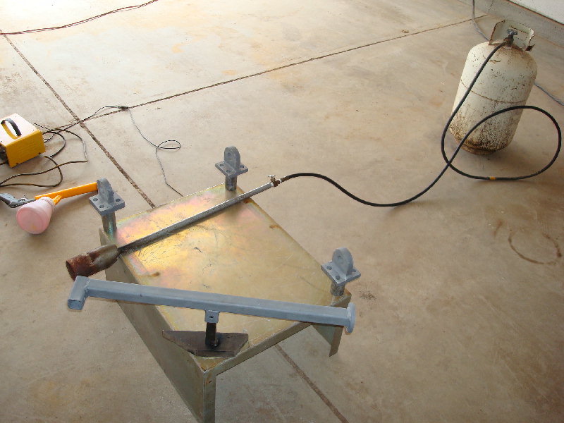

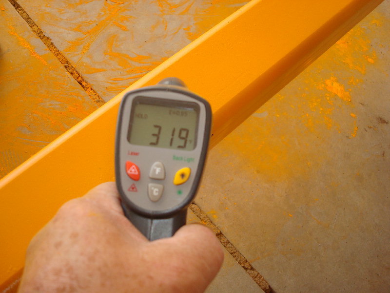

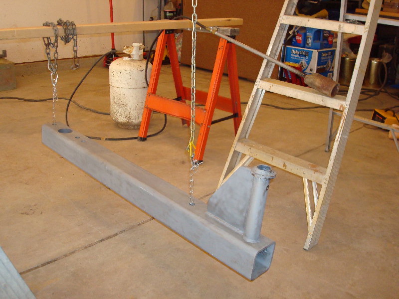

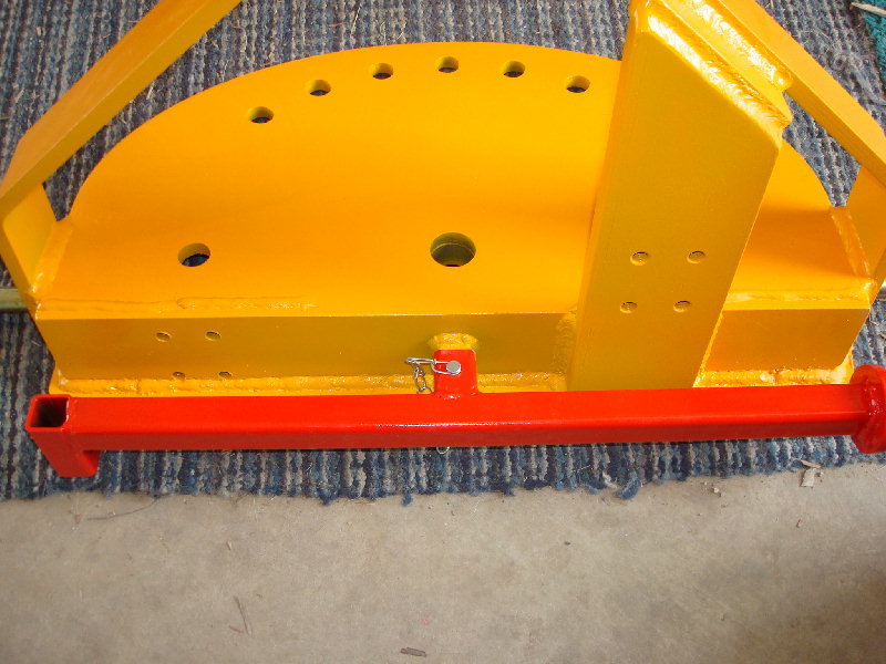

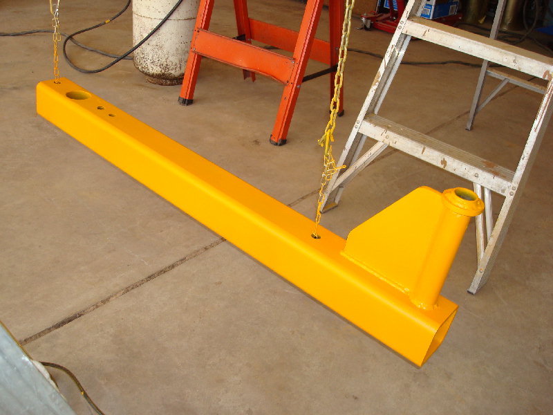

You can 'reverse" power coat. Meaning heat the parts first to about 375 to 400* F no more than 400! ( with a weed burner for big parts or plumbers propane torch for small parts (use an IR temperature gun to measure temp) then spray on the power coating, it melts instantly upon contact with the hot metal.
I did that process to coat my entire landscape rake project build and it came out fantastic.
Be VERY careful not to create sparks from the static of the power coat gun (Don't get to close to the metal with the gun) with this "reverse" process, the hot melting power gives off toxic FLAMABLE fumes that ignite instantly with a spark - (Don't ask me how I know this) You see my avatar on the left, right?
