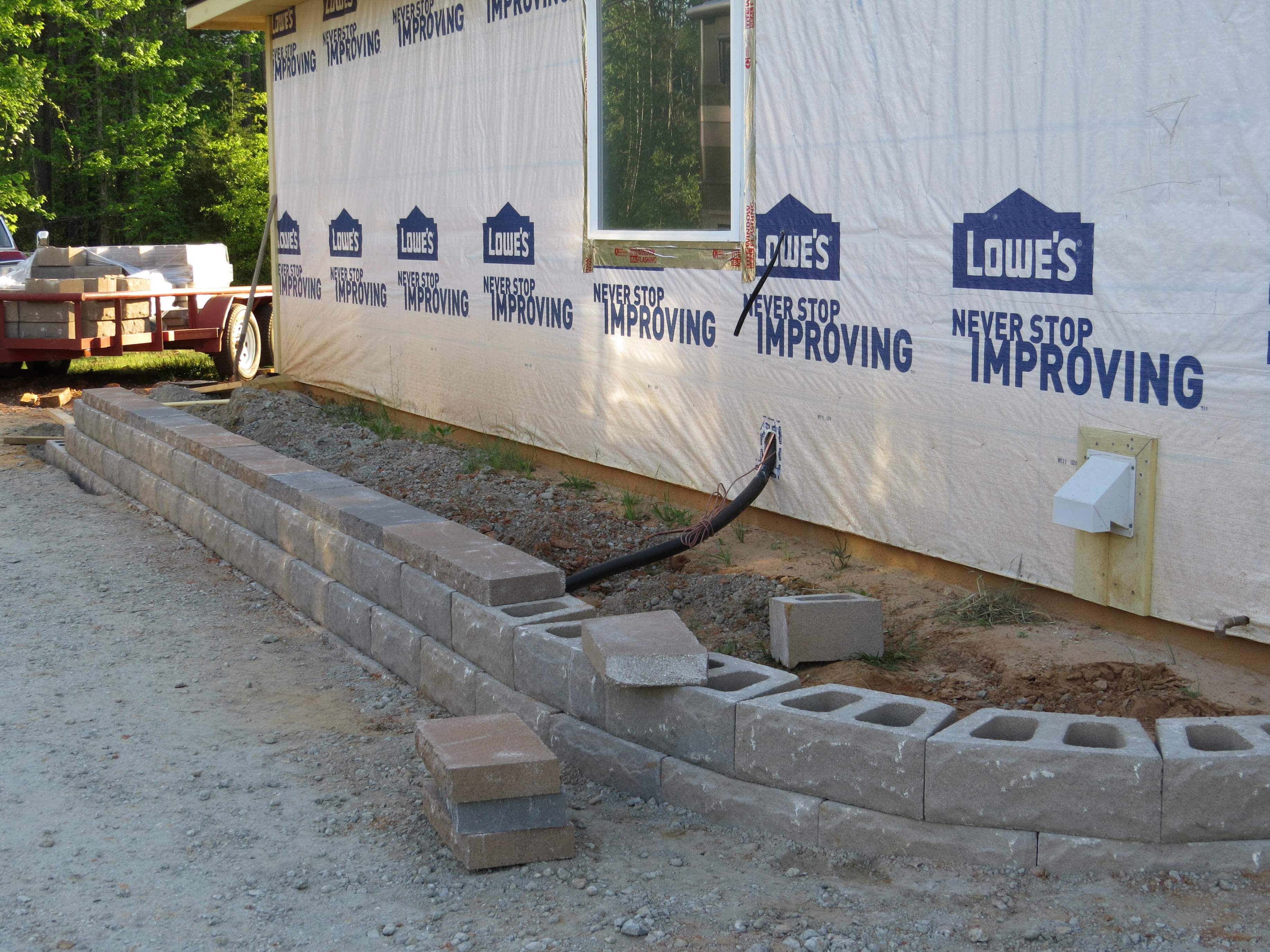

For a retaining wall, I agree that stacking blocks is the best way to go if it's not too high. This is what my 77 year old dad is doing by himself. He does a little bit at a time, and when he feels like it, he goes back and does a little bit more.
These are from Lowes.

I seriously doubt that a 4" thick by 3' high retaining wall is strong enough to work, no matter how much rebar you put in it.
Most retaining walls have a base or foundation which is much wider than the wall. Even the stack block walls usually require a base of 3/4"- gravel, well compacted.
In most places, walls under 4' do not require engineering, so you can build whatever you want. But, when I built a 5' retaining wall to hold the earth for driveway, I used stack block, but both read the brochures on how to do it with that brand of block, and had an engineer design it. Select a brand of stack block and look them up on the internet. Most have a wealth of information on how to do it right.
Another thing to consider is that randomly mixing blocks of various colors produces a very pleasing look.
Higher quality block than Lowes or Home Depot carries will cost a few $ more, but will give a much better end result.
Any way you look at it, a well made retaining wall is going to be hours of backbreaking work. Spend a little more and get a lot more.
