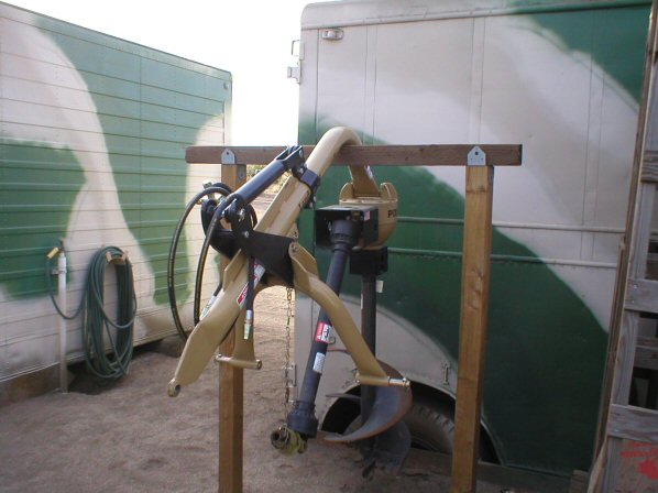

Hey "Jtette", I've got the Brush Hog 2102 also. I like it, but depending on what type of soil you're diggin in (hard dirt/clay), you might want to get the optional "Down Force Hydraulic" attachment (additional 550 lbs.). The force of most PHD's are usually only the weight of the boom + auger and that may not be enough for your needs.
Also, The type of Auger, # of cutting spirals and steepness/angle of the pitch, will make a difference with harder dirt.
Check out this post I started. Alot of good info to consider from others in there:

Although all post hole diggers seem pretty much the same I have had a couple of very bad ones compared to the Bush Hog 2102 I have now. I consider the 2102 a bit expensive for a post hole digger. It is better than the cheaper models that I have had in these ways:
The augers don't "walk" when starting a hole.
It doesn't "wallow" while digging the hole. Holes are round and straight.
It has the optional "Parking Stand". No "Sumo Wrestling" to hook it up.
It's a more solid and stable digger.
For those that dig only a few holes a year it's overpriced. But I had over 100 holes to dig and a very short time to dig them. The extra money I paid for it was money well spent. A lot less wear and tear on me. There is more to buying the best than something that will last forever. Ease of use may very well come with it.
Oh! And here I thought I was doing something wrong all this time! :confused:
It really is that bad, it's not just me?
