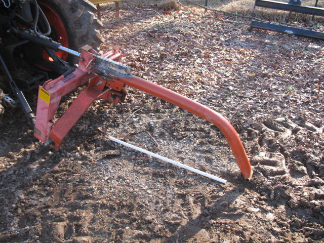

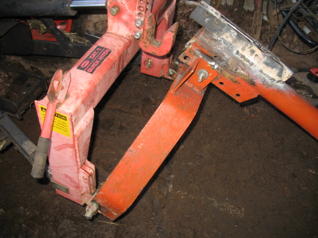

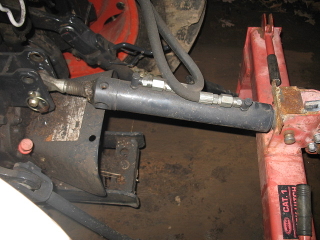

I decided to bring this thread back to life now that I've had a couple days to get started on the Post Hole digger mount to QH mode. For all those that advised me of the geometry problem, Thank You. It will not work without using Hydraulic Top Link. On mine I would loose about 18" of travel without moving the top link.
First came the top link, I did this a few months ago. I modified a short grapple cylinder that I had laying around, used a rod eye end from an extra top link cut it to link and weld to base of the cylinder to same length as original top link.

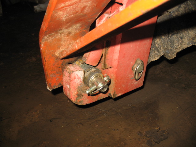

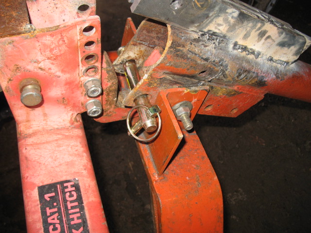

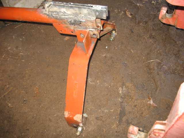

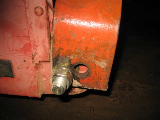

Then the PHD: Relocted the lower lift pins to clear the lock taps on QH, moved them forward and slightly down.

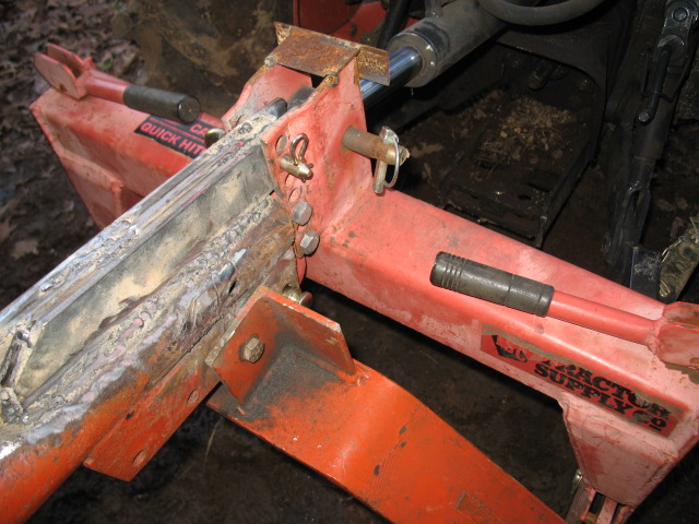

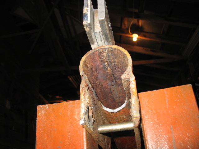

Cut the PHD tube off same length as top link fully retracted. Then notched out bottom of the tube for QH hook to slide in.
The bar stock added on top is (3) 1/4" pieces to match width of the hook. They help pull the digger up tight and reduce side movement of the gear box when under torque.
To mount it: Drop the lift pins in lower hooks, raise end of PHD boom to slide pin through the hook, the raise little more and slide smaller hitch pin in.
Getting alot of pics here so will start another reply showing the movement.

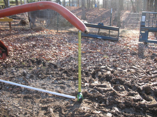

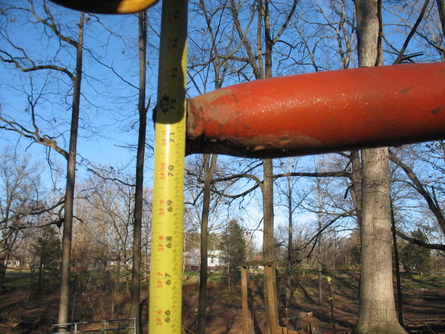

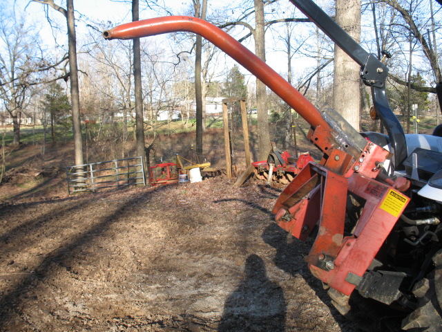

/ Post hole digger to Quick Hitch?
1st pic is with 3pt down and top link retracted, end of boom 22" off ground.
2nd is with top link extended part way, boom hits the ground.
3rd & 4th pics are at fully raised top link retracted = 6'. Gear box with auger are 4'8" so I should have plenty of height.

Sorry for not updateing this sooner, I wanted to make a video of it but that hasn't worked out due to no one to help. It works quite well, but I do want to fine tune my top hook connection to make it a little easier to hook up. As it is, it is still faster to hook up than taking the QH off. Digging is great. I great positioned where I wan to drill, extend the hydraulic top link until auger hits the ground, then drill while lower the the 3pt. Move the auger up & down only with the 3pt to clean the hole, then raise 3pt completly then retract top link to lift all the way up.
Two advantages I found are:
1. PHD has more travel using 2 functions. It raises higher and will dig deeper when needed.
2. With it mounted to the QH, the arc of the gear box/auger when digging is less so very little movement forward after the auger starts to dig is required to keep the hole straight.
