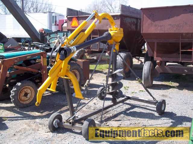

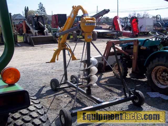

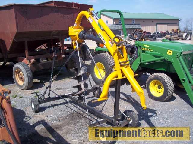

I saw a pretty sweet stand at an upcoming auction, I plan to bid on this setup.

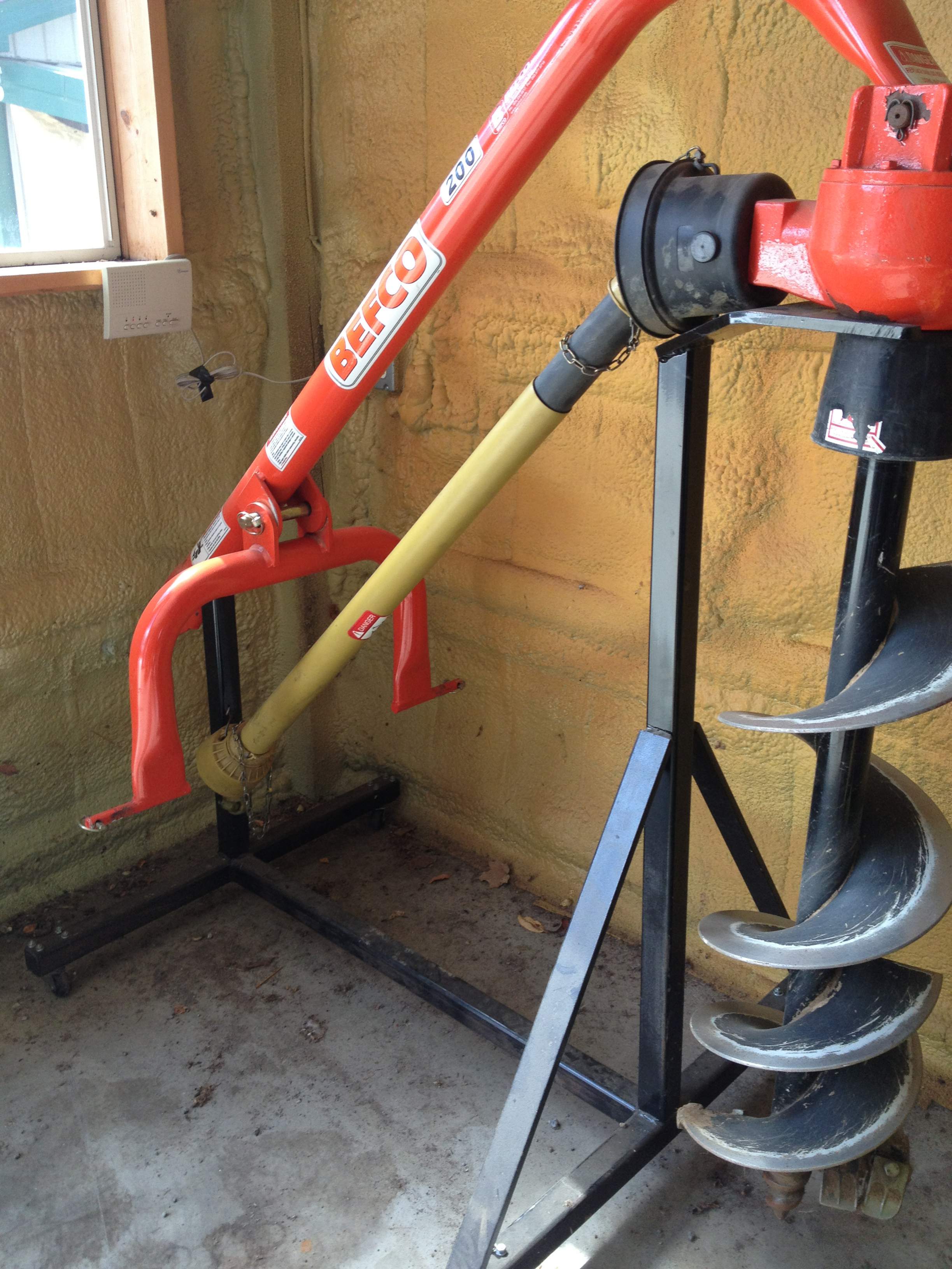

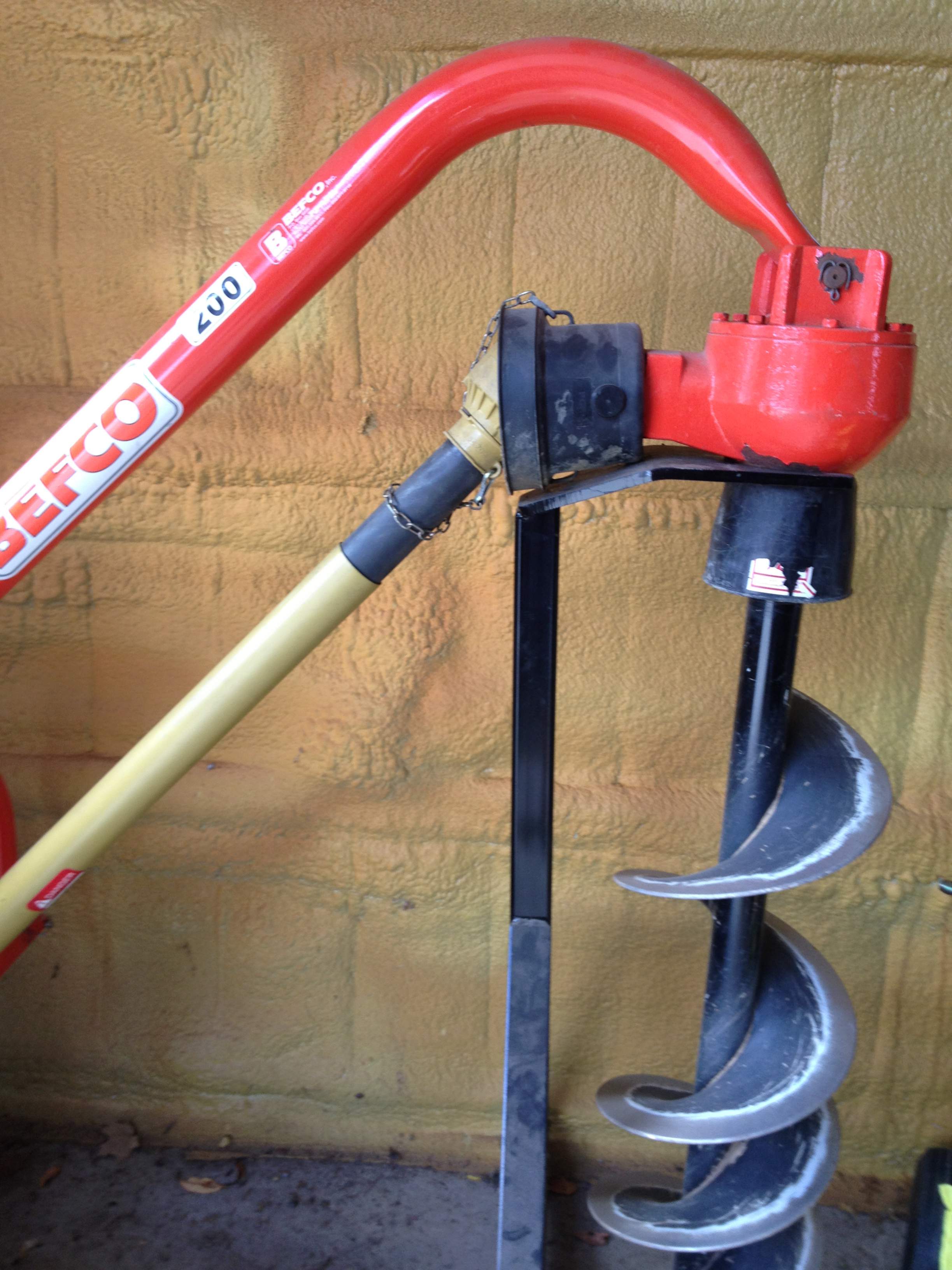

/ Post hole digger stand #90
If I can get a picture to post from my phone. My setup allows me to backup to my PHD and hookup easily.
Microsoft services
/ Post hole digger stand #91
Didn't quite attach as I wanted but....
