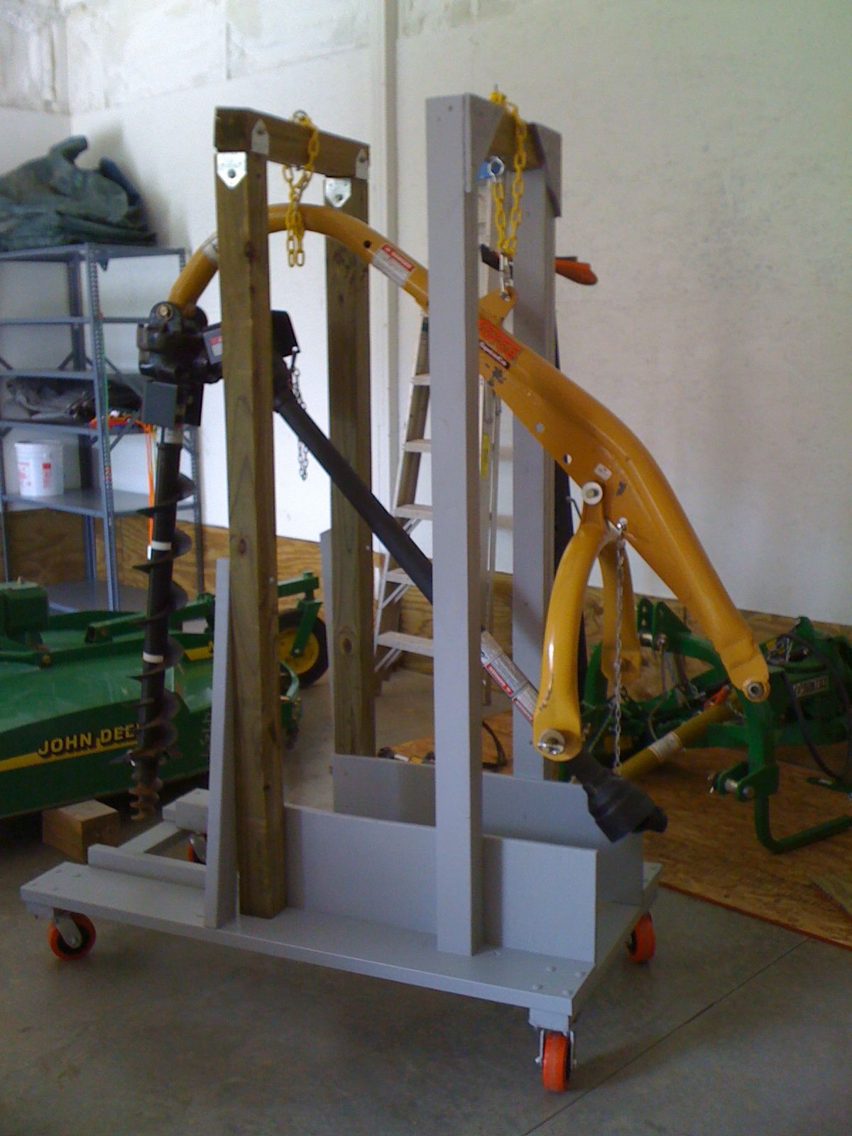

I finished my holder for my Speeco (TSC) PHD. I see that a lot of people just hang the PHD from a single attachment point near the back. I built mine with two points holding the PHD. This is possible because of the design of this particular PHD. You raise your PHD to the right height, roll the dolly on, attache the chains as tight as you can, then gently lower the PHD.
As you lower it, the rear chain slides a bit, the forward chain angles a bit and the dolly slides a bit. When you unhook everything, the part of the PHD that attaches to the toplink is at the same height (within 1/4" the 2 times I tried all this) as the tractor toplink connection point. So it's _really_ easy to put it back on. With the two connection points and dolly, you don't have to lift 1/2 the weight of the unit to get it all on. For the draft arms, you are just lifting the draft arms.
I plan to put two pipes on the back to hold spare augers. Built of of scrap wood, biggest expense was the casters. They are 5" 600# ones which is way overkill, but the bearings have grease fittings and the big size makes the whole contraption move around very easily. They were $12 each at Northern Tool. I also bought some plastic coated chain and a few fastener do dads. So I have less than $70 in this. Have other dollies I'm working on, they will have smaller (cheaper) 4" 400# casters on them.
Also doing a dolly for my quick hitch, will fire up a separate thread on that.
Since most of the stands I've seen are "single hangers", I thought I post this "double hanger" one. It worked better than I thought it would :thumbsup:
Pete

Pete, this setup sounds like it is going to work good for you. :thumbsup: How long would you say that it takes you to hook up and be ready to use it? When ever I am able to get my barn built, I may steal your design. :D

Great minds think alike (and fools seldom differ :laughing:)...
The big difference I was playing with was the two support points so that there was little to no lifting. I'm not getting any younger here. The Speeco had that bracket thingy on the main arm that made the two point hanging work. The dolly on wheels (like kebo's) is all about better storage of indoor stuff. It sure looks like the single hang point design achieves a balance point (as seen in Equine Network - I like the architecture of your top support :thumbsup:), but I think the two support is even less lifting and work to attach and get the tractor positioned correctly.
MtnView, I'll have to time it but it sure seems like a 5 minute job to position and attach it. I really want to wait until my iMatch dolly is done (built it today, should be dry by tomorrow) and get a total time to remove the iMatch and put on the PHD then go the other way. In addition to less lifting and work, the easier it is to change out attachments the more likely you'll do it and use the right tool for the job.
And as always, the jump from no solution to any solution that works is the biggest jump you can take. We're all just messing around with that last 5 percent of the problem :).
Pete

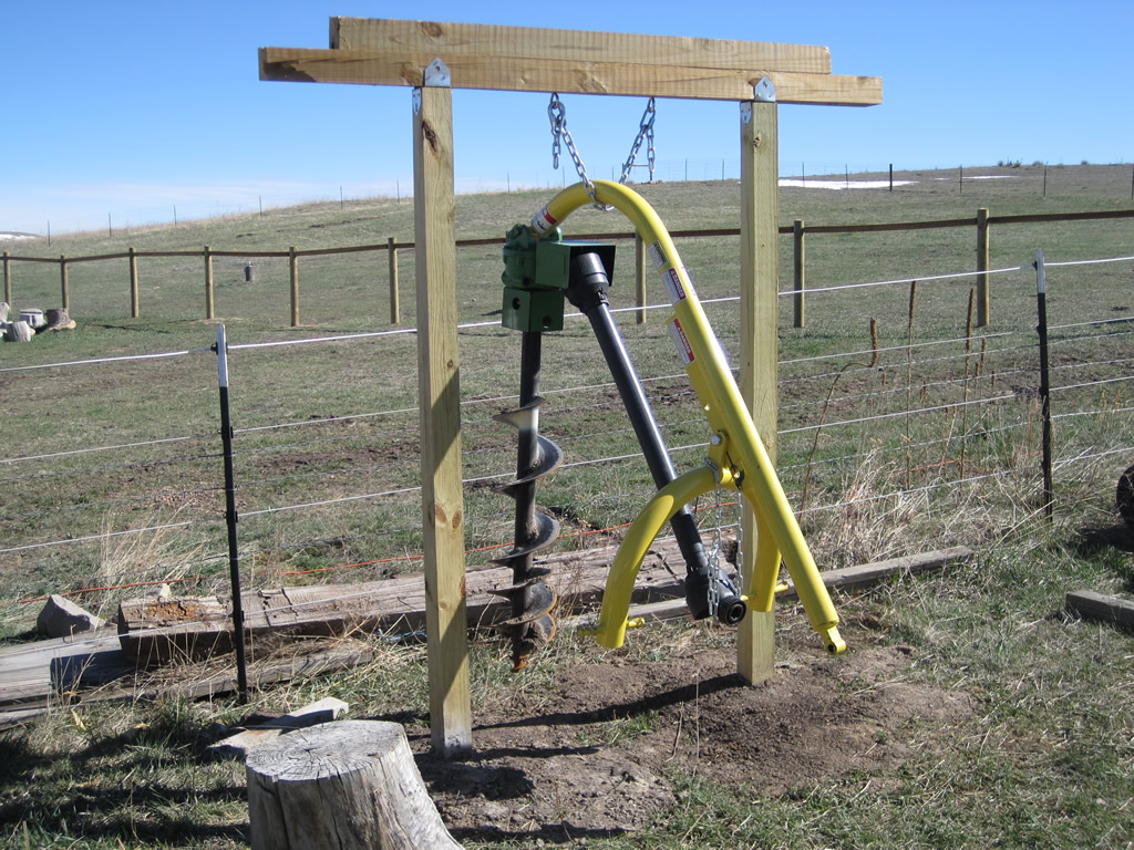

I've found that I can attach and remove the PHD very quickly with this rig (never timed it, but no more than a few min). Since the PHD is fully suspended, I can swing/move it into whatever position that's needed very easily. Anyways, this works for me!

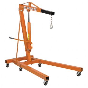

I was thinking of using a Harbor Freight engine crane. This one is on sale. Have to see if it has enough height.

I copied MtnViewRanch's design, it works like a charm. The only disadvantage I can see is that you have only one spot to park the PHD. That's fine with me, I have limited yard space available anyway.
The PHD is perfectly balanced hanging on the stand, you can position everything with one hand if you had to.

So I put the PHD on the tractor, then took it off and only used the 1 rear hanging point. I disconnect the lift arms 1st on removal, connect them last on install. It was a little harder to take the PHD off at the toplink since there was a bit more lifting involved, and a lot more pull on the pin. It was a little harder still to put the PHD on with more lifting and so forth to get the toplink on. Basically, by the time you wheel it around a bit you have to lift the PHD arm up a few inches, support it, and get it lined up and put the pin in. With the two support points, it was much closer to lined up and less lifting to get the pin in. Pin removal with the 2 support points took near zero force- when you set the PHD down, it all settles to the right spot.
I think the 2nd support is a win, but then I already put in the effort to build it. It is clear that as I get older (which some days seems like it's in about 20 minutes) that I'll like the 2 support system more and more. I understand that it just takes one hand to position everything, it's just when that ugly arthritis starts to set in seems like the one hand can do less and less.
BTW, it's definitely less than 2 min to remove, less than 4 to put on including firing up the tractor to get the lift arms close to the right height :thumbsup:.
Maybee the answer is build your dolly stand so it can take a 2nd set of supports, then if some day you need them you can add them. If you're over 60, just build the two support system.
Just my opinion, YMMV, void where prohibited. I'm through singing now.
