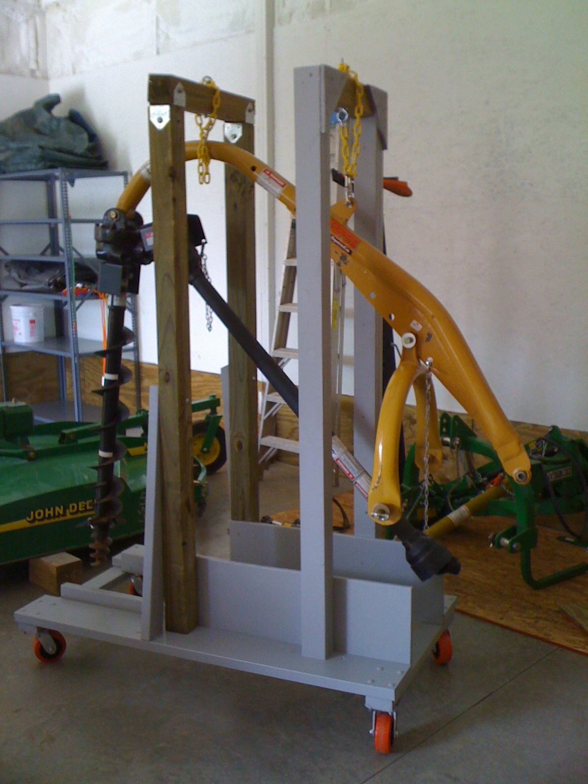

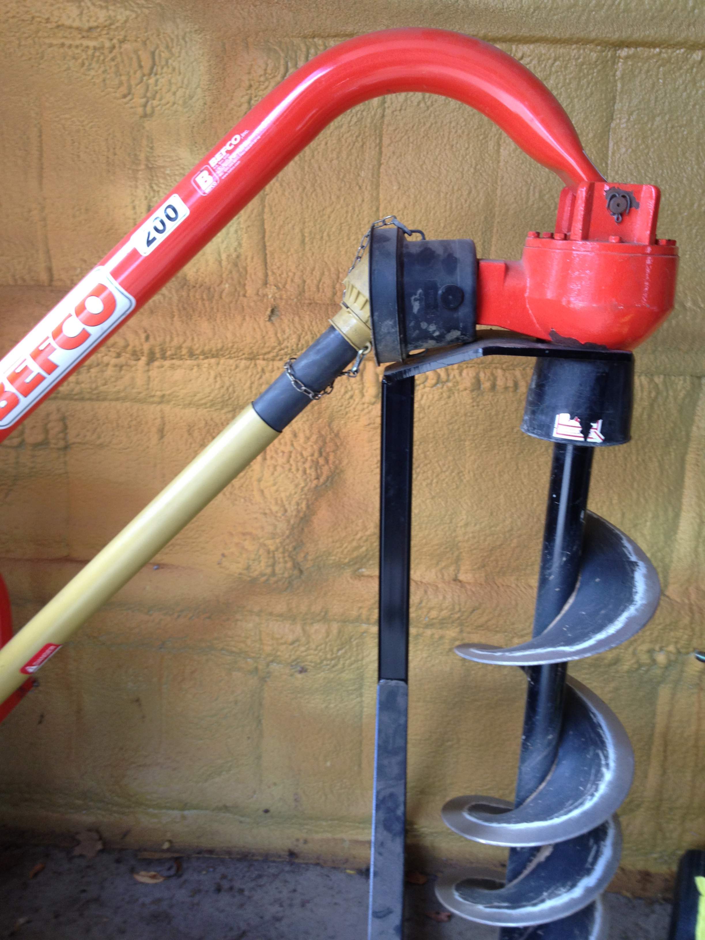

I saw a pretty sweet stand at an upcoming auction, I plan to bid on this setup.

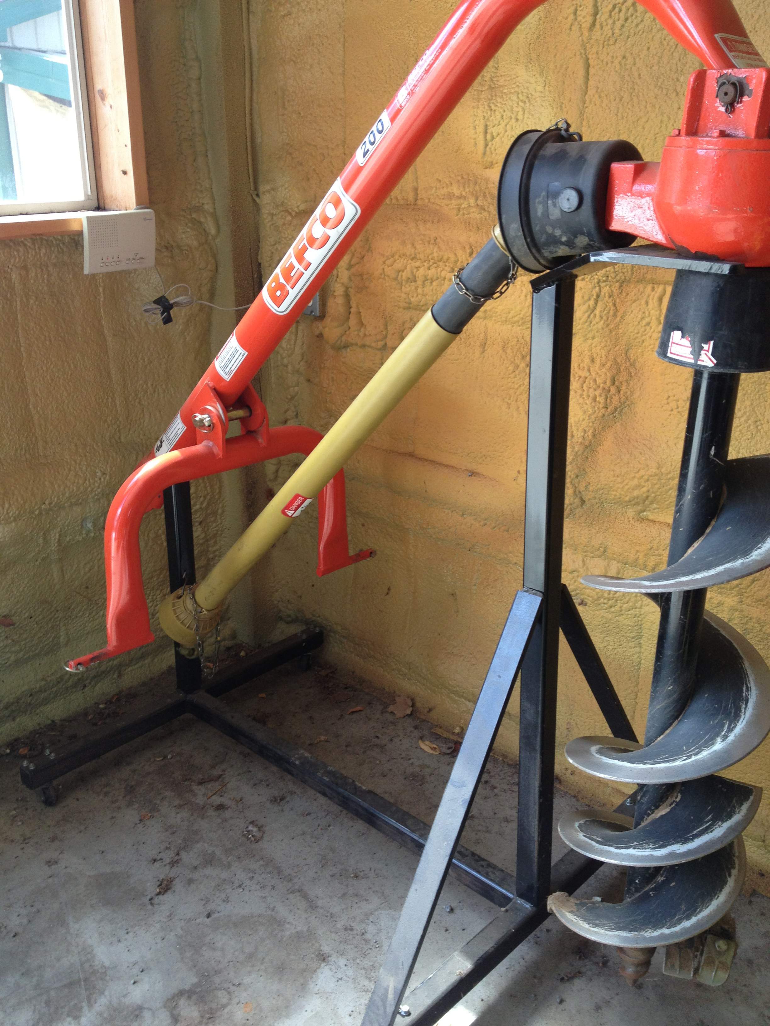

/ Post hole digger stand #86
Here is mine.
