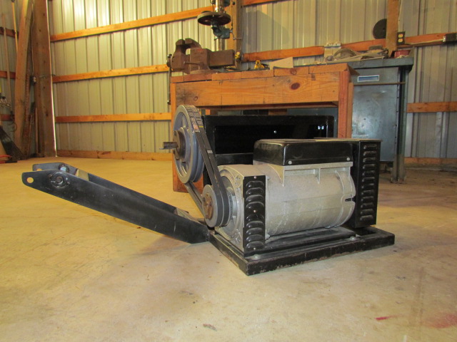

I am flip flopping between using Pulleys and Belts or just buying the Gear box for $299 along with the LoveJoy style coupling ($99). If I can find the correct size pulleys at a reasonable cost I would go that way, however pricing these things out brand new, they are not cheap! I found this Website Central Georgia Generator that deals in this particular Gen and they carry all sorts of spare parts for these.

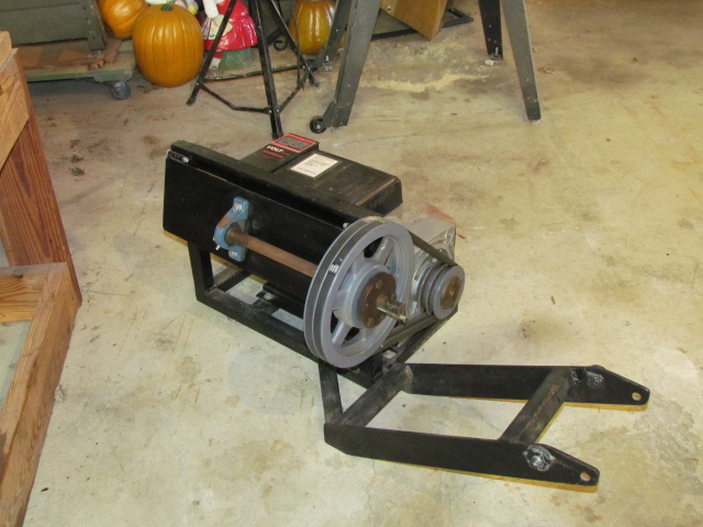

I did this several years ago and drove the 10k gen off the front pto on my simplicity Legacy. Just sold the tractor so I will be redesigning for the rear pto on my new gc2410. I had no problems running my 25 hp Legacy @ 2100 rpm. It took a couple try's with the pulley arrangement to get the 3600 rpm at the generator. I will do the same with the rear pto. I'm going to set it up to run @ 2k. I'll have to run a double step up pulley system. I'll post up pics of my other setup tomorrow.

Took me a while to get out to the barn. This work thing keeps getting in the way. :)
/ Possible Gernerator Project #20
Would it be any simpler to front mount it on the GC and run off the mid PTO ? RPMs would be close to the simplicity, no?
