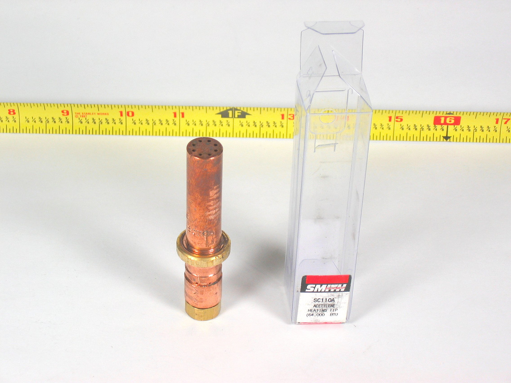

So I went to their site, yes they do make a combination torch, but I didn't see a rose bud, is there a rose bud that fits a Smith mixing chamber, or will a Victor rose bud fit?
Smith make a wide variety of OA gear, but their website is horrid. Totally different torch joints so they don't swap with Victor.
They make excellent combo torches, rosebuds, etc.
Smith - 16205 Medium Duty Torch Combo Kit - 16205 | Baker's Gas & Welding Supplies
Smith and Victor also make rosebuds which fit straight torches.
