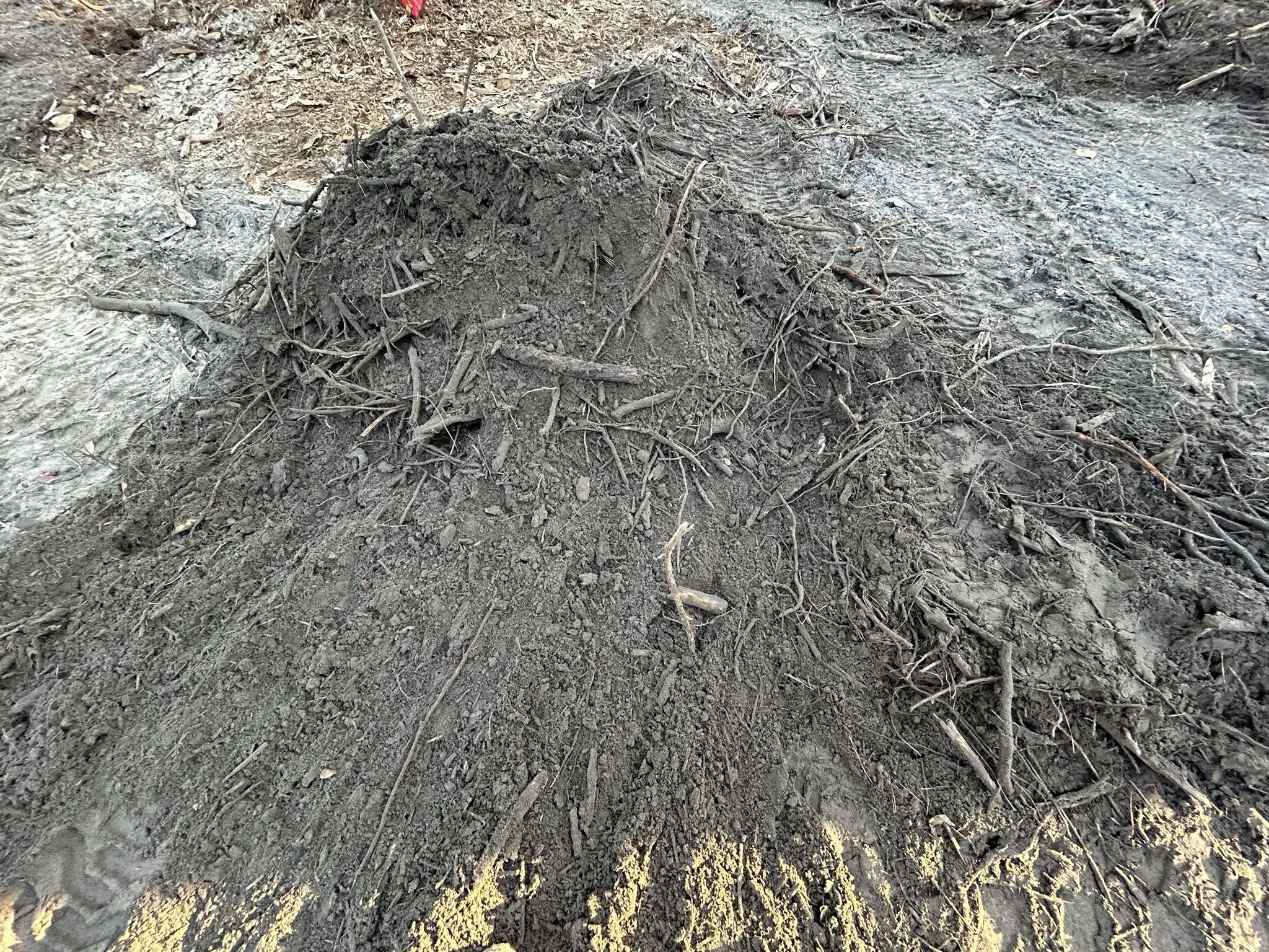

There are a lot of pretty large pieces of wood all over the place. It was a pretty course cut on the mulching job.
After lots of raking and separating, I end up with a mix of small stick and lots of viney roots.
Here is a picture of a very small pile of what it left after getting all the big stuff out.

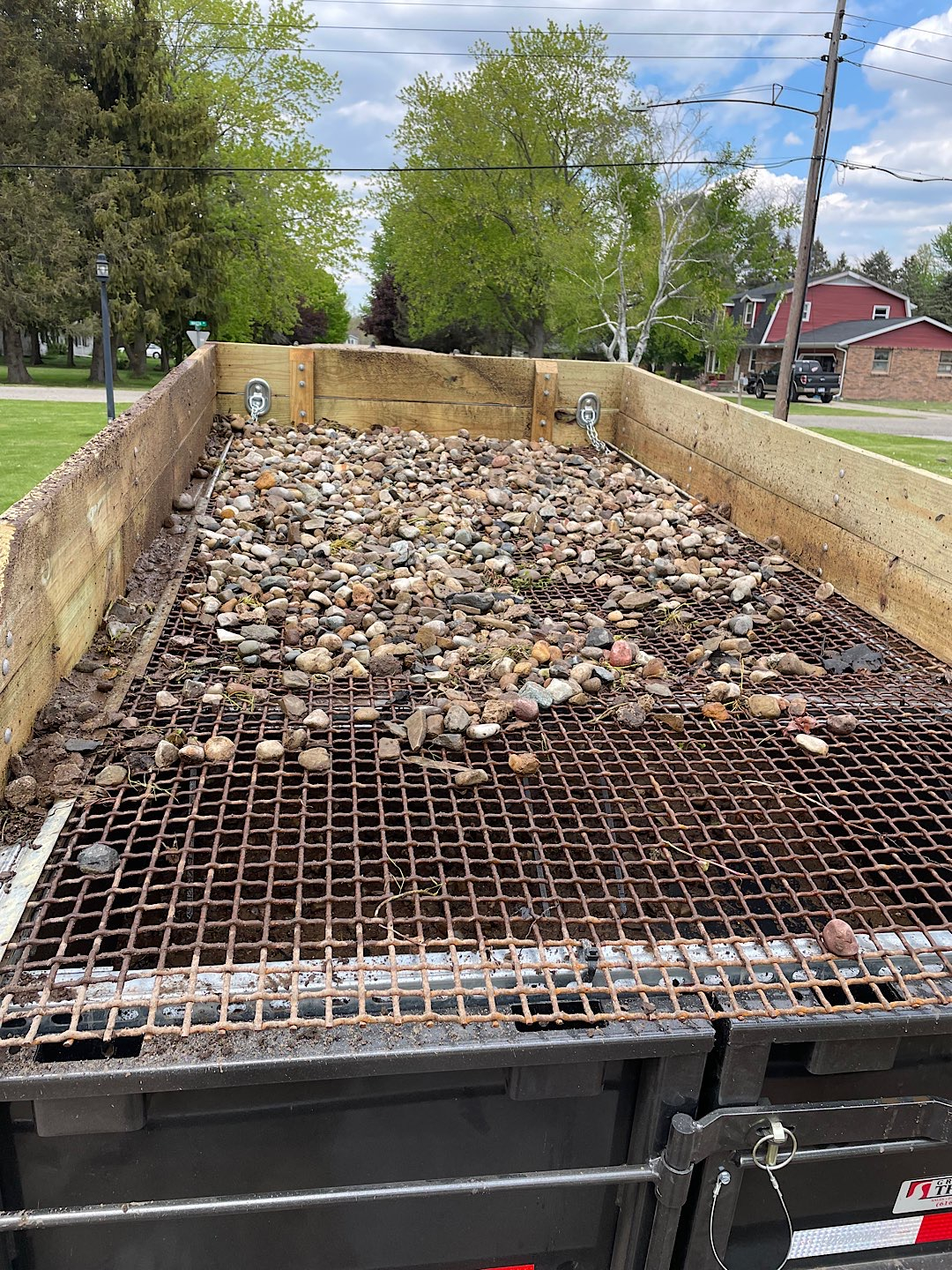

I built this to drop into my dump trailer and clean river rock. It worked ok but wow what a mess! Luckily I had the wife on the power washer so she got most of it. I gave up after awhile - took to much time.

Hey fishin, looking at your picture it dawned on me that this all is scattered around on the ground (right?)
Hire or rent what's called a "Harley rake". They have 3pt. tractor types but most are for a SS. It'll windrow those chips and leave a fluffy bed for seeding.
No piling up and moving to a screen, then moving it back and spreading it.
YouTube will have a bunch of videos.

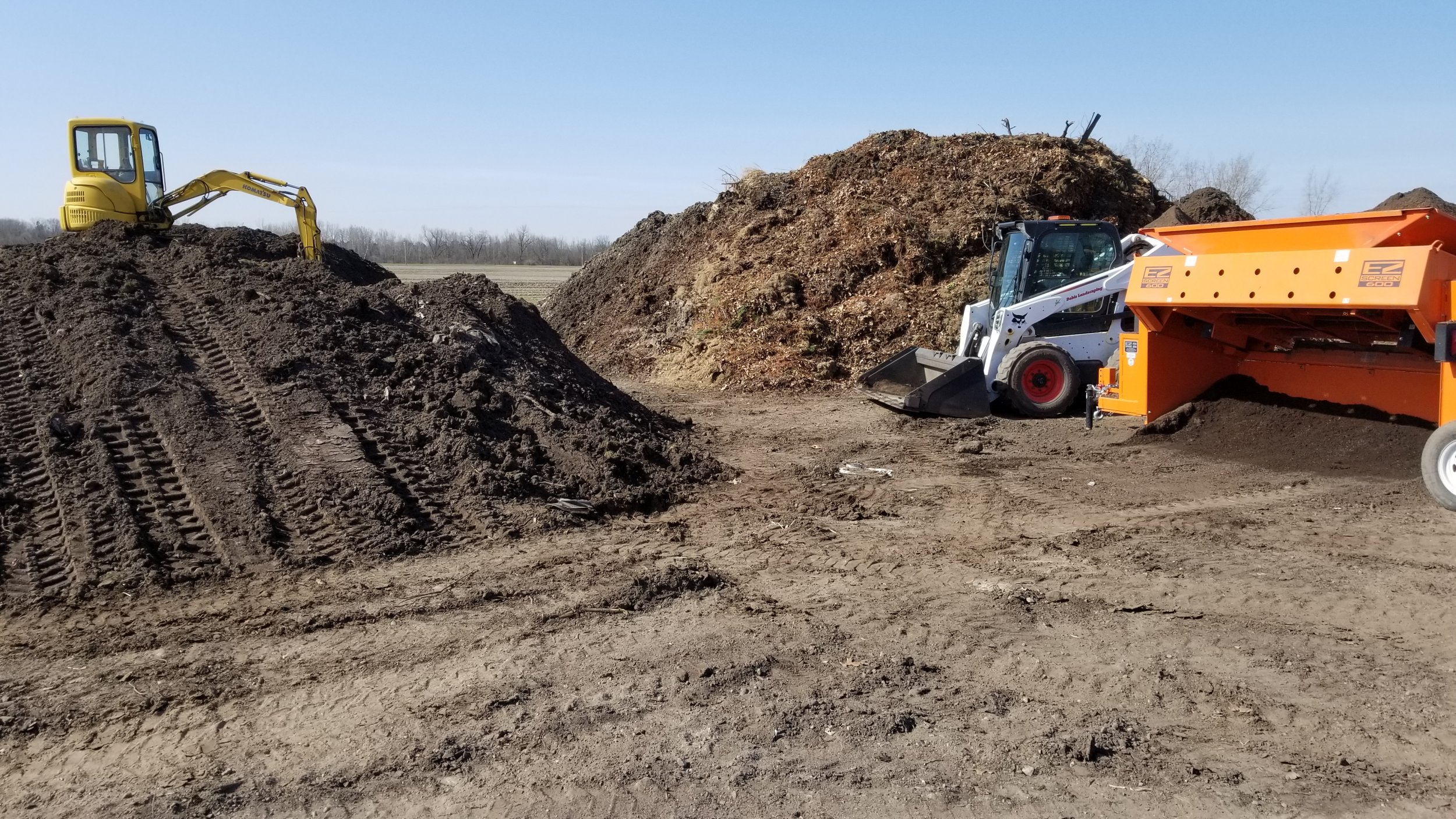

Well, the story behind the screener goes that I realized my boss was paying a stupid amount of money to have the lawn and landscape waste of 3 landscape and 5 lawncare crews removed from our yard every few years so I convinced him to let me blend it and turn it to topsoil. He got super lucky and found the ez screen 600 with 8 hours for 10 grand. Ive used it for 2 seasons now and it more than paid for itself the first year. No issues whatsoever other than it occasionally breaks one of the bolts that tensions the screen but its like a 2 minute fix. considering the minimum cost of screened topsoil is 20 a yard around here and im making about 15 yards an hour out of stuff that we otherwise would have cost 6 bucks a yard to remove, i'd say its worked out pretty well. From my perspective its easy overtime with no questions asked whenever I want.

That is the exact kind of info I started this thread for.
Thanks for the response. Thanks to everyone else for the input
This has made my decision very easy.
