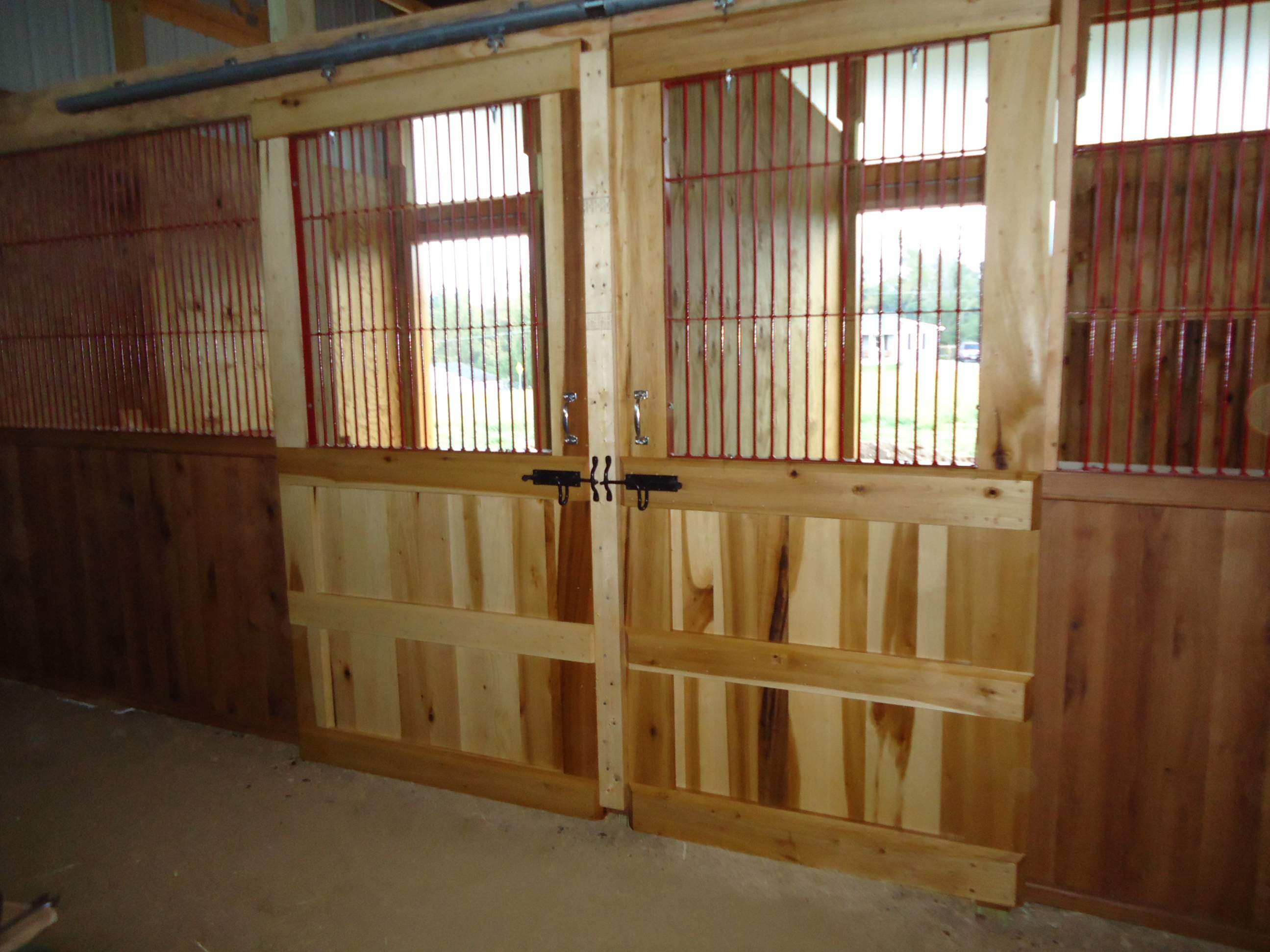

I love working with Poplar. One of the easiest of the hardwoods to work with. Not sure if it is the minerals in the ground in E./SE Ohio that gives it the variable colors to the wood or what, but love the way it looks. Here are some stall doors I built last summer for my new horsebarn out of some of it.

Very nice. I like those. Mine won't be as fancy, but I hope to do something similar for my goats.

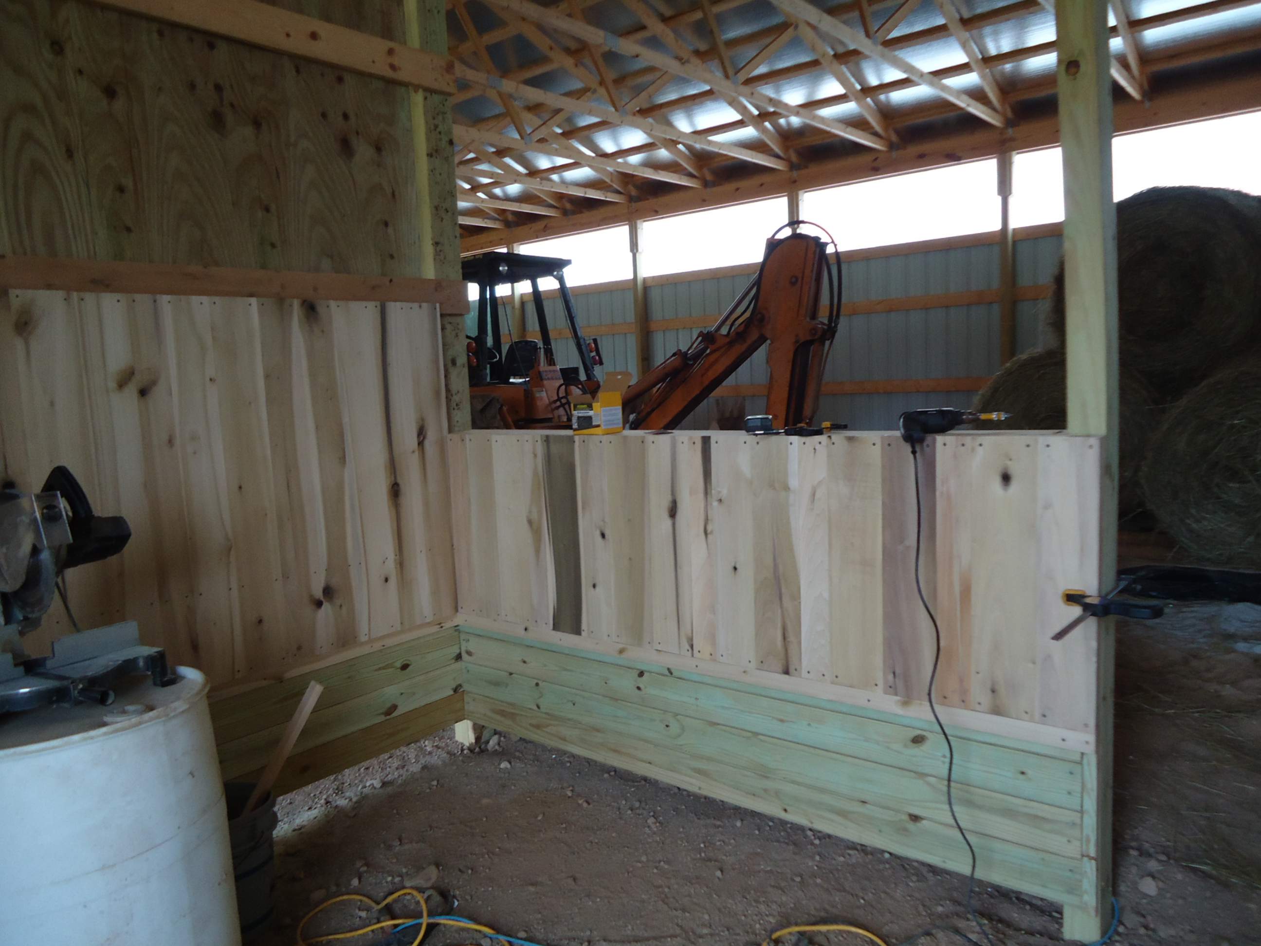

Thanks... Here is another picture of the inside of one of the stalls. More Poplar, planed to 7/8", ship lapped, and screwed to walls. I put two coats of Thompson's waterseal on it, for a finish. Did this in my present barn almost 12 years ago, and holding up real well.
