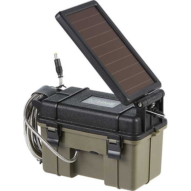

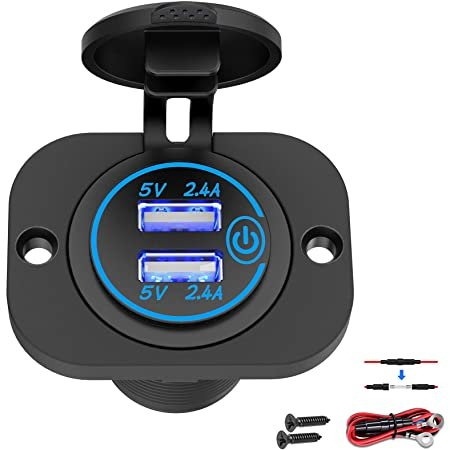

Buy a USB power pack or a 12v battery jumper/starter pack and rock on. Just make sure the mah exceeds your needs.
I use a solar battery pack made for hunting cameras in the deer blind. It has 12v 35mah battery and a small solar panel. It is all self contained and all I did was splice in a 2 wire waterproof plug that plugs into the harness that runs down one of legs. I put a dual port USB plug inside the blind and it has powered a tablet and a phone with no issues.
I attached pictures of the battery pack I use and a plug that is similar to the one mounted in the blind.
