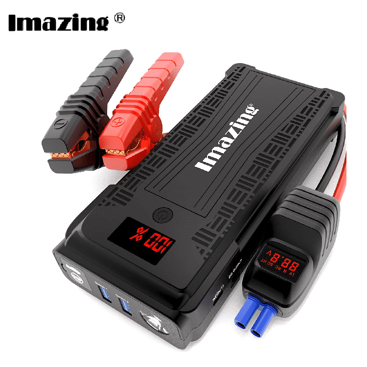

Based on Project Farm's earlier video I bought this model. It has served me well for cars and for my 24 hp tractor - from no click, to cranking like mad after attaching it and waiting a minute for it to transfer some energy to the battery.
It's the size of a VHS video. The carrying case containing it, cables and the phone charger that re-charges it, will fit in your (empty) glovebox.
I got this from Amazon three years ago, $80. It still works like new. Today Walmart has it at that price. But see Project Farm's latest reviews before choosing one now.
