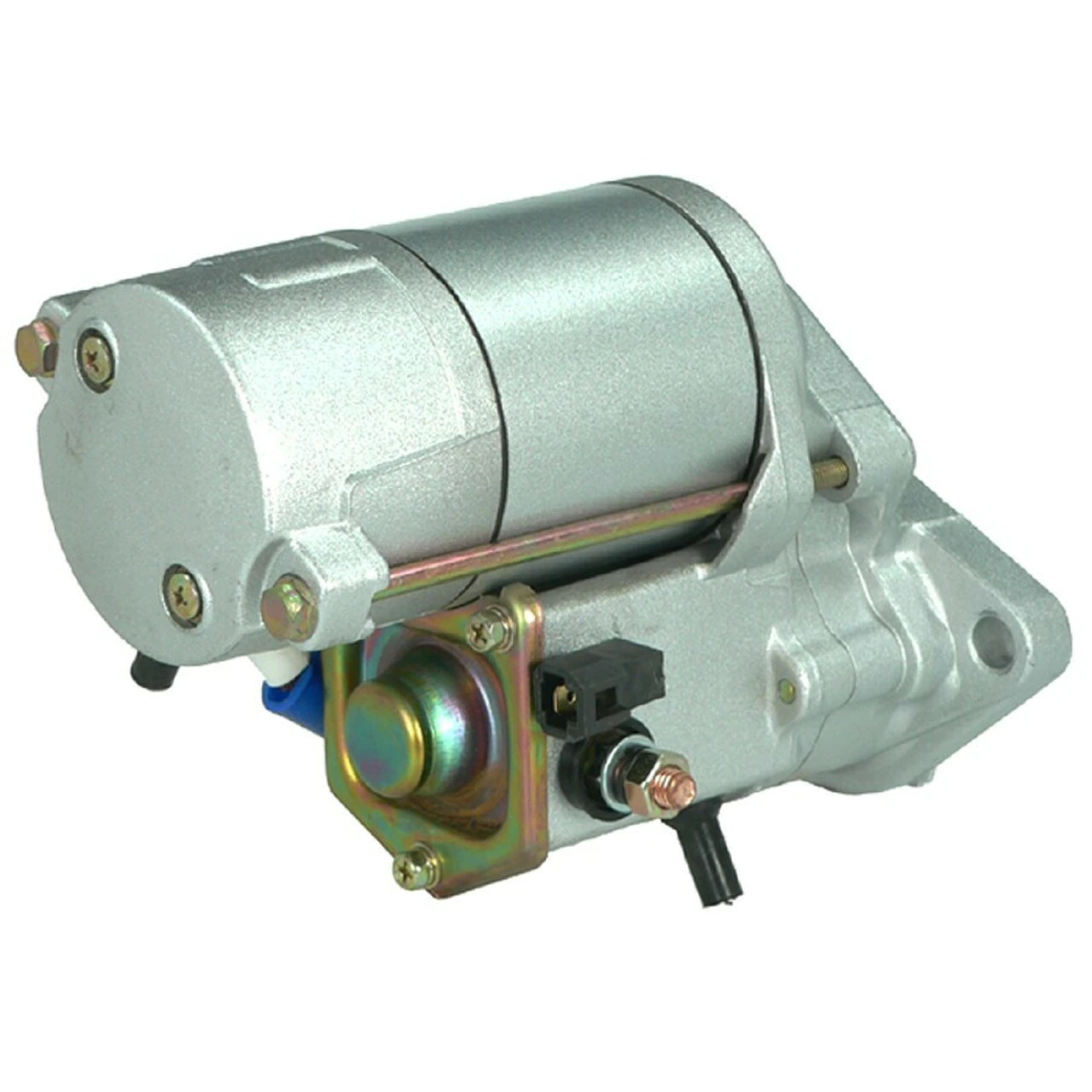

I inherrited a 2004 TC40A with the adjacent horse farm I purchased. The farm had been leased out for about 5 years before this, I this tractor was used and abused without maintenance for at least all of that. I've been trying to bring this tractor back to glory, and the most annoying thing is this intermittent starting issue. It sounds so similar to all these other threads, but after hours of reading, I cant pinpoint an actual fix that applies. It can start fine 4-5 times in a row, it can start after a few turns of the key, or it can take 3-4 minutes. Assuming it's not starting, here are the symptoms:
1. Turn the key and hear the click, but does not attempt to crank
2. Continued attempts do eventually result in a start.
3. Too many consecutive failed starts and the red PTO light comes on and it will no longer click. This requires turning the key off and letting it sit for 5-10 seconds before starting again.
Local dealer has tried to diagnose the problem with no success. Multiple saftey switched have either been changed or jumped. Electric and wiring is no my strong point, but the dealers mechanic said no ohms are getting to the starter when it does this???
One of the previous tenants apparently tossed the manual, and I cant find a manual online for the TC40A specifically. Assuming this model and year are largely identical to similar models within a few years of this one, I've seen mention that it could be the starter solenoid? Only problem is, I cant find it on this tractor, and cant find an actual diagram to locate it. Is it just built into or part of starter itself? I've found wiring diagrams that specify the solenoid, but as stated, electric is not my strong point, and reading a wiring diagram may as well be Chinese.

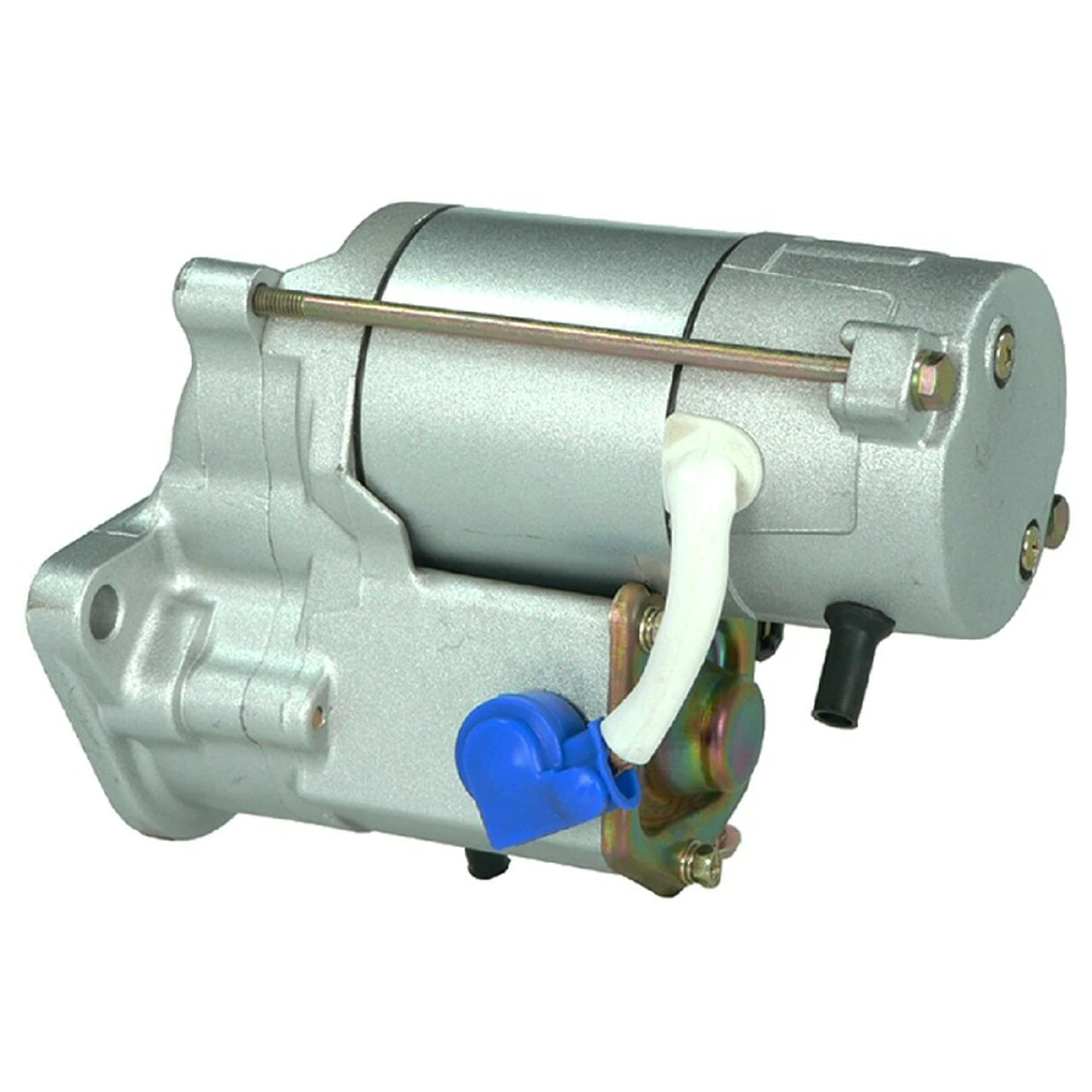

Is that my solenoid part of the entire starter assembly? Main power goes from the battery to the lug in the first picture, second picture is the other side. Is the solenoid under that brass cap?

On your picture of the starter I have what you need to do. The picture of the 5 pin solenoid is because they are cheap and available everywhere. This is a low power circuit. Get wire that is the same size as the original start trigger wore or bigger. 14AWG at a guess. The relay is just so the path from a *good* 12v source (the solenoid battery positive terminal) to the start trigger is good quality, not that there is a lot of current flowing through it. Wire size doesn't really matter as long as the runs are shortish (up to 18" maybe) and your connections are high quality. If you are mounting the relay up in the dash with the other relays because you are a sadist you might want to use bigger wire, but as long as you use at least the same size as the factory stuff and a decent crimper you will be fine.
Mount your new solenoid somewhere out of the way. Somewhere neat is good if you have the wire length. I forgot I needed to run a ground and didn't take enough wire so mine is just bolted on wherever for the moment.
Take the original wire off the start circuit plug and extend it to one of the trigger pins of the solenoid. It doesn't matter which, it will work either way with this type of relay but I used 85 on the picture. If you get fancy with a solid state relay or something this will need to attach to the positive trigger wire.
Run a ground (I forgot this wire so my install looks dodgy) from the other trigger pin (86 on the picture) to a solid ground. I used one of the bolts on the solenoid in the picture, but it doesn't have to be that. A bolt into the chassis or engine near where you put the relay is good. If you have a multimeter check either continuity or resistance from a few bolts to the negative battery terminal. Less than 2ohms (lower is better) or continuity light / beep is what you're looking for.
Run a wire from the large positive battery positive terminal on the starter to the high current terminal of the relay. 30 on the picture but 30 or 87 is fine. DO NOT use 87A or the starter will run all the time *except* when you turn the key to start.
Last wire is from the plug on the starter to the relay. 87 on the picture.
