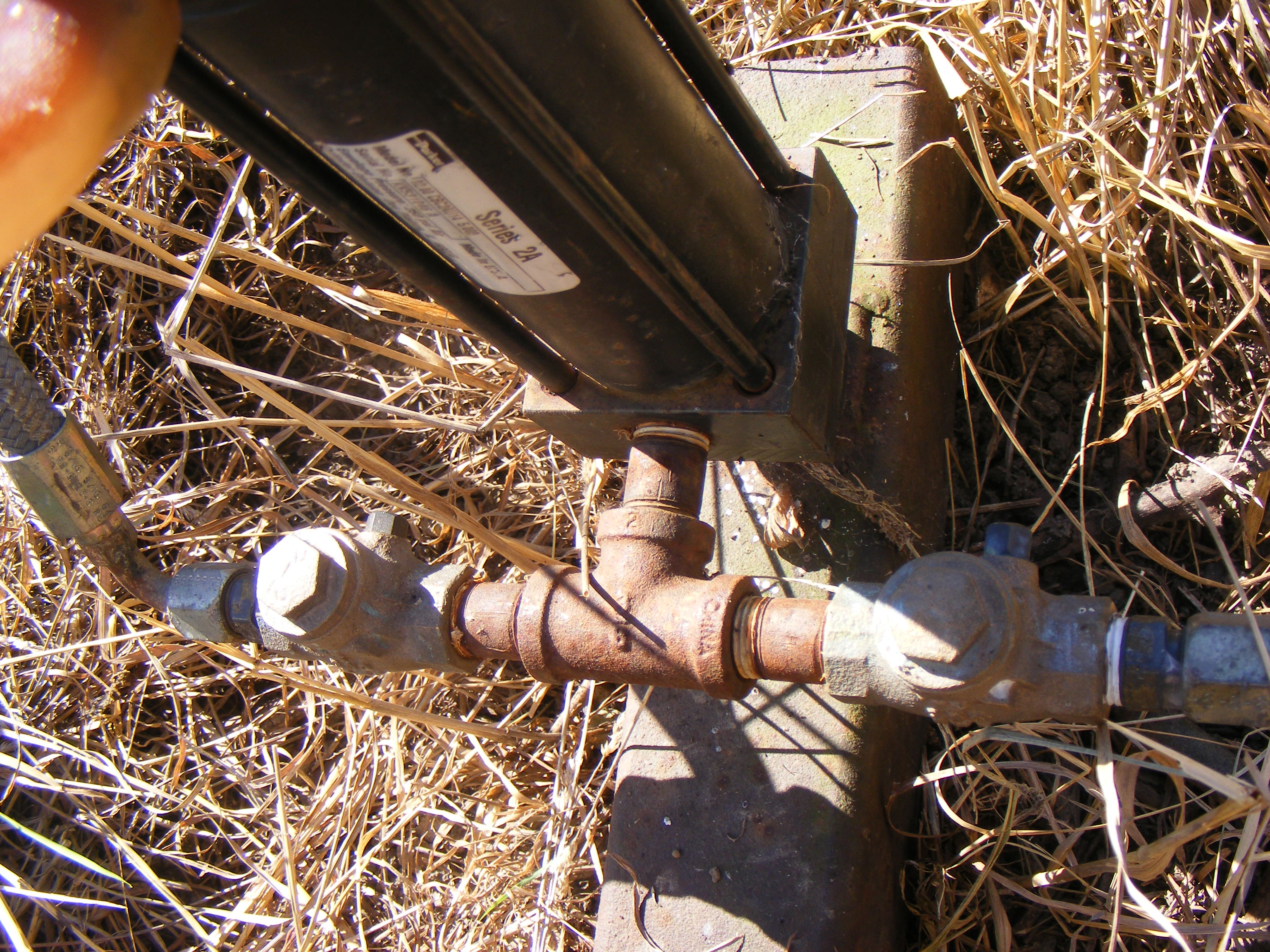

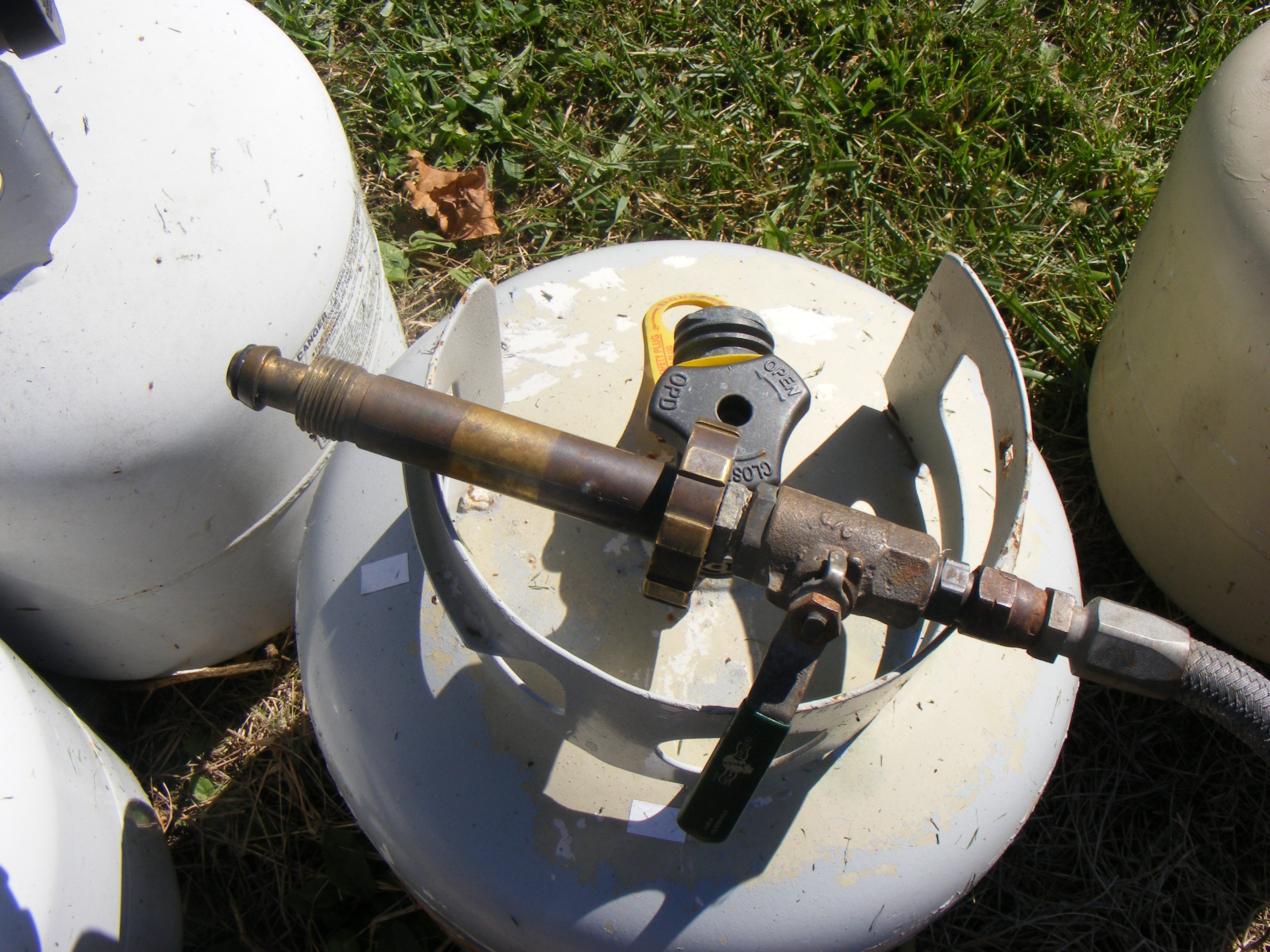

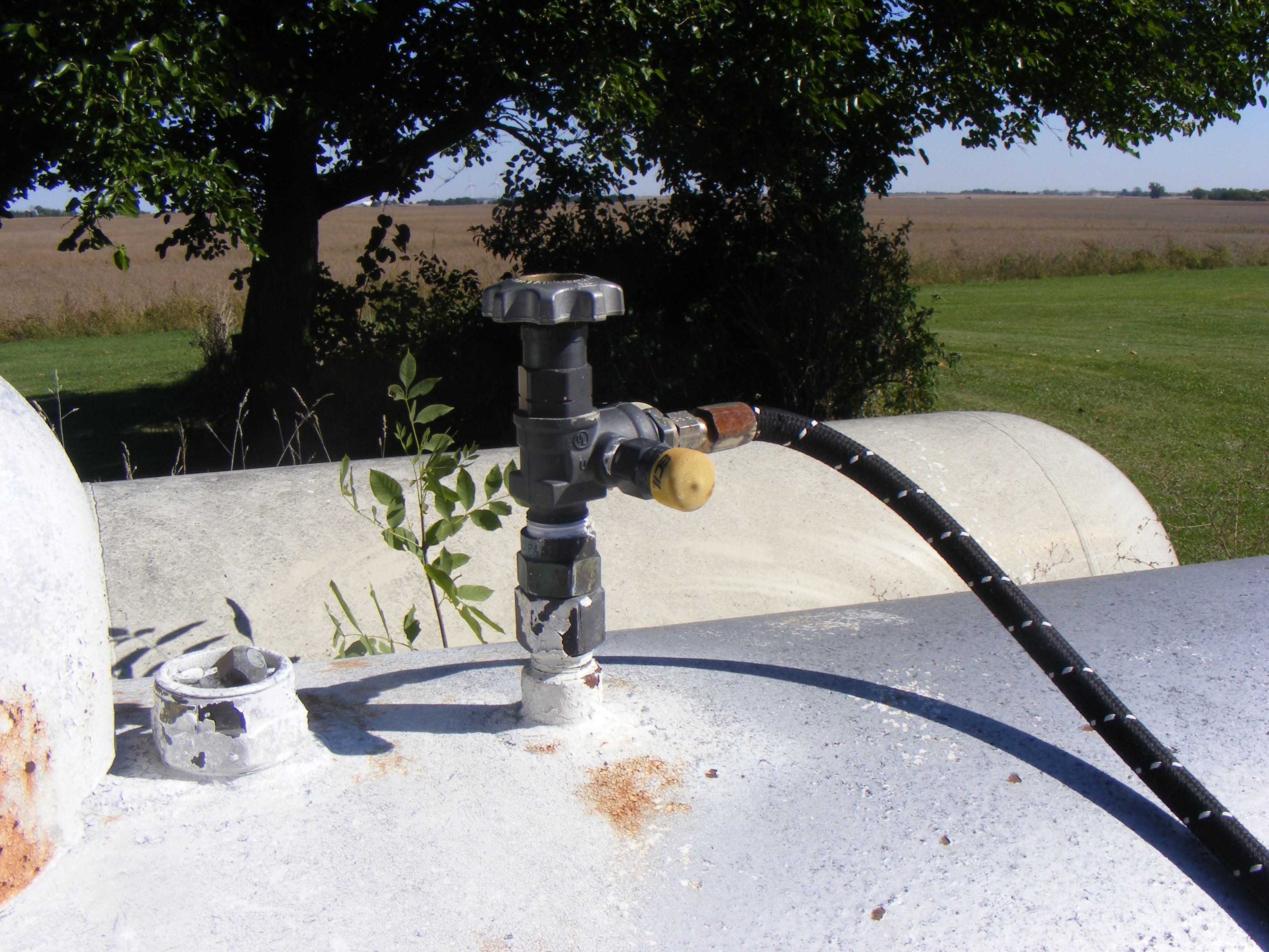

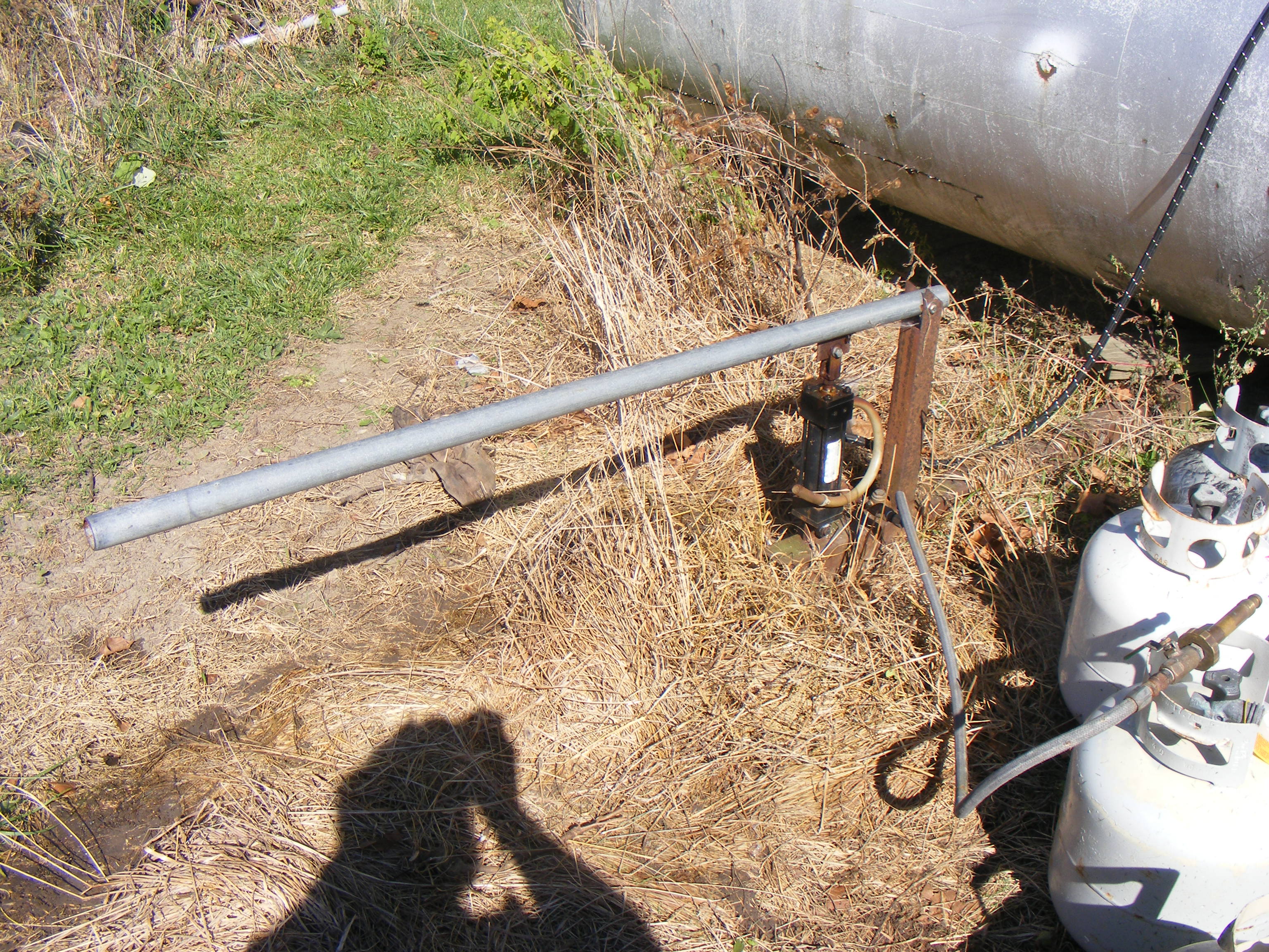

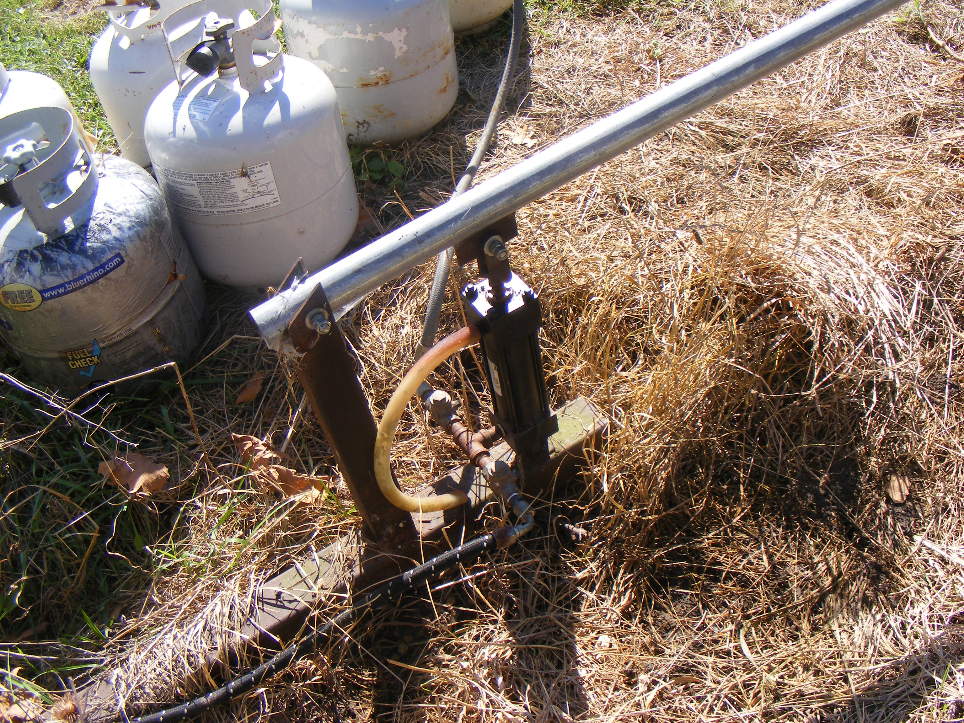

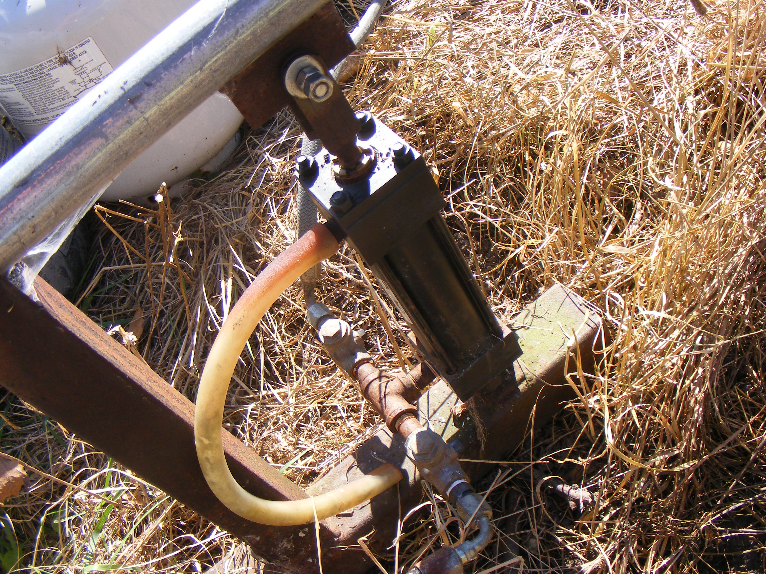

DSCF1131.JPGDSCF1132.JPGDSCF1133.JPGDSCF1134.JPGDSCF1135.JPGDSCF1136.JPG The liquid line comes out of the big tank, it pushes itself past the first check valve and fills the air cylinder with liquid when handle is lifted. When pushed down that first check valve closes forcing the liquid to go out the second check valve into the small tank and the second check valve closes stopping the liquid from flowing back out the way it came in. The handle was made from chain link fence post and the rest is just what I could find. I use a bathroom scale and crack the bleeder open to watch for liquid. Most tanks empty are 18 pounds, and you can add 20 pounds for the gas ,puts you at 38 pounds full and spitting at the bleeder, I am happy at 34 to 35 pounds ,better less then more. The new over fill protection valves with the outside threads have a valve inside them like a toilet tank and shut them self's off at 80% full. This works for me , I am not recommending it for anyone else , I wear eye protection and rubber gloves, this stuff is like Freon, burn your skin numb.
/ Portable Generators #187
Thanks for the pictures. Is that a repurposed hydraulic cylinder you use for the pump? :D
Is that a wet leg on the big tank? It looks like it comes out the top. Is there a dip tube inside the tank?
It looks simple enough. Are the rubber gloves for when you disconnect?
/ Portable Generators #188
It is a Parker Air cylinder . I cant see any reason a hydraulic cylinder would not work.One thought is do not get much larger then this cylinder because you will not have enough weight to push the handle down.Try to fill the tanks early on a cool morning, about 2/3 of the gas will move on its own and you only pump the last gallon, high noon and hot it makes a lot more work. Yes, there is a pipe that goes to the bottom of the big tank making it a wet leg . When you unscrew the valve at the 20 pound tank there is some liquid released so the gloves stop the freezing of the skin.
