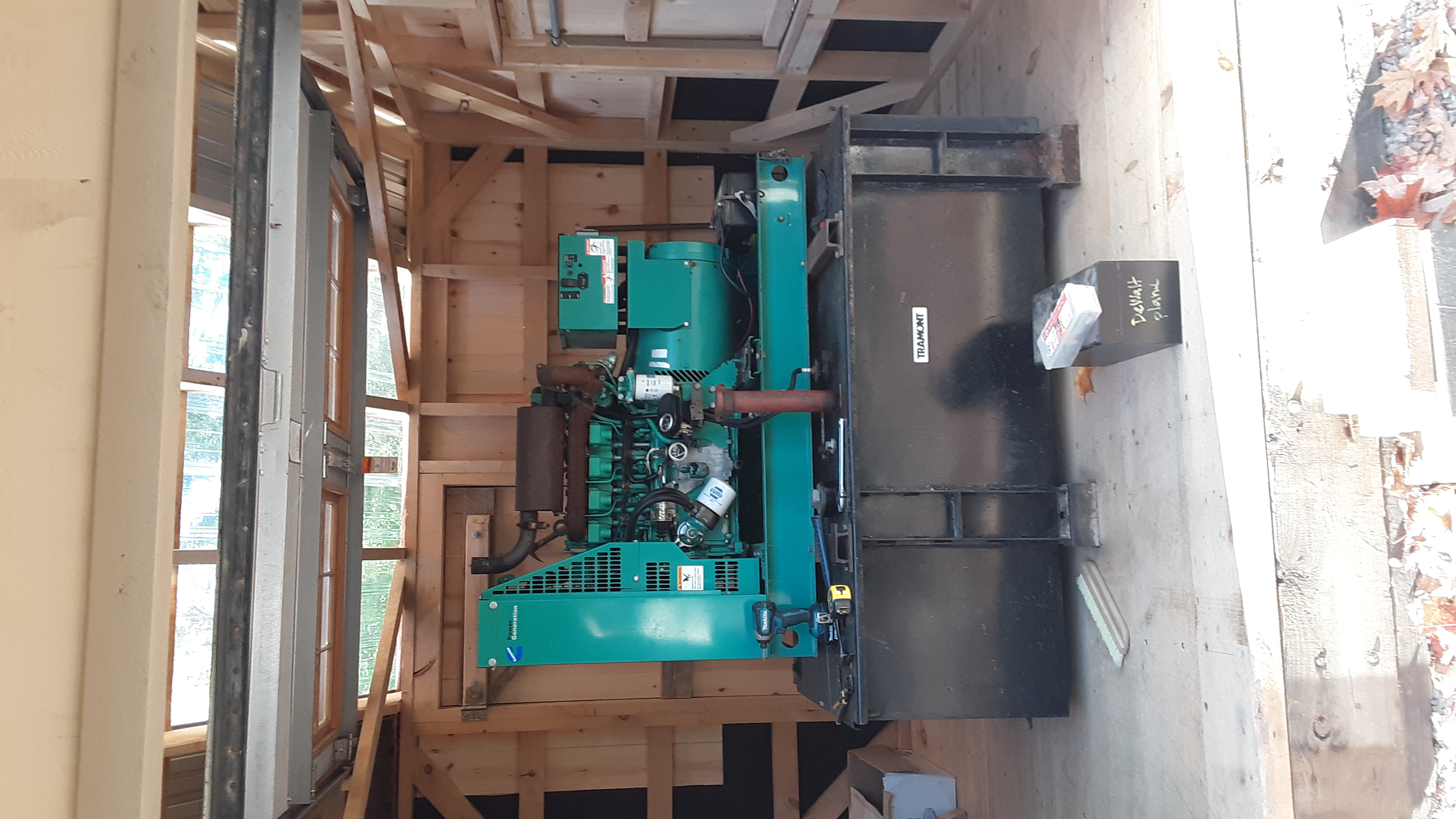

I found this 20kw - 1050hrs for $4500 but I needed to build an "enclosure " that ended up being a small building 9x10. The place had a bunch of lp or ng take outs with a steel enclosures for sale but like you, I wanted diesel and always have plenty of that on hand. 20201008_155306.jpg

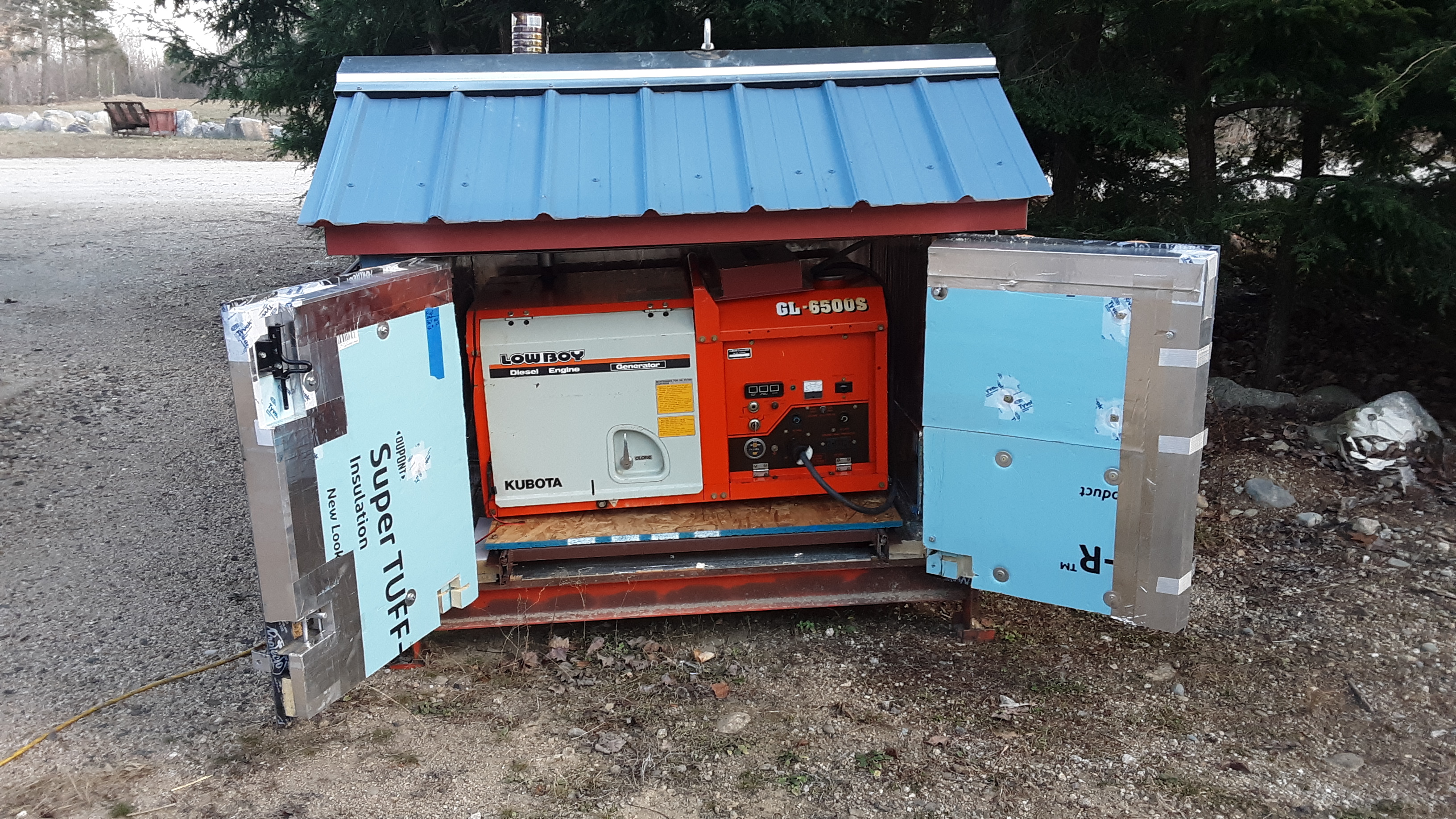

This little kubota "low boy" was my first shot at a diesel standby power set up and by all estimates should have been enough power @ 6500w for our needs. I may have been imagining it, but I heard both the generator and appliances complain during start up and when considering the cost of stuff like 500' deep well pumps, freezers and refrigerators. Not to mention the Mrs. wanted a more permanent installation that only required throwing a few switches. 20201118_151933.jpg
Iirc I paid (used) about $3500 for it and I built the little dog house it lives in.
