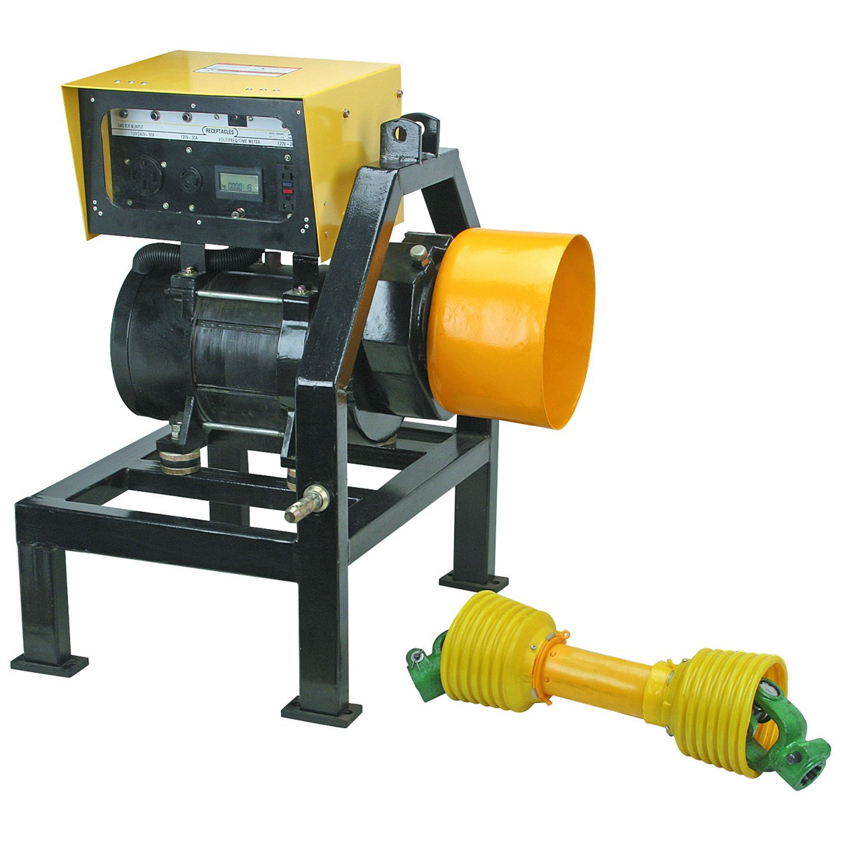

I retired my 7kw gasoline generator last year. The 2 short list generators were a Kubota 11kw diesel portable, or a 15kw pto generator. I ended up with the pto generator.
Diesel generators are going to take a big chunk out of an $8k budget.
/ Portable Diesel Generator Recommendations? #24
Yep. About $1,500 for a 12kW unit. PTO from 480-RPMs to 540-RPMs.
NorthStar PTO Generator 13,000 Surge Watts, 12,000 Rated Watts, 24 HP Required
Error | DNS Resolution | Northern Tool + Equipment
My tractor has a multi- 4-speed PTO, so, I can tune in 540-RPMs as low as 1,100-RPMs engine. That's at a nice quiet idle or with a higher demand for 1,900-RPMs engine to get to 540-RPMs PTO. Better than WOT on the tractor to get to the PTO 540-RPMs at 2,600-RPMs engine.
My machine just sips fuel very easy. So, the power would just keep coming.
IF you want the PTO generator portable, then this is the setup for the SAME PRICE of $1,500.
Chicago Electric
16000 Max Starting/15000 Running Watts Tractor-Driven PTO Generator
16 Max Starting/15 Running Watts Tractor-Driven PTO Generator
