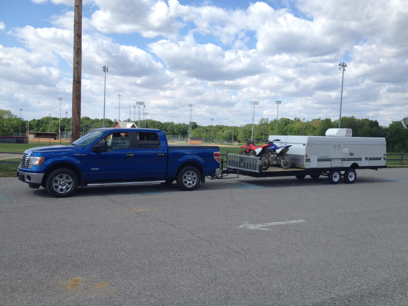

Good story. You obviously had too little tongue weight to cause sway. I should not have that problem. My problem will be payload related on the tow vehicle. I have an 1800 lb payload capacity that I don't want to exceed. This tongue weight would prevent me from hauling anything in my truck bed. Here are pics of my tow capabilities. 2011 f150 ecoboost screw.

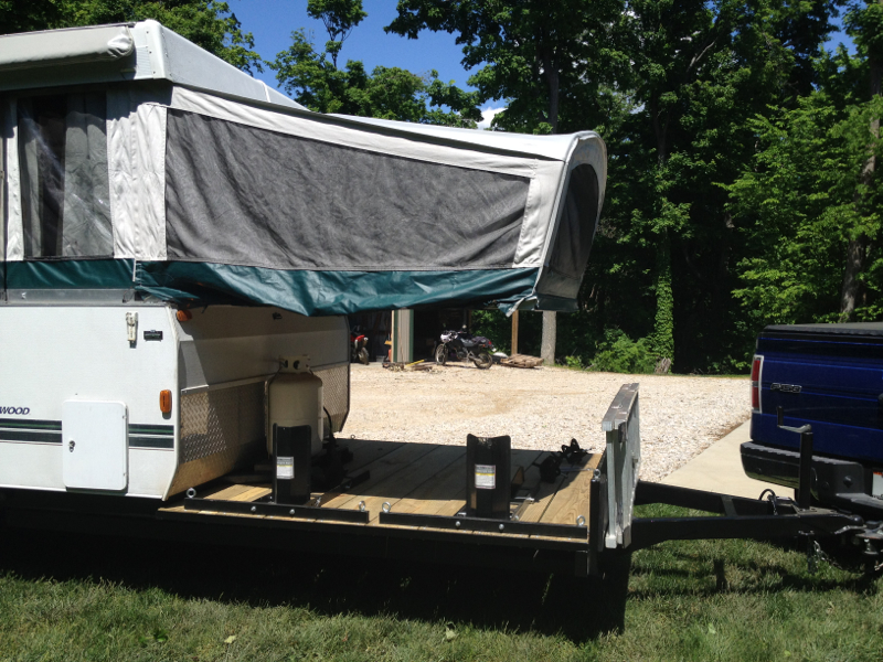

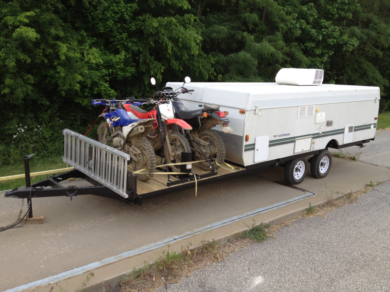

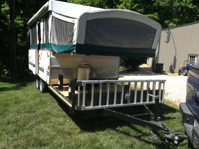

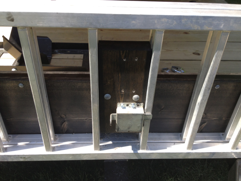

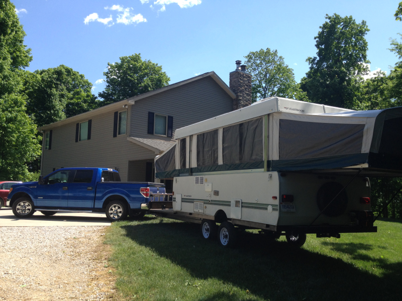

Well I have finally finished this project. I added a second 3500 lb axle directly in front of the existing one. Taking it out this weekend loaded down. Going to weigh it Sunday if I have time.

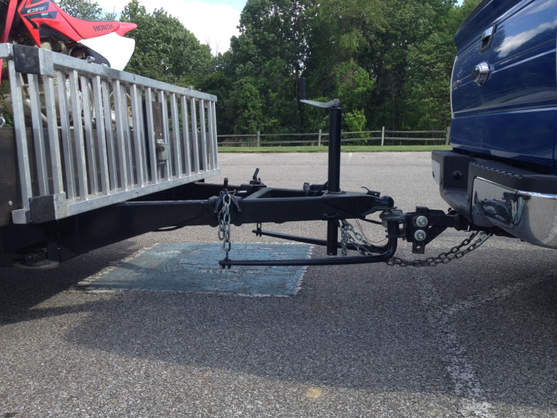

I just returned home from the first trip with the camper. Traveled about 4 hours hitting speeds up to 70 mph. Towed great and it was tested on some pretty rough roads and bumps in a construction zone. I now feel good about the setup. I also was able to get to the scales before unloading. Total weight was 5020 with 4040 on the axles and 980 on the tongue. This was with 3 motorcycles on the trailer and trailer packed with all gear, food, cooler, etc.
I also weighed with the weight distribution hooked up and it added 140 lbs to that 4040 axle weight. Thought that would interest some.
