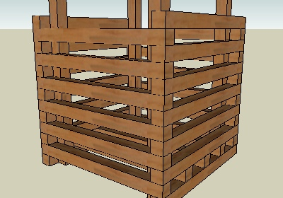

If you really want to use all wood, you could build a dock crib, and fill it with stone. But I agree, the flat iron plates work quite well and are very simple, especially for a dock on a pond with no wake or rising water levels to deal with.

I dont think I really have much depth to build the dock crib. Nor would it be worthwhile I dont think. This is in my shallow end of the pond. And out about 8' where the dock is going to end, water is only about waste deep.
