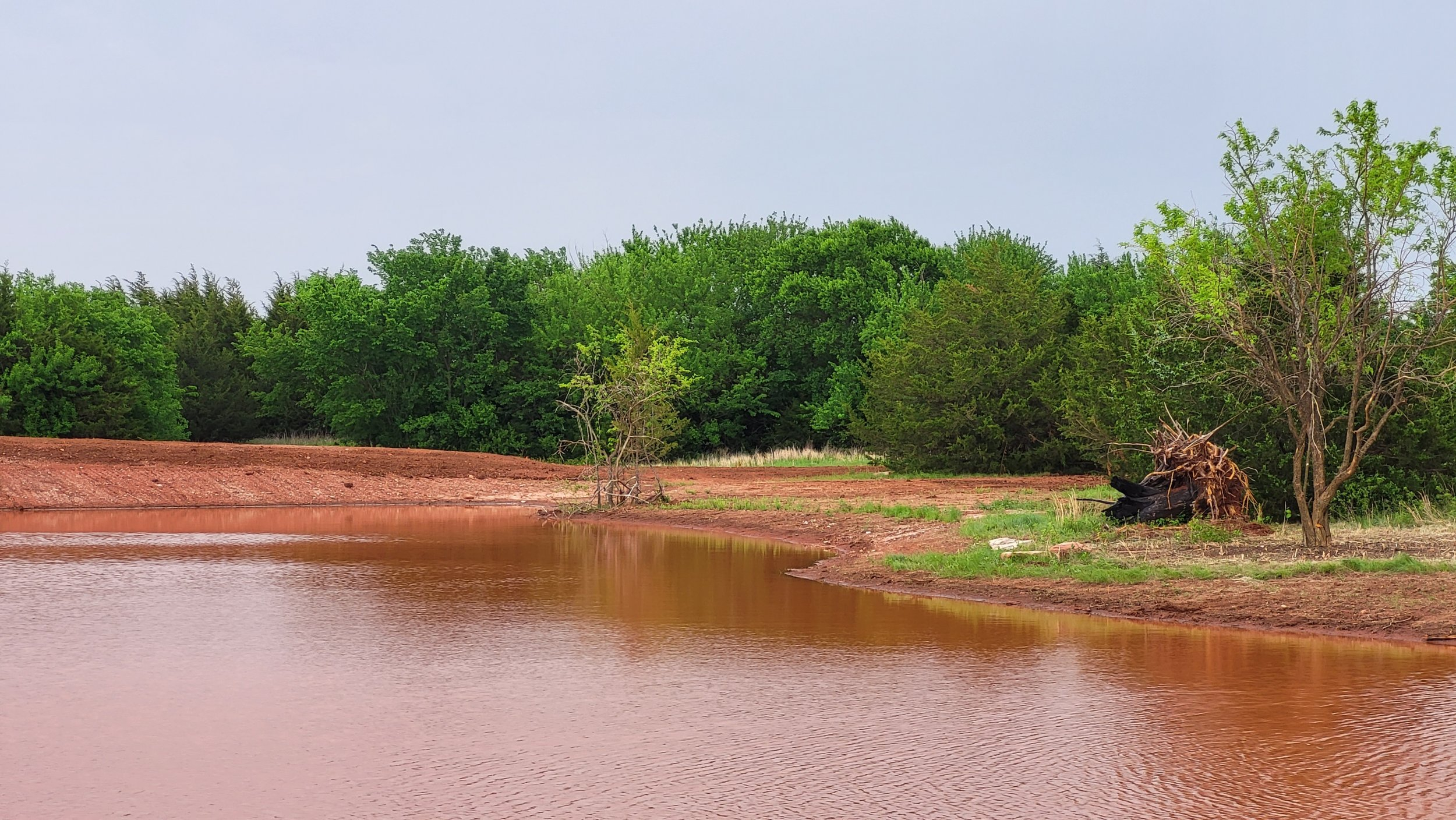

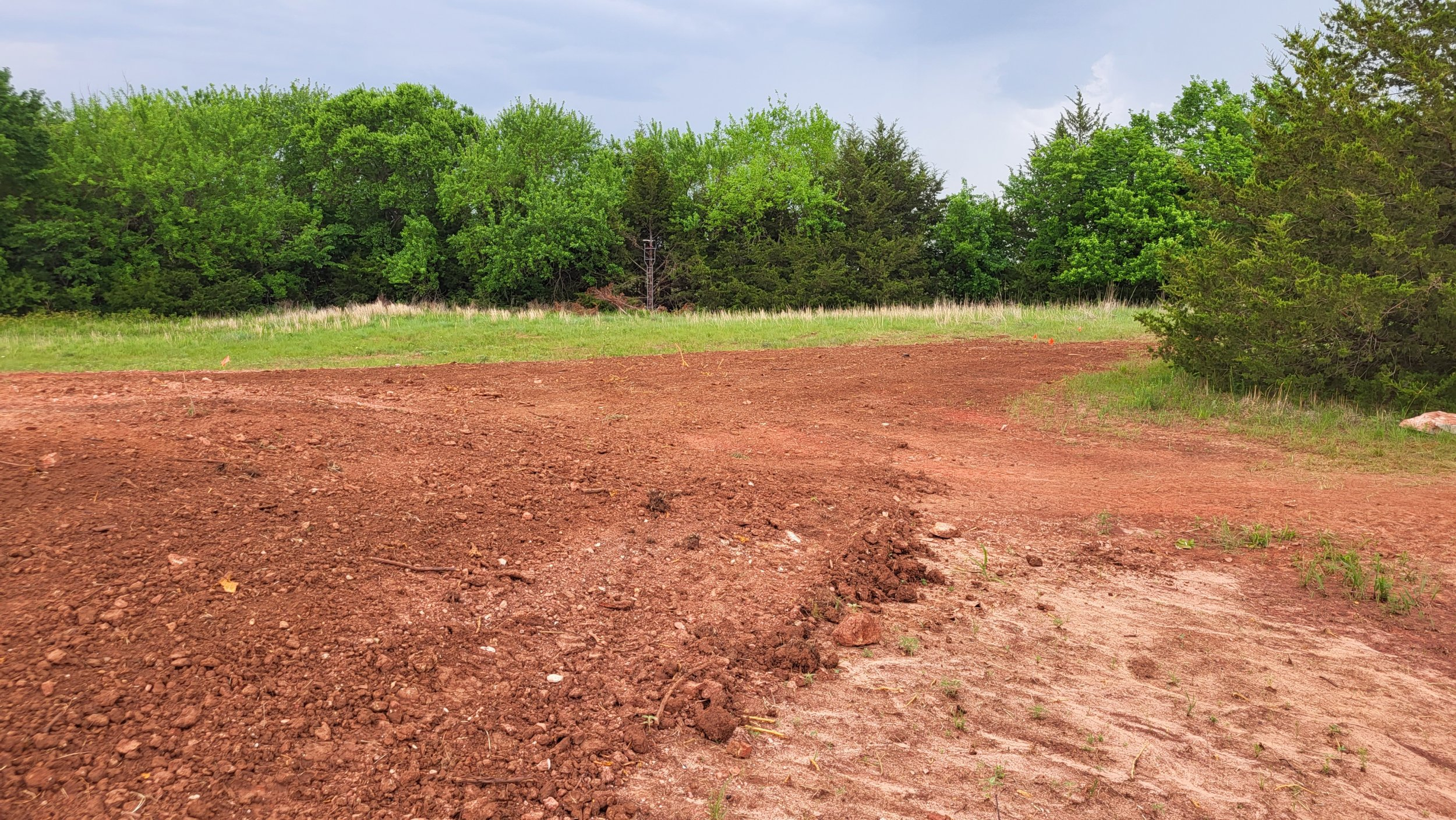

Here are some pictures of the spillway, hopefully you can tell what it is :)
I leveled it out with the box blade a few days ago. Just spread grass seed this morning. Will be spreading grass clippings over it today before we get some rain (hopefully).
First pic is from the opposite side of the pond. Second is zoomed in on spillway. Last few are taken up close.

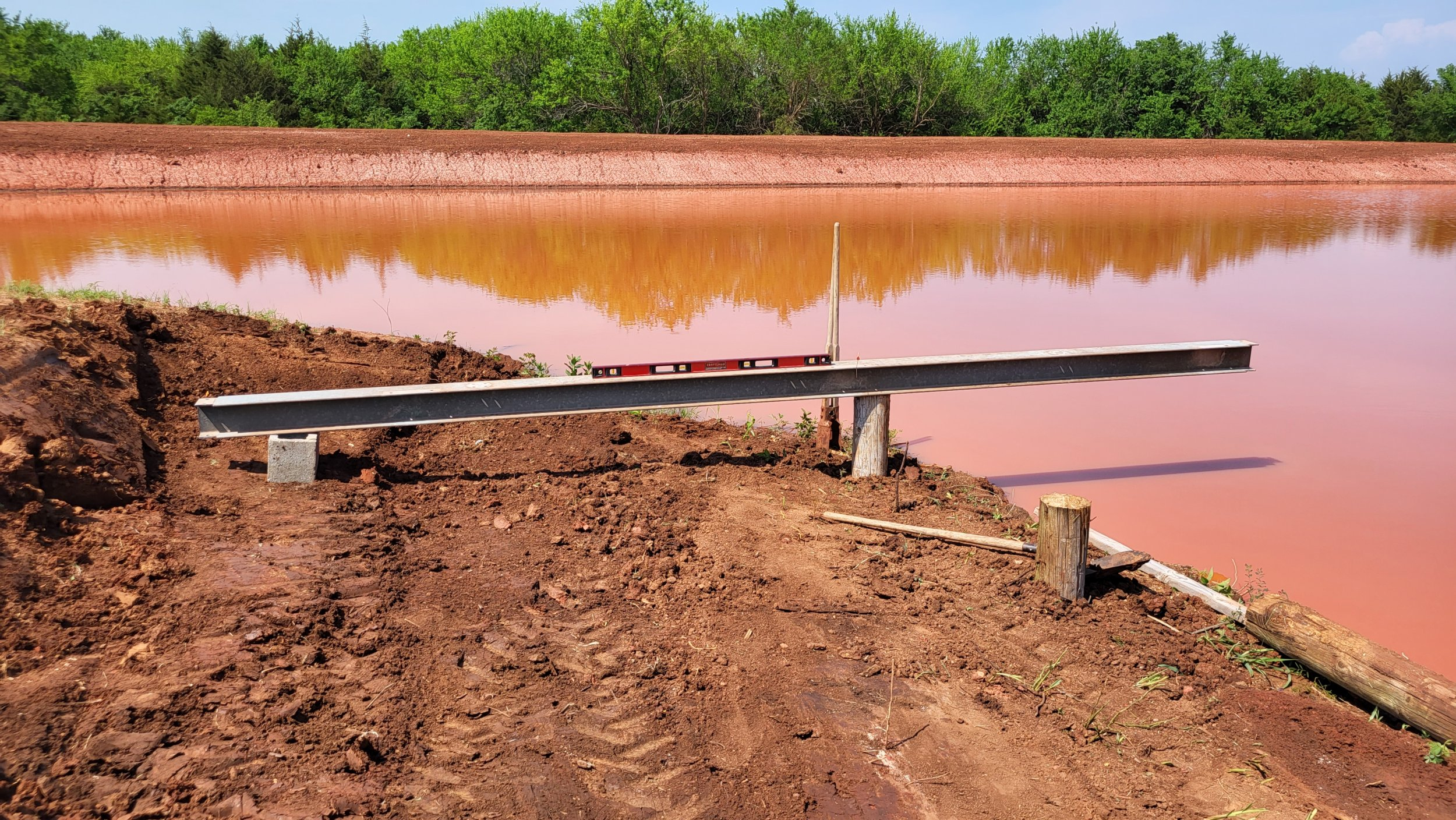

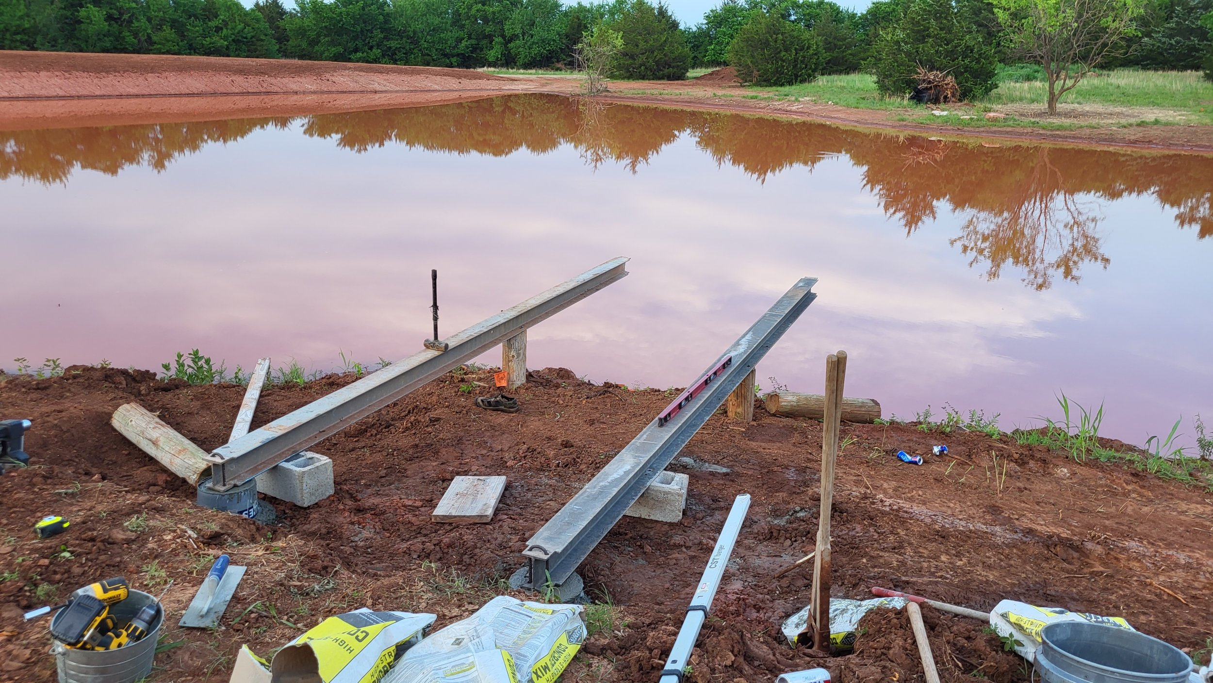

Got started on a dock yesterday, my brother stopped by and helped for a bit. First one I've built, I made it up on the fly using materials I already had sitting around, so don't be too critical please :)
I've got an old deck from a pool that was taken down that I've been saving for a project... I think that material will work good to cover this. Final dimensions will be about 8' wide by 18' long. When the pond is overflowing the bottom half of the I beams will be under water.

Biggest mistake I made on my pond was not building a dock. Now I keep thinking of ways to do it, but I never seem to have the time, and then I think of another way to build it, and nothing happens. It's one of those projects that should have been done a long time ago.
/ Pond Build #50
Eddie, build a floating dock in your shop area during the winter, after dark. Then just put in two posts in the water to position and let if float with the water level.
hugs, Brandi
