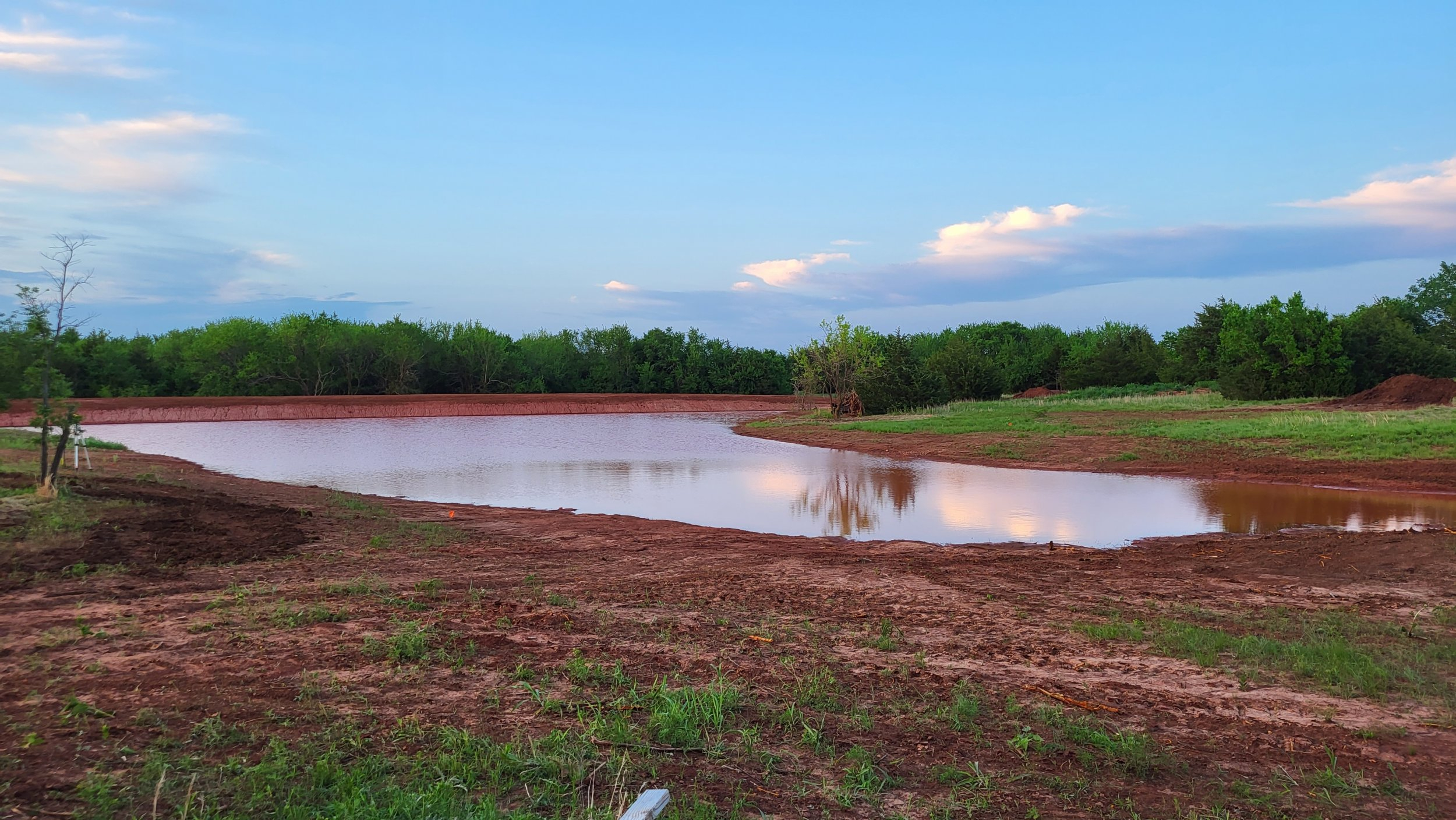

Well, right now I suppose they are on a diet. My plan is to go get some minnows later today at a nearby bait shop.
I was told I can throw some dog food out as well, anyone have input on this? I don't want to commit to doing that on a regular basis so I wasn't sure if I should do it at all.
/ Pond Build #62
Dumping minnows in it is a good idea especially at first, insects and amphibian will eventually start using your pond so they will feed off them. I wouldn't be too worry about it if I where you worse case they will eat each other. Fish will eventually be introduce into it from fish eggs being stuck in birds feathers, life will prevail.
/ Pond Build #63
When buying minnows, you need enough for them to be able to reproduce before the predators you put in there, eat all of them. When I stocked my pond, the Biologist that sold me the fish said to not put any predators in there until the minnows had spawned at least once. Just off of memory, which isn't very good, I think I put in something like ten pounds of minnows for every surface acre to get it started. I think each bag had five pounds of minnows in them, and the front of my truck was full of those bags!!! You also want the water to settle and algae to start growing, along with aquatic plant life, so the minnows will have something to eat. The fish you put in there will be dead in a few days. I put minnows and bluegill in my pond the first year, and the second year, I put in the bass.
/ Pond Build
#64
So would it be too soon for minnows now? There's only a few spots with any vegetation at all, where some grass was growing before it filled up so now it's under water. A fish truck will be nearby this coming Thursday the 9th so that'll be a good opportunity to get minnows if you think they'll survive.

Yes, it's too soon. You want algae and plants growing before you put minnows in. They need to eat to survive. Water clarity will decide when this happens. Once you get your first aglea bloom, you should be fine putting minnows in there. You can add bluegill at the same time if they are really small. Mine where about the size of a nickel when I put them in.
Be very careful with a fish truck. They have a well deserved bad reputation of getting rid of stuff they don't want when delivering fish.
You need to find a Fishery that you can go to and buy your fish from. This is the only way you will know what you are getting. Anything else is a gamble. As an example, this is where I bought my fish from for both of my ponds. I know several guys from Pond Boss that also buy from there. https://tylerfishfarm.com/

So great. Very awesome that the kids are already bombing off the dock. Do they come out of the water with some orange tinge? What's the expected timeline for water clarity?
