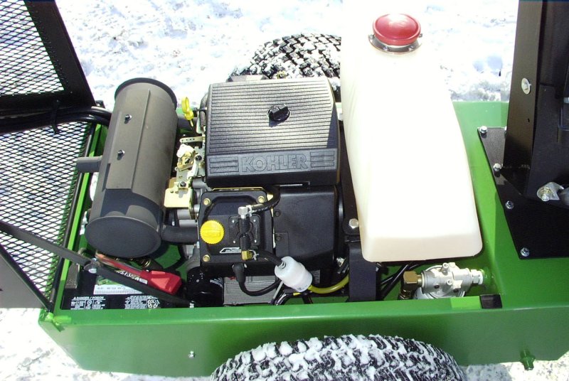

This is my 2001 model year PT425.
Note the variable volume pump is in front of the engine under the gas tank, the FEL and AUXPTO pumps are behind it, hydraulic filter in right front corner, the fuel tank is under the hood and the battery is under the muffler on the right rear side. Note the factory Kohler muffler exhausting out the rear. ZERO heat problems.
429124-poll-subaru-vs-kohler-pt425viewenginecompl-jpg
429125-poll-subaru-vs-kohler-pt425viewenginecompr-jpg
Below is Pajoube's 2003 (I believe) model year PT425. Also a Kohler.
Note that his has the engine rotated 180 degrees from mine and is located completely to the rear of the tub, all of the hydraulic pumps are in front of it, the fuel tank is built into the rear of the lid, the battery is raised above the hydraulic pumps and the hydraulic filter is on a riser for easier access. Note the muffler (Power Trac fabricated, I believer) location and the muffler wrap.
429128d1433990183-poll-subaru-vs-kohler-pajoubes-425-1-jpg
429131d1433990312-poll-subaru-vs-kohler-pajoubes-425-2-jpg
Can someone post some pictures of later model years with Subaru's for comparison?
