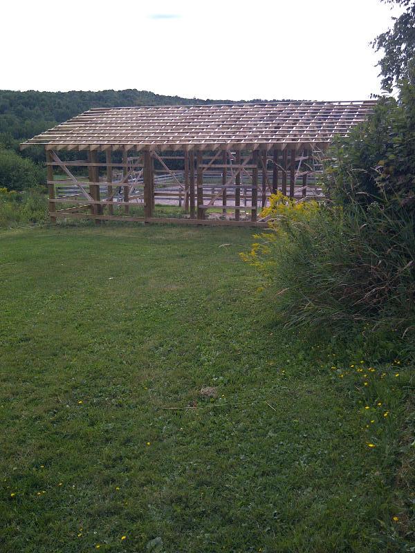

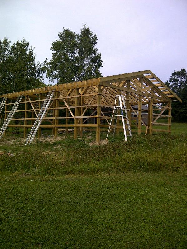

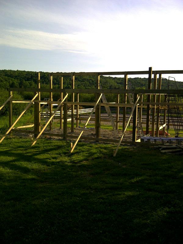

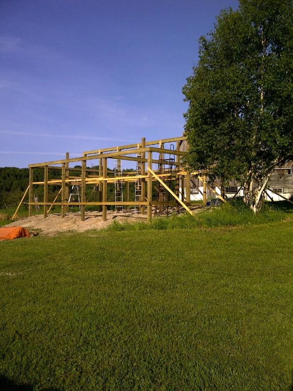

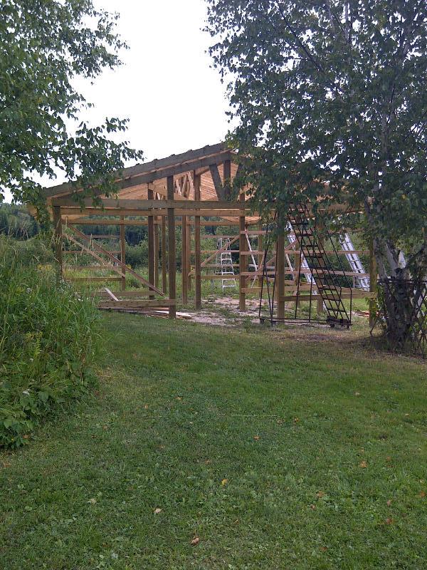

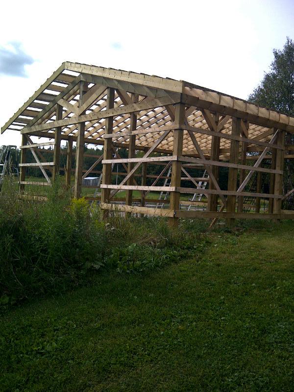

Almost finished the Framing on the pole shed, my 13 yr old son and I are building this, our first big construction project.
here are some pics of our progress.
Framing will finish this weekend , ill get it inspected, then start the Roof Metal

Thanks, re the "a lot of work" , yes for sure, ours is similar in size 26 x 34, I used 2x8 rafters and putting those up (over 60 of them) was a real PITA.
I bought a couple of safety harneses too while we were up doing the roof, better safe than sorry.

Why post down the middle instead of trusses? :confused:
I needed large supporting center posts any way given the strength i needed in a dividing wall (horses). So I went with Rafters and ridge beam on top of the Center posts. I also get a wack of added head room on each side which Id lose with trusses.

I like the nice big overhang on the gable end, keeps the rain off the siding. Did you hold down the last rafter and put the lookouts across it, or are they nailed to the face of the last rafter?
/ Pole Shed update #10
Thanks for the update
/ Pole Shed update
#11
The Lookouts are resting across 2 rafters that are sistered up, i call these shoulder rafters, the top of these 2 sits level withthe bottom of all the others. The shoulder rafters (4 on each end of the barn) also sandwich the 3 6x6 posts that also make up the droor way and center post. Should be pretty strong. All Rafters are 2x8
