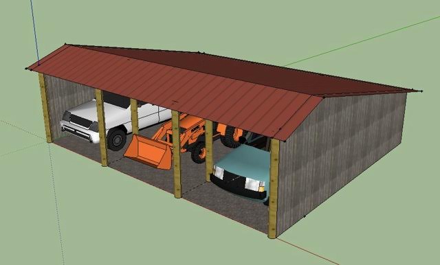

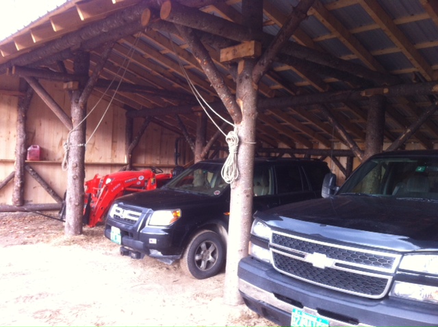

I did a posting in January about a pole shop and shed I built last summer. I used logs from the property, with the help of my tractor of course. I'm taking on a bigger project building a 24x36 carriage shed using the same construction.
Here's the plan:
attachment.php

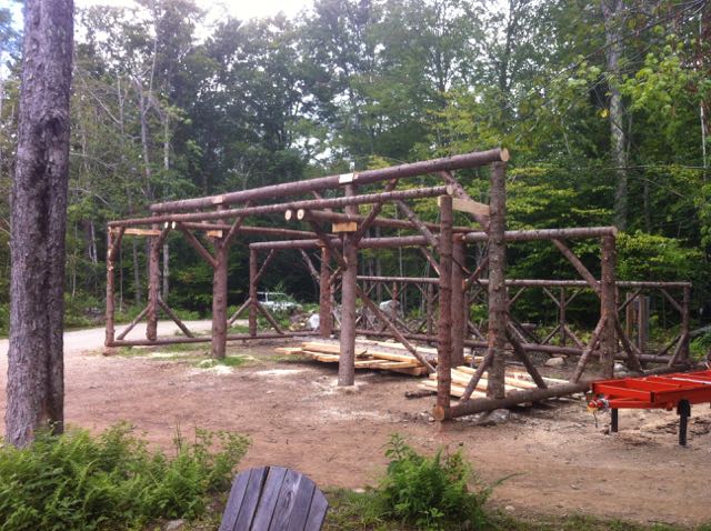

Here's what I've done so far:
attachment.php

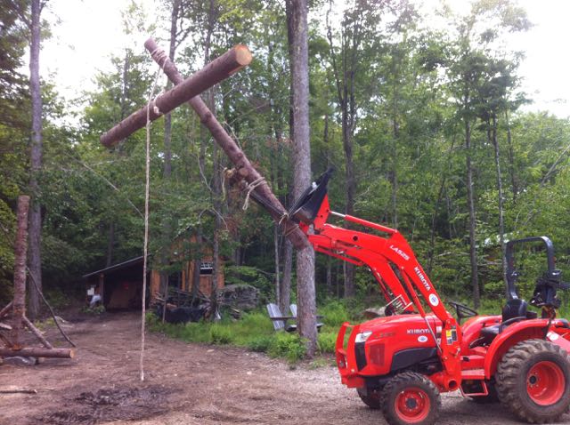

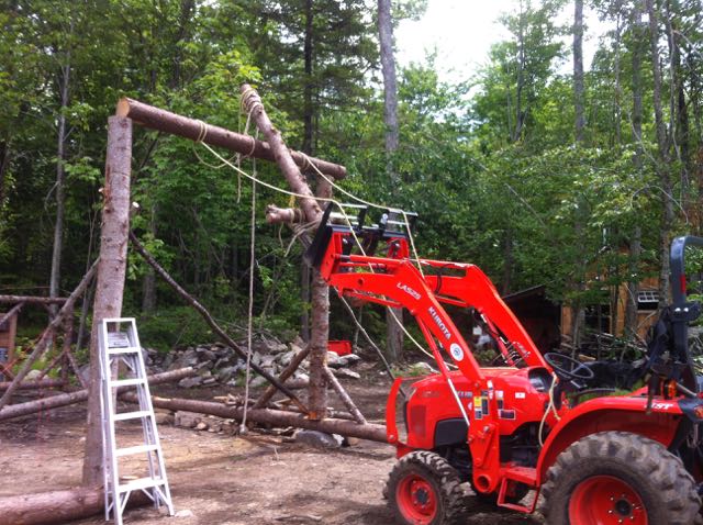

The tractor has been key in getting the big logs into place. I can't say enough how much I appreciate my pallet forks but they wouldn't reach to the top of the ridge to place the beam. Here's where I'll probably get in trouble with the safety police but I got creative and made a boom to put up the beams.
attachment.php
attachment.php
It does look pretty hokey from the picts but it worked great. The yellow rope made it so I was able to position the beam from the seat of the tractor.

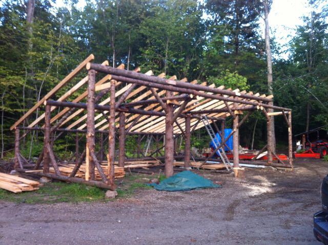

Working with the tapered logs is pretty easy. For the horizontals I level the taper and measure from the underside to the sill and cut the posts. I plumb bob the verticals along their centers. I put strapping on the posts for the siding. I only have to chainsaw or hatchet the 3" spot where the strapping attaches to make sure the strapping is in the same vertical plane. Pretty easy once you start thinking that way.
Got the back rafters on. Hope to order the metal roofing next week.

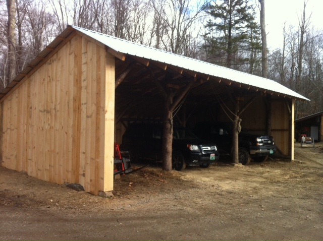

Finished up the shed with siding milled from the property with the portable mill. Did metal roofing and put in lights and outlets. All set!

It appears you have some logs in the ground. What were your thoughts about the risk of them rotting?
