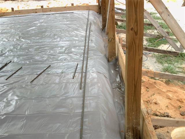

#72
Next we covered it up with 6mil plastic. :confused: One thing I don't understand is "Why is the black plastic more expensive than the clear plastic?". I opted for the clear stuff not seeing paying more for the same thing in a different color. :) When I started rolling it out I noticed it was grey:confused:. I guess I got a good deal!!!:) :D :p ;)

#73
Next I drilled an 1-1/8" hole through each post and sleeved them with pvc pipe. Then I ran #5 rebar through the sleeves and continued the rebar around the perimeter. Then I laided down standard wire mesh around the perimeter.
