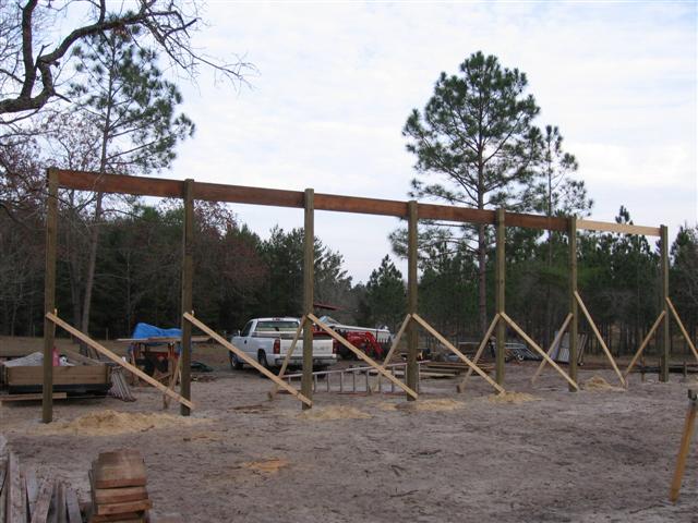

Here is a shot of all the trusses set. It makes my compact tractor look like a riding mower. /forums/images/graemlins/grin.gif

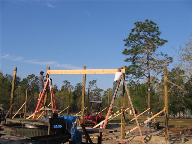

Not a bad weekend. Next, more truss bracing and roof purlins.Here's the last photo for now. It is my favorite picture of the project, so far. It is taken from the NE corner of the building.

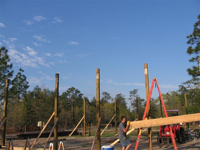

Slowly making progress. I have all the purlins on. Still need to finish the facia and some more truss bracing. The hardest part of this project has been installing the purlins. I was planning on installing the purlins the day after I set the trusses but something came up and it was a week and a half before I could get to it. In that time the trusses developed sort of a "S" shaped twist in them that was hard to pull out. Some of them still have a slight bow in them. Anyway the trusses are up, the purlins are on and its almost ready for tin! /forums/images/graemlins/smile.gif Here is a shot of the east side.

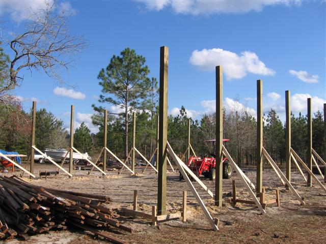

Here is one from underneath.

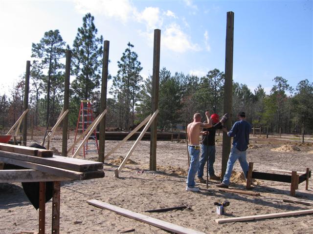

Last one for now. This is a shot of one diagonal truss braces.

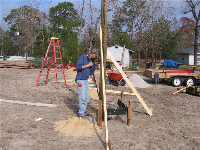

Finally got around to build the overhangs and slapping some tin on the roof. Here is a shot of the overhang and facia.
