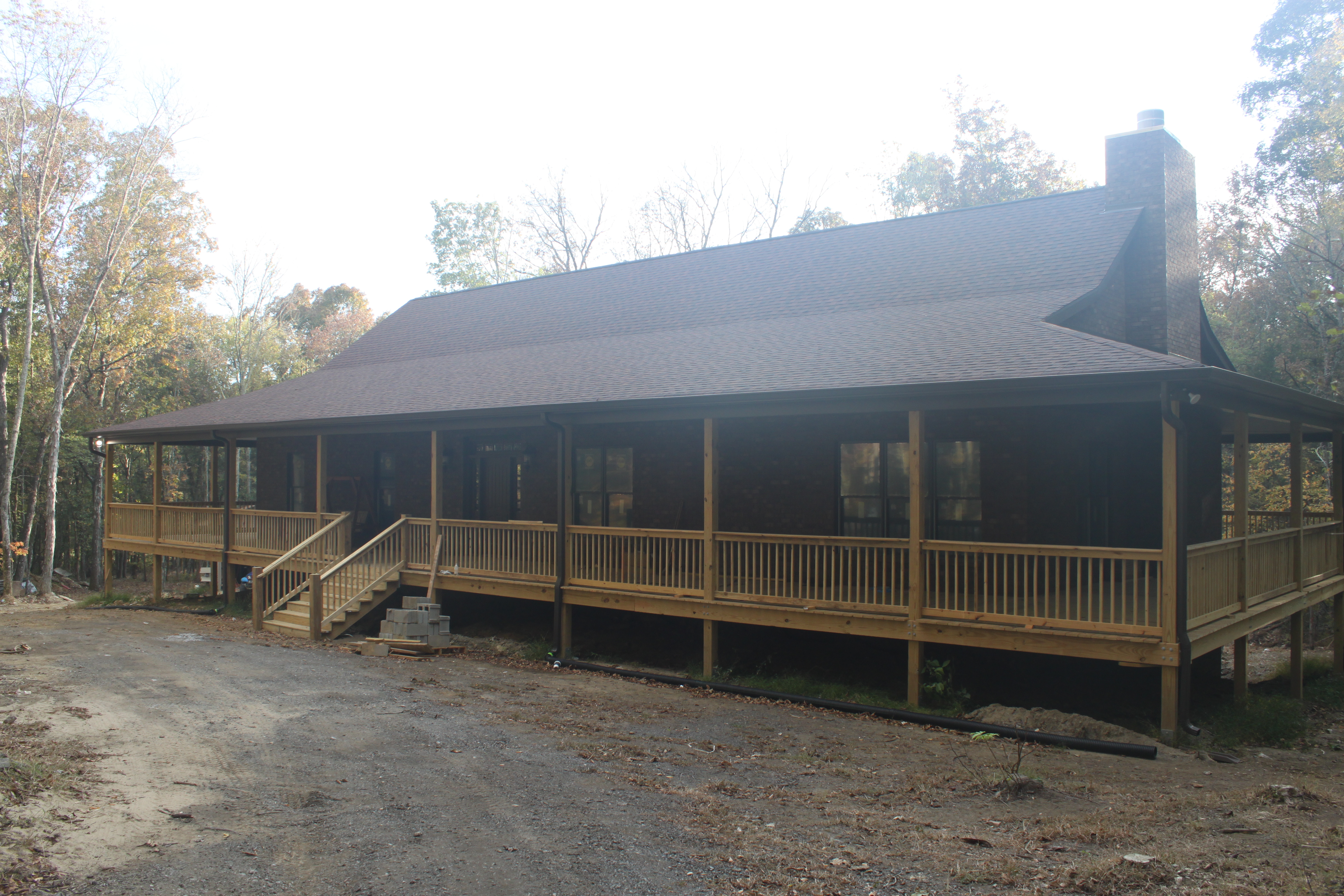

Well, we have not been able to get a lot done lately. Busy schedule but hopefully things are slowing down now. We have got the roof pretty well framed. The metal should be going on next time we can work on it.
PoleBarn Roof by nrc17gto, on Flickr

Well, we completed the roof yesterday. Feels like a major step toward completion.
PoleBarnRoof by nrc17gto, on Flickr
