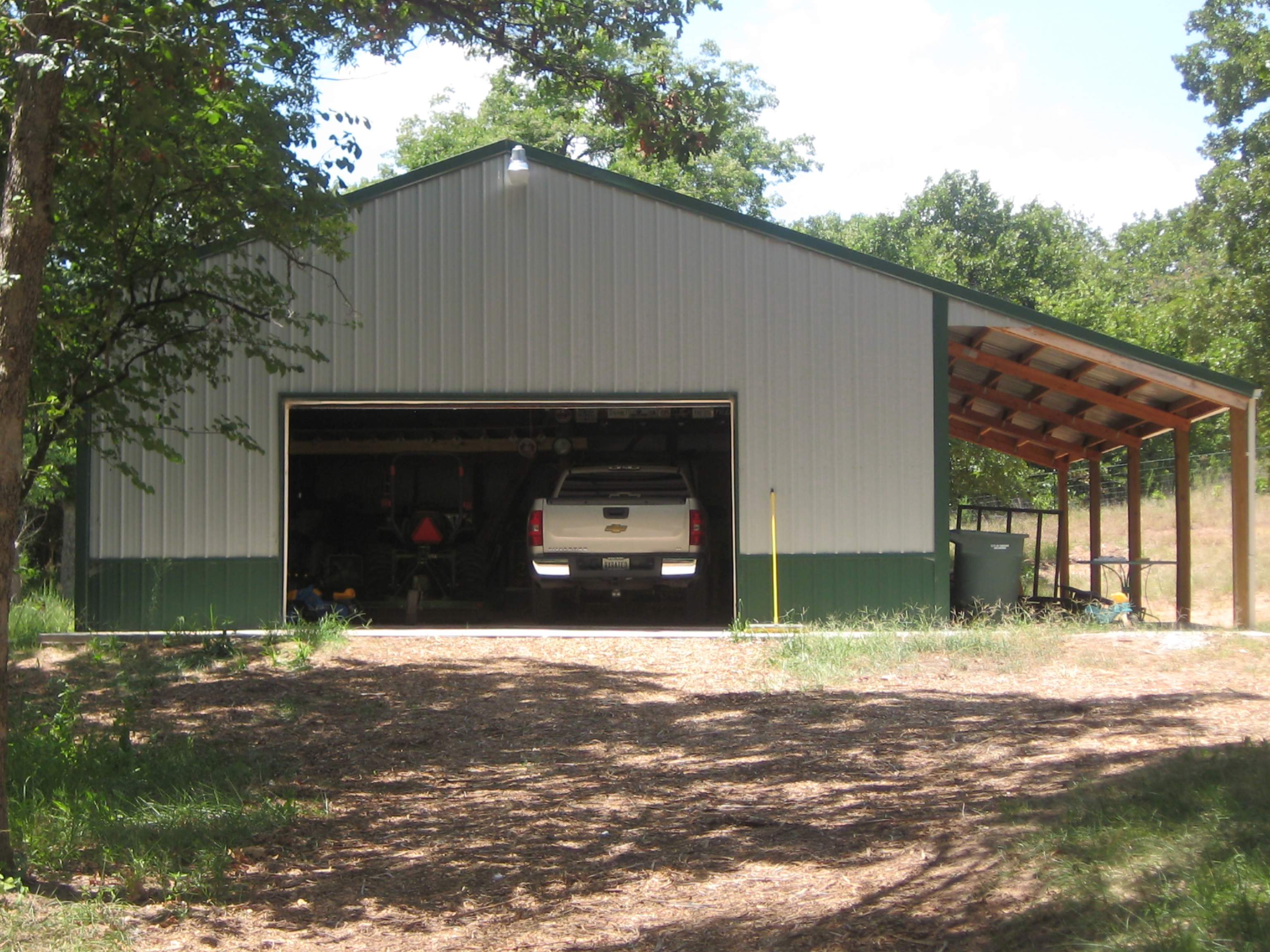

Here is my finished project. They are not that complex of a build, but need to do research for a reliable company.
