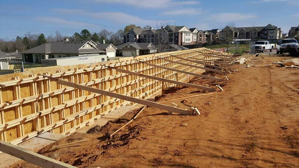

FB_IMG_1513108779900.jpg I just saw this picture on FB and thought it showed what it takes to support concrete with plywood. I'm guessing this is a four foot tall wall. Eight foot would be a lot more work.

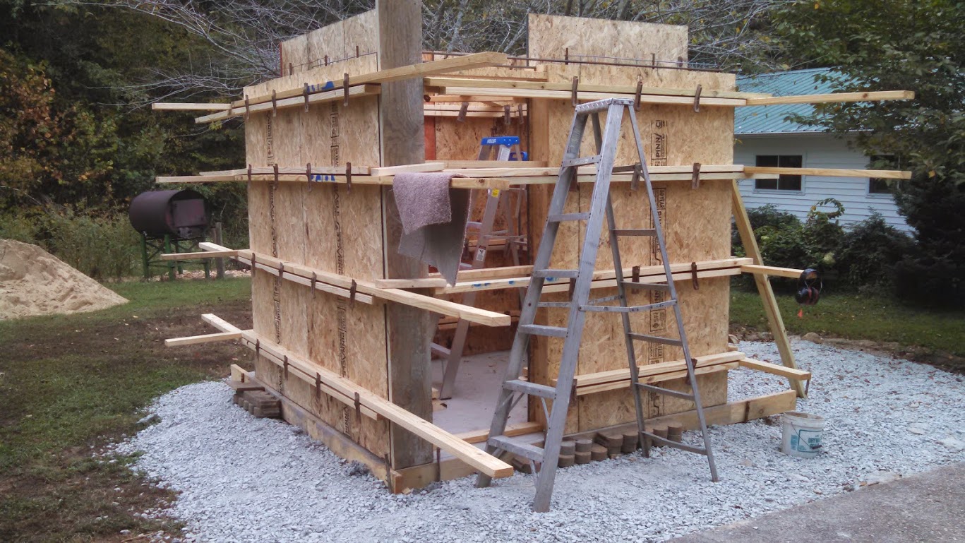

This is my 8' square x7+' high storm shelter wood layout for my storm shelter. It is not complicated but need snap ties and double 2x4s around inside and out every 2'. But can be reused later for other things.
Once the wall is done I pulled it all off and made the roof.

This is my 8' square, 7+' tall storm shelter wood layout. It is not complicated but need snap ties and double 2x4s around inside and out every 2'. But can be reused later for other things.
Did you use any vertical bracing or any legs to keep it from leaning?
I see I have a leaning brace on the back side and maybe one other side.
All the horizontals 2x4s, which I overlapped at every corner inside and out, made it very sturdy.
Once one side is set level and plumb and nailed together by those horizontals they hold up very good. I believe I nailed in corner to corner 2x4s to help keep it square.
I did not put vertical double 2x4s like someone else's picture showed, but this worked out nice anyway with no bulges in plywood. The hardest part was knowing someone who would let me use the snap rod connectors.
