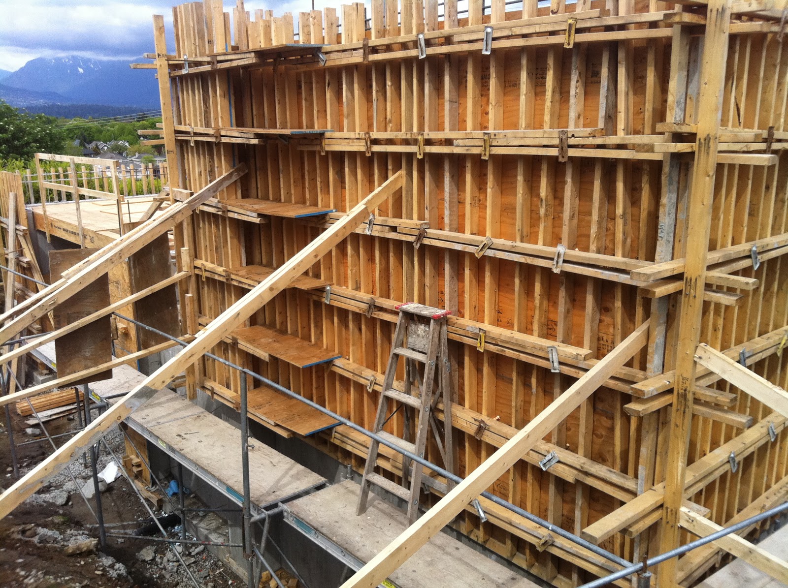

It takes a lot of bracing to form a wall using plywood.

Yep it can be used again definitely. Also, other side of the formed wall looks the same. With lots of form ties to hold them together. Just wanted to offer OP an idea what is involved. Concrete will bulge or even knock down the form if given a chance. Better safe than sorry.

Or cross ties between the walls, Forms for my patio retaining wall (6!x4'x24' consisted of 2x4 lengthwise top and bottom, a few vertical 2x4 and a lot of 'snap off' cross ties.

Yes to snap ties. The photo I put up shows lots of snap ties connecting the walers.
