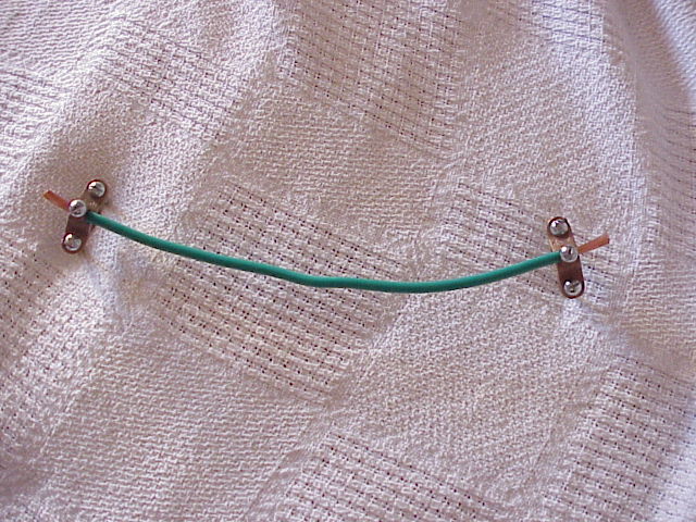

i dont think i understand the safe grounding of pipes thing you mention West.
why do you need to ground your pipes?
when i built this house i used copper for the supply lines and pvc for the drainage lines. the water comes from my well through a black plastic pipe into my basement. sweating copper is pretty easy once you get the hang of it. the most important part is cleaning the pipe and fitting. i had one supply leak after sweating many many many joints in this house and it was very easy to fix.
I thought I knew the answer to this off the top of my head, but I do know that it is code required here and the electrician that re-did all the major wiring on our house insisted that it was very important.
If you purchase in-line whole-house water filters, they will include heavy gauge wire and clams for ensuring the electrical path can make it past the pastic filter assembly.
As to why this is important? I don't know. Maybe it is only for protection against lightning hitting the pipes, protection against the well pump delivering a shock or?
Paging a licensed electrician to answer this question!
/ Plumbing Rant #46
I believe that it is to protect the homeowner in the event that a electrical were were to short out to the copper plumbing pipes. If the pipes are grounded, they will carry that errant current to ground. I just purchased a whole house water filter, and when I saw that there was no grounding strap included with the filter, I contacted GE to ask why. They sent me one at no charge, along with the fittings to hook up the filter.

so heres my unprofessional take on the grounding/copper plumbing thing.
at one time, before electrical grounding at the receptacle was not a typical installation, many home appliances and electronic devices were grounded to the plumbing. it is a good ground, especially before the widespread use of plastic plumbing. it all eventually ended up underground.
but then electrical codes changed and in houses wired the more modern way the plumbing grounding then became unnecessary.
/ Plumbing Rant #49
When I built my home in 1982, they didn't require me to have but one ground rod at the meter service entrance. When I did a upgrade a few years ago, I had to install ground rods at the generator transfer box, generator, and in the cellar at the main panel, in addition to the one that was at the meter socket. The worse part of all of this was that they wanted one #4 copper cable from end to end. One end was in the cellar at the main panel, and the other end I had to ground it to the well casing 30' from the house. The copper water piping also had to be grounded to the ground rod in the cellar.
Dusty
/ Plumbing Rant #50
No, it doesn't matter how lthe house is wired, grounded receptacle or no, a good electrical ground is still required. I had to have mine professionally installed after I replaced my sewer pipe with ABS. House had already had all wiring upgraded. Should have been done by the so-called electrician that replaced my main panel (changed from fuse to circuit breaker. In my case, it required two long ground rods spaced about 6 ft apart.
