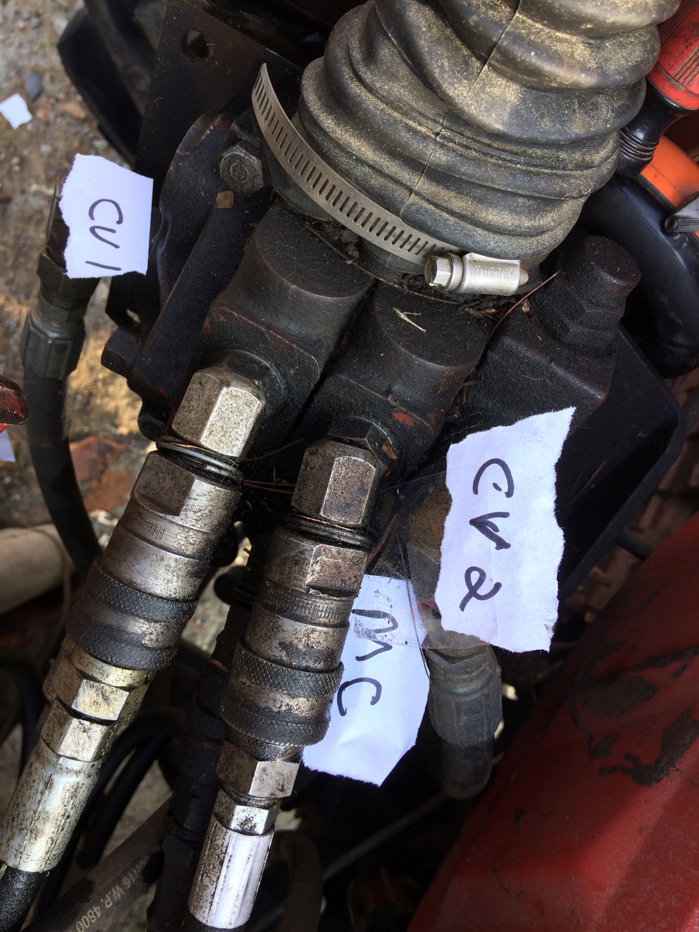

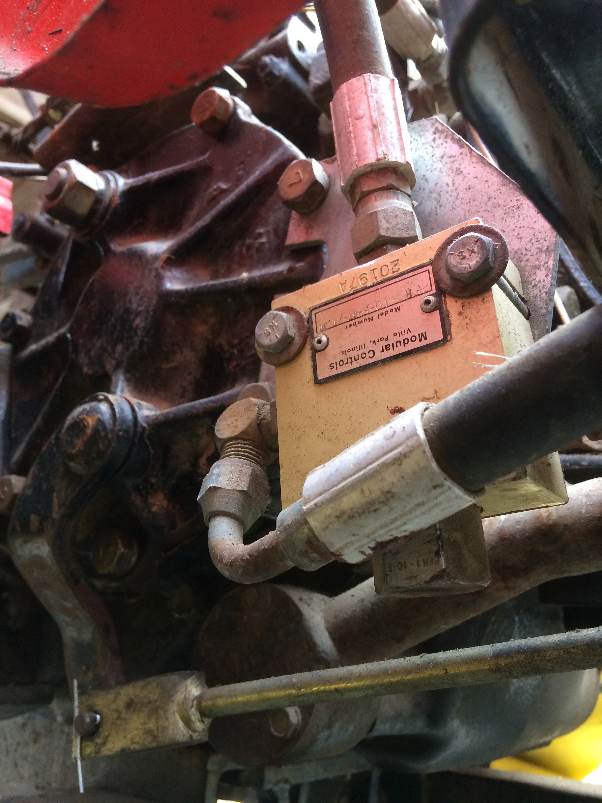

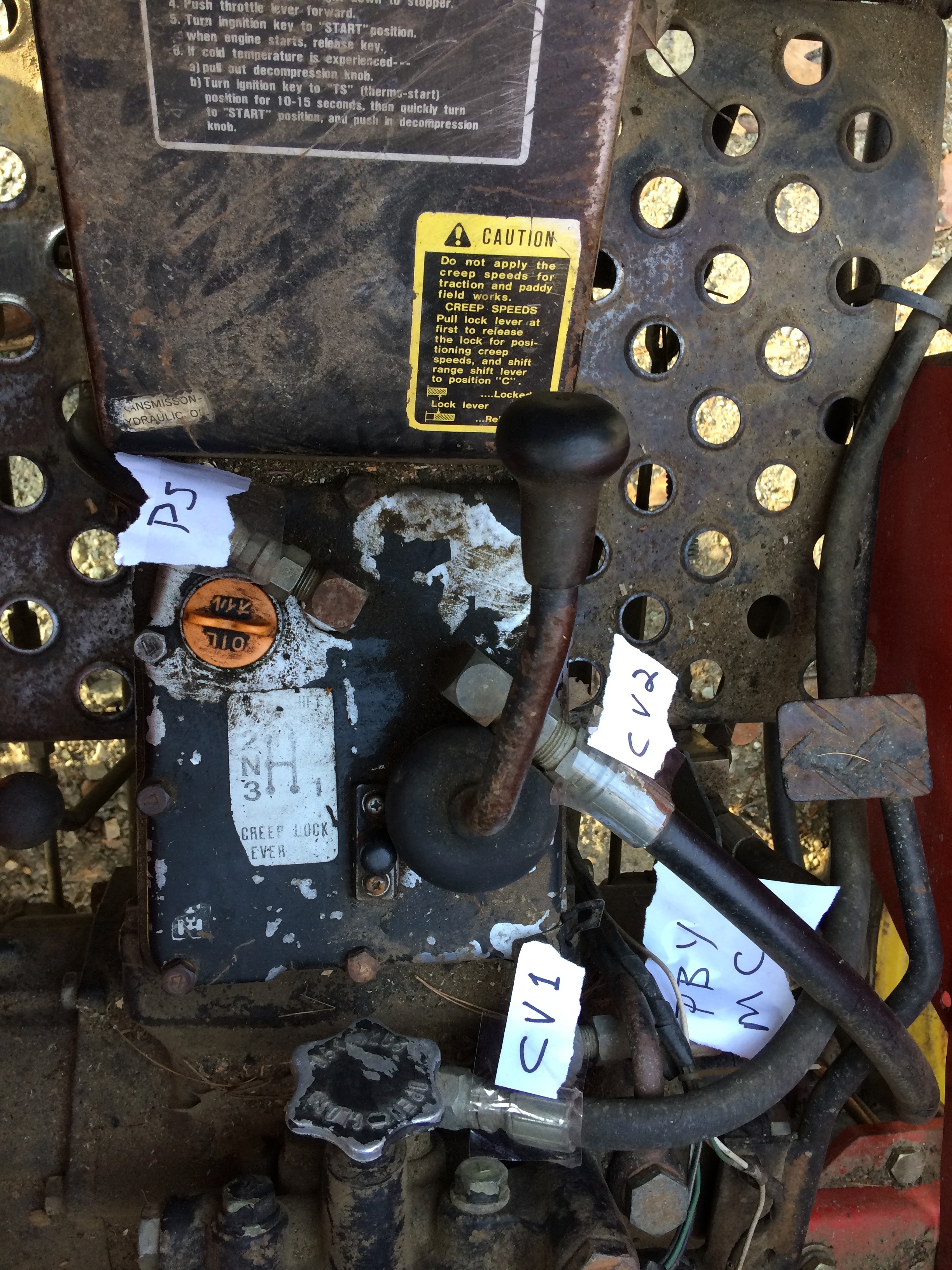

Finally got a chance to get pics of the hydraulic set up. Looks like 3 hoses from the hydraulic cylinder head. Two to the loader control valve (cv1 out and high pressure line? and cv2 return?) and one from PBY or aux Valve? Hard to make out in the service manual pics.
PBY goes to a block labeled modular control valve. Two lines from there - one to the loader control valve and another to the power steering cylinder. There's one line from the power steering cyl to a port in front of the shift knob (return?).
Finally it's a Yanmar loader model YFL 1075.
It's been a great machine. I've put a couple of hundred hours on it over the last ten years mostly plowing snow and getting firewood in. Haven't had a real problem yet. A lot of good advice from this forum.
Grateful for any info leading to my understanding of the set up and the installation of a bolt on grapple and possibly cylinders to angle a snow plow.

Your hydraulics are plumbed using the auxiliary outlets shown in post #2. I am not a hydraulic guru but do feel it is plumbed correctly. Might be expensive but I am thinking you might be better off going with a new loader control valve. Attaching an example. I know you are not going to like the price. I haven't done any shopping or comparing.
The control valve used to go to your power steering and loader valve assures you don't lose power steering when using the loader.

I agree with Winston, it looks like it is plumbed correctly, now that isn't saying you can't change how its done... There are other ways to plumb this set up, however you would lose function of one thing or another during the time you are using another, if that makes sense. I ran into this situation when I added PS to my 2210d with a FEL.

I agree. There are several ways to divert some fluid to run a grapple cylinder. The simplest of all is if you have an unused PB (Power Beyond) port on your existing directional control valve setup. It looks like yours has it.... but it is already in use. You can theoretically daisy-chain directional control valves using the PB from one to send fluid to the next and so on....but you end up spending more money for control valves and hoses while and creating more resistance in the circuit.
I like the idea of replacing the entire directional control valve setup with one that has 3 or more levers because it is the most elegant solution. And by the time it gets installed It might be no more expensive than the rest, too. Remember that hoses cost real money. Cost on a 3 lever DCV is about the $350/400 mark at hydraulic surplus sites like Surplus Center.
If you go that way be sure to match the threads on your existing hoses, and get one with PB. You don't need much flow capacity. Your tractor is probably not flowing 10 GPM at full chat. So realize that the small pump volume of the tractor's onboard hydraulic pump is limited in how many functions it can power at once - if you are working one lever, the others will work too....but slowly.
However...think on this: The downside to swapping to the 3 lever system - or making any changes in your hydraulics flow path is that before changing anything about the flow profile you MUST be determine that if you have power steering that it has priority in flow. Usually that is via a discrete hydraulic priority valve. What that valve does is to makes sure that the steering gets it's required flow (often about 3 gpm) before sending any fluid to the rest of the system. Sometimes there is not a discrete hydraulic priority valve and instead the manufacturer has just balanced the various resistances to flow to accomplish the same thing.
Another possibility that used to be more popular on old farm equipment was to use a selectable diverter valve in one of the pressure lines. Selectable Diverter Valves are just what they sound like, they manually or electrically switch the high pressure flow from one system to another. I've even seen them installed after the directional control valve so that for instance the lever that used to curl the bucket would now work the grapple .... You would then switch back and forth. Prices range from $100 to $500 depending if they are manual or 12v. solenoid actuated. But as has been said, you only get to actuate with whichever system is selected to be getting the fluid at the moment. That's a big downside.
