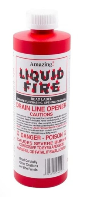

Wonder what that would do to the septic?
I've used it, septic is ok.
From Amazon:
"Liquid Fire provides a powerful, fast-acting solution for both slow-running and fully clogged drains. It works great for drain pipes in sinks, tubs, shower stalls, plus septic tanks and laterals."
/ Plugged up drain. #23
IF you use it...trust me...open window FIRST!
It works but smokes violently. If you have pets or kids I'd get them out the house for an hour or two.
/ Plugged up drain.
#24
Guess if all else fails, and I would have to wait for good weather.

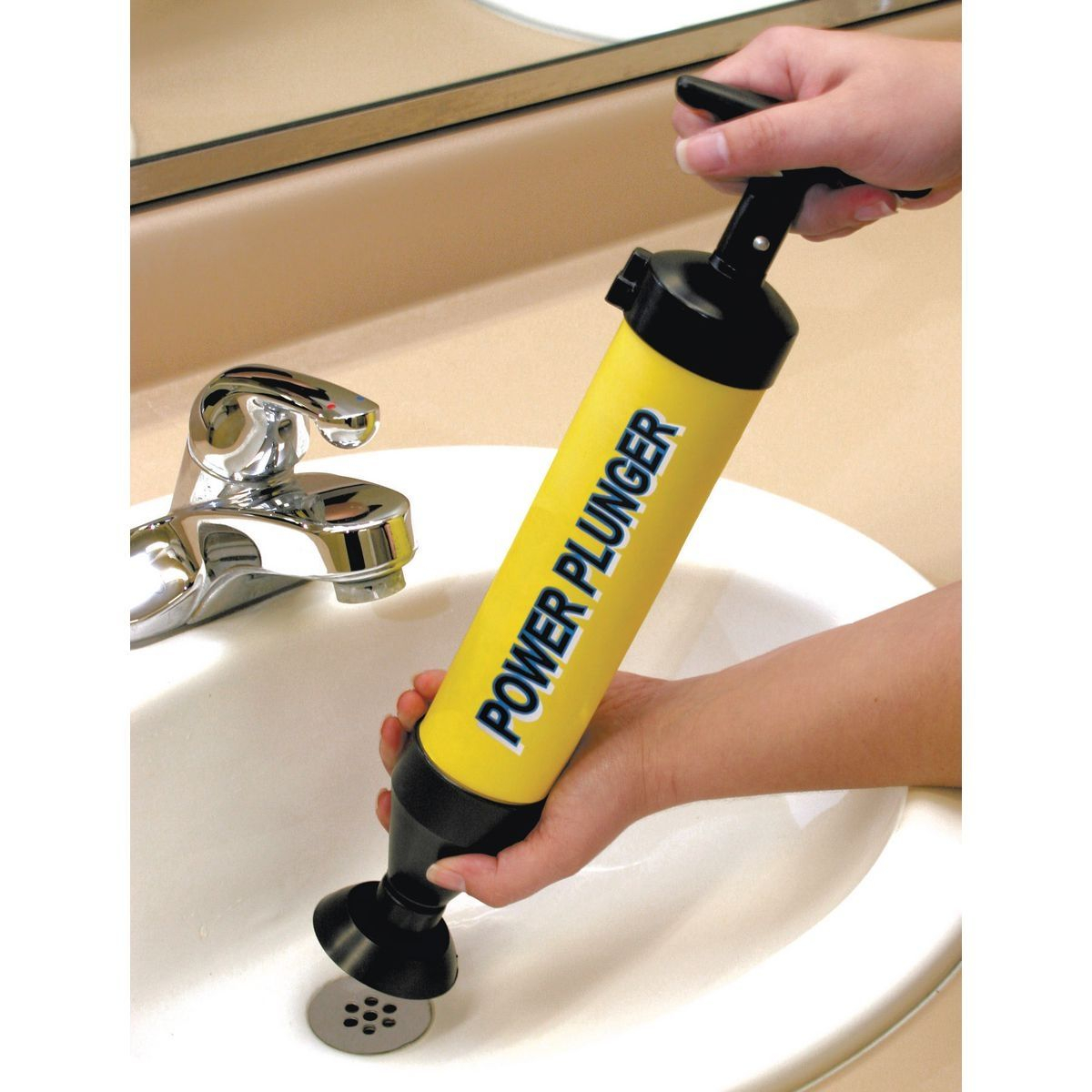

Anyone ever try one of those pump or pressure plungers? They have one in Harbor Freight for $9.99 and it got good reviews. Might be worth a shot for that price.

I stopped at Harbor Freight today and purchased one of those "As seen on TV" power plungers for $9.99.
I plugged the outlet from the dishwasher and started running hot water. It was not long before I had a bunch of water in the sink.
I pulled the plunger arm to get as much water into the device as I could. I hammered it with everything I had. I did this several times.
Soon the water ran freely down the drain and did not back up anymore.
I'd say it was a win for only a few bucks.
I want to thank all of you for your comments and options. It's what makes this forum such a great place to come for advice.
Dave
