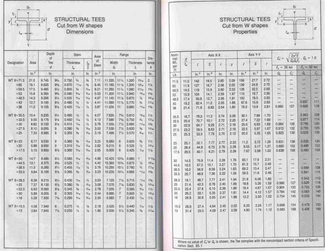

Another option on the same lines of thinking as Arc weld suggested. You could buy some structural tee. Skip weld it on the top and bottom. And still add a fish plate over the weld repair on the sides.
When I skip weld something like this, before painting I like to run a bead of caulking between the welds so water doesn't get under the metal and rust it out.

As for the T iron for reinforcement, i would go for some small channel iron. Creating additional box sections. That would put more metal farther away from the nutral axis.
