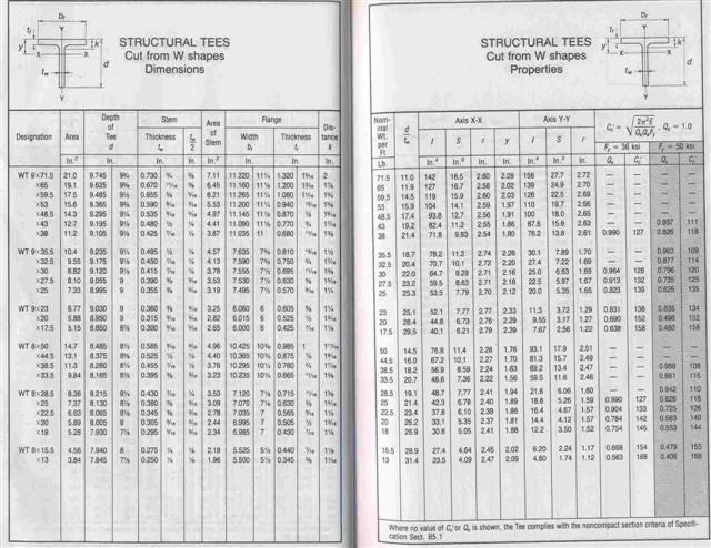

Another option on the same lines of thinking as Arc weld suggested. You could buy some structural tee. Skip weld it on the top and bottom. And still add a fish plate over the weld repair on the sides.
When I skip weld something like this, before painting I like to run a bead of caulking between the welds so water doesn't get under the metal and rust it out.

As for the T iron for reinforcement, i would go for some small channel iron. Creating additional box sections. That would put more metal farther away from the nutral axis.

Hey I know nothing about welding but why not just square up the break, weld it back together all the way around and then weld a flat plate to top and bottom sides? While a tee would work also, in theory one should not design a bending member without a stabilized edge or a return flange if subjected to compression stresses due to bending. In this case, the material thickness will likely prevent a crippling failure but in thin material this is an issue. Sorry for my two cents here, I come from aerospace structure background. :D
