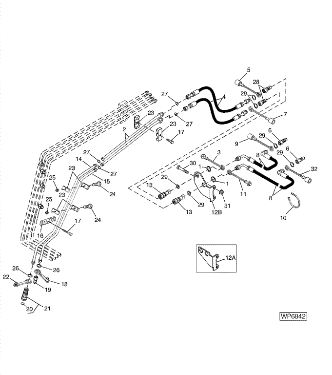

Maybe this picture from JDParts will help clear some confusion:
   / Pls advise on 4n1, road grading, tires, etc. #47
Assuming part 12B (the adapter support plate) is intended to be mounted near the FEL post, then it sure does look like all the parts are included and that you'd need nothing other than some zip ties to go from the rear remotes to the front of the FEL frame/grapple mount. $290 is a good deal for all that stuff.

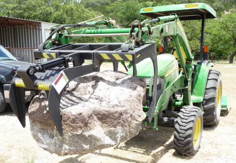

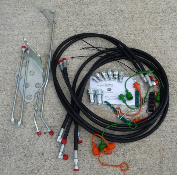

It's been a little while, but here are a couple pics of the Mollonzi LD48 grapple on my JD 4520 and the John Deere kit -- "Third Function Hydraulic Lines and Hoses" which is apparently has two codes:
9049: If you are adding as an option to a new loader/tractor
BW15630: If you are buying it to add onto your existing loader/tractor
The kit costs about $300. I installed it myself without much trouble. The kit's hardlines terminated with 1/4 inch FASTER brand QC's.... so I had to order adapters and one set of matching QC's to connect the grapple lines (1/2 inch male pipe thread) to the hard lines.
The grapple has been great for brush clearing and removing half-buried rocks such as the one depicted below. Thanks again for everyone's advice.
