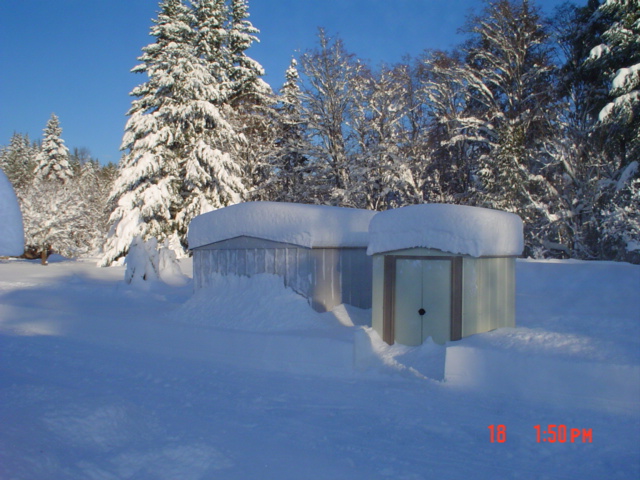

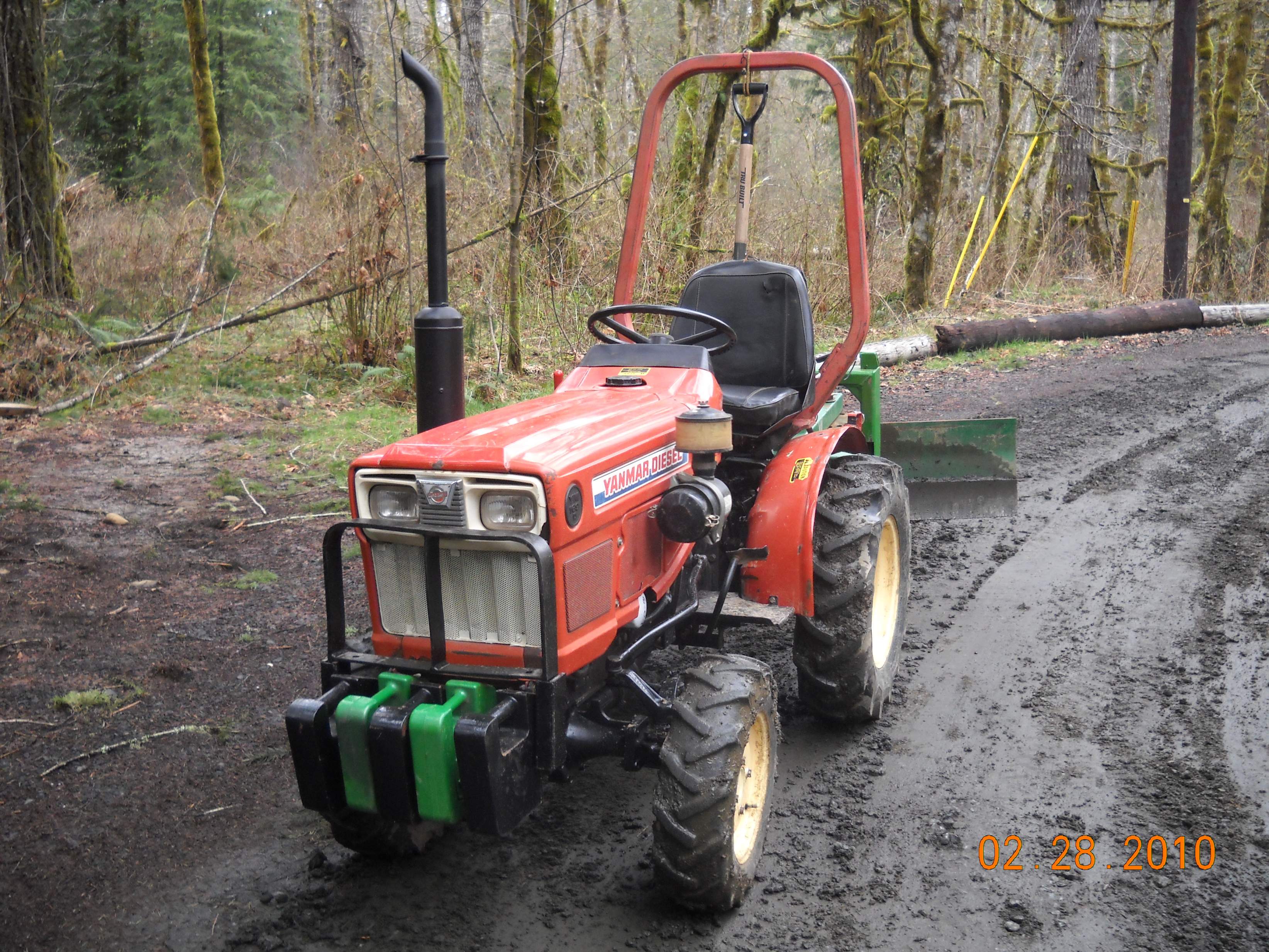

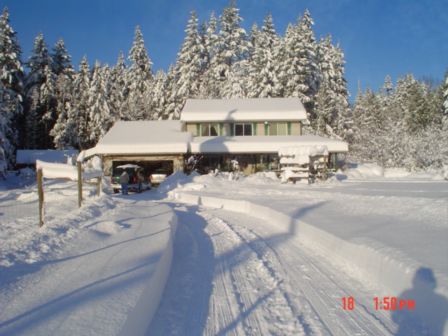

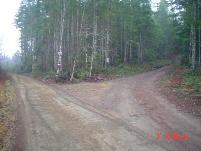

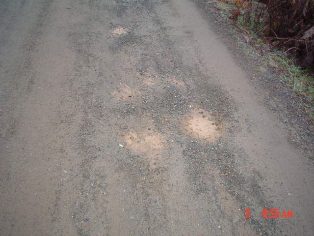

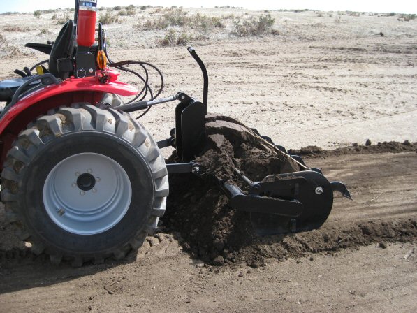

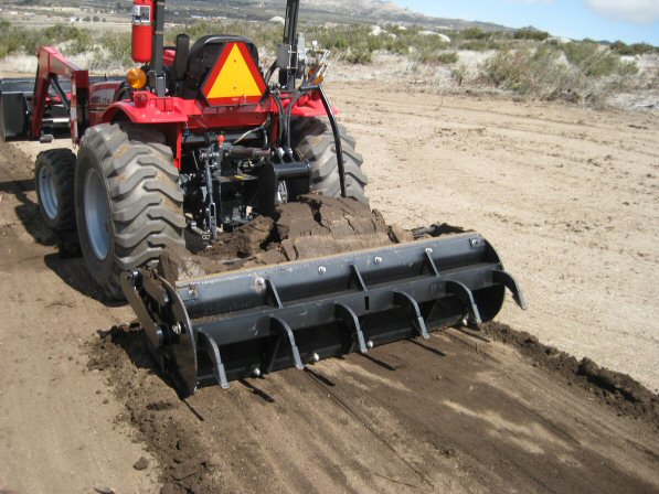

I use a 6 ft boxblade on my Kioti CK35 HST. :thumbsup: I have R4 tires on it and am very happy with them. Tractor works very well for grading, the only thing I have to watch is not to let the box get totally full of gravel, then I have to put it into 4 X 4. I have a couple of inclines on my almost セ mile private road that I do. Tractor and boxblade go up and down them fine. Last winter we had an almost record amount of snow, over 5 ft. Had no problem with the R4 tires when moving the snow with the FEL, I did have my backhoe on for extra weight. The tractor handled very well in the snow. Most of the time didn't even put it into 4 X 4.
