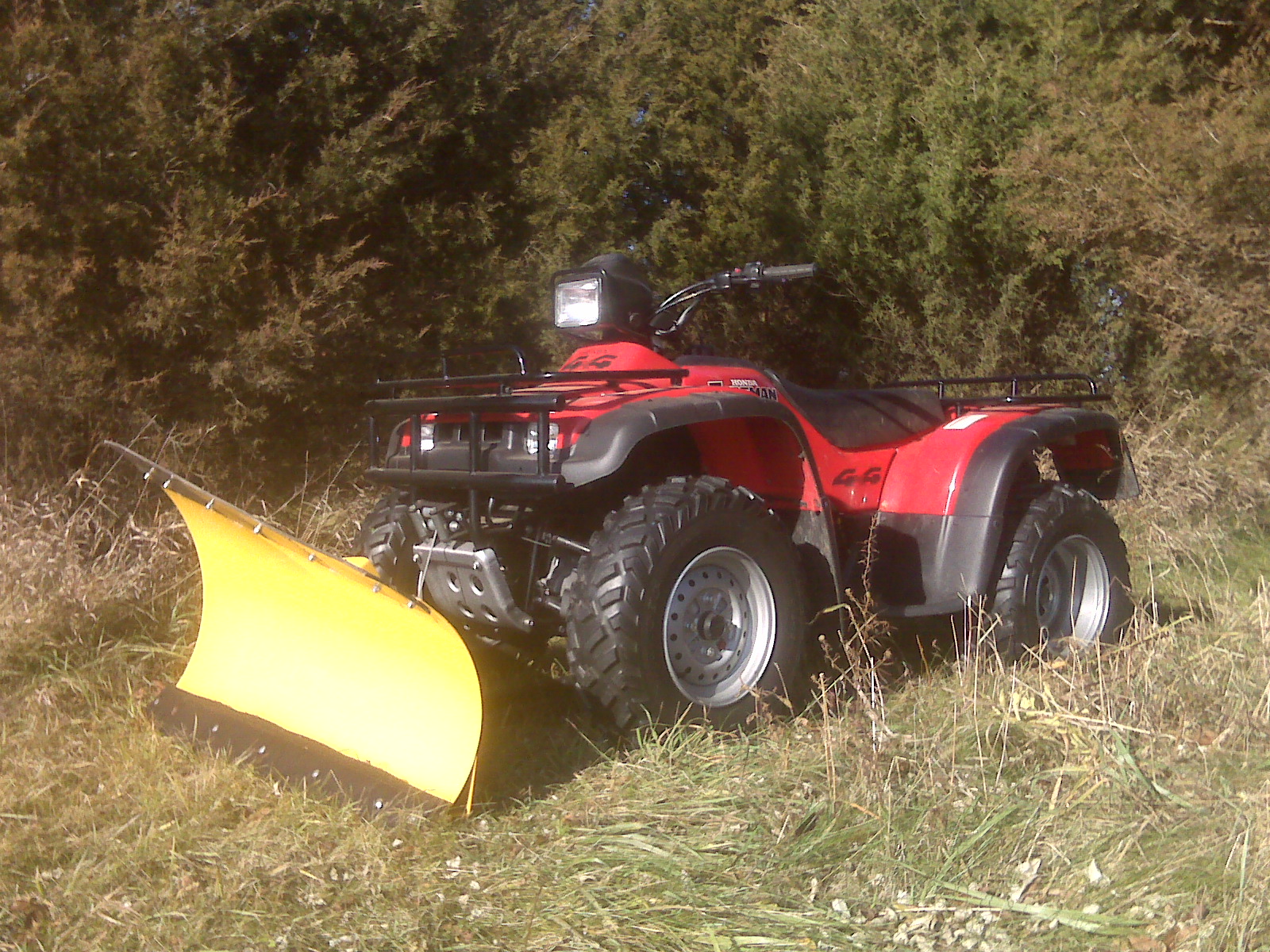

A few times I used my Foreman 450 to plow through deep snow at high speed, the problem with doing that is if the snow builds up enough to create enough resistance the rear end will slide out blindingly fast and possibly throw you off unless you are paying serious attention.
Attachment shows my 2001 Foreman 450...it has less than 130 miles on it...probably the lowest mileage Foreman 450 in the world!!!

Nice curved plow, JDgreen - what brand is it?

Moose brand County Plow...purchased from Dennis Kirk back in 2001....thanks for the compliment. The top rubber flap came with it but I added a cut off section of horse stall mat from TSC on the bottom.

Thanks, JD, will check it out. Do you find that the curve does a good job of throwing the snow away from the immediate side of your Quad? (The idea being to reduce the amount of build-up of the snowbanks on the edge of your plowing area.)

Yes..I really like the curve and the plow works great. Not sure if DK is still in business though. I would LOVE to have a rear blade for my Deere shaped like my Moose plow.

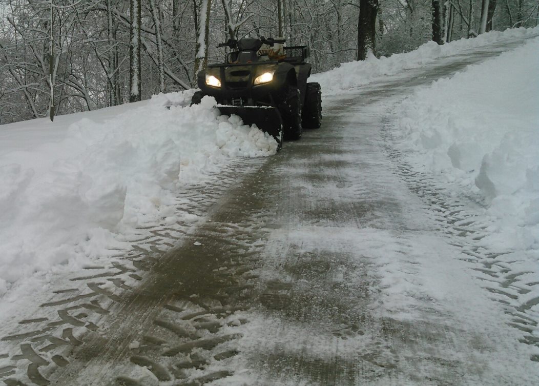

Mine is a Honda Rincon 680 with a 60" Warn setup. Our concrete driveway is 1500 up the side of a ridge and pretty steep and curvy. I would never try to run my tractor down that driveway on the snow. The ATV handles 5 - 6" fine. I take a run down the middle and up and down both sides. I keep the plow angled all the way over to the right but can change it for cleanup. If it's more snow, you can take smaller bites or skim the top. I wore out the plastic wear bar in two seasons but my neighbor bought a stall mat and let me cut a slice off to finish up on the last episode.

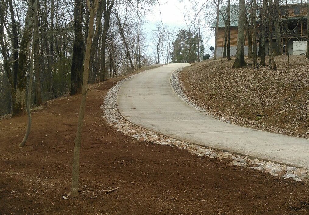

Here is the driveway before snow. It is scribed with grooves across it but it still needs plowed when it snowed. We got a light dusting a few weeks ago and I blew it off with the rider mower. It was 6 degrees so there was no slush.
