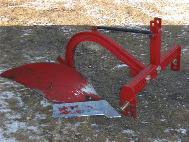

/ Plowing with a GC2300 #8
Made a 3pth plow out of a old single horse/ox plough for the GC 2300 it works good.The pic shows it working in a old un worked garden and it worked pretty good.

/ Plowing with a GC2300 #11
I have an old David Bradley plow that I purchased off E-bay. I modified it to fit my GC2400. It's an 8 or 9 inch IIRC. Worked well for what it is.

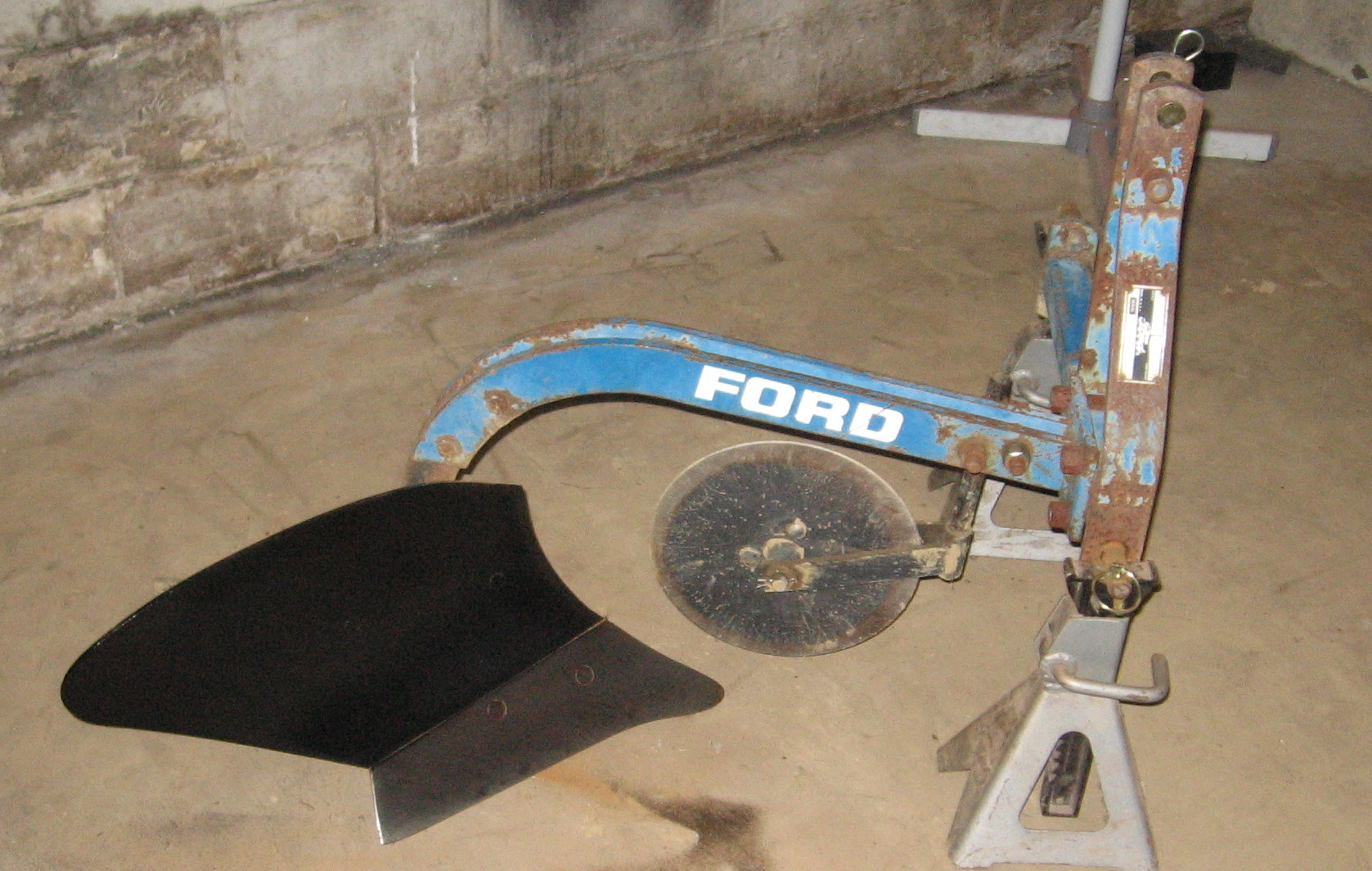

#14
Found a used plow. It is a Brinley PP-1200 ..... single bottom 12 inch for compact tractors w/Cat 1 hitch. It has a FORD id tag and is painted the factory blue - Ford Model 100. Apparenty Ford had Brinley make them for their smaller tractors. I'll get a pic soon.

#17
Pic of my Ford/Brinly - 3 pt. sub compact plow.
Today we had snow .... April 23rd - wrong kind of plow.
#19
My neighbor used it last week. He has an older Kubota 4x4 sub compact with a 2 cyl deisel. Once he got the proper adjustments on his three point hitch figured out - it worked good.
